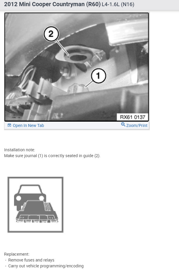

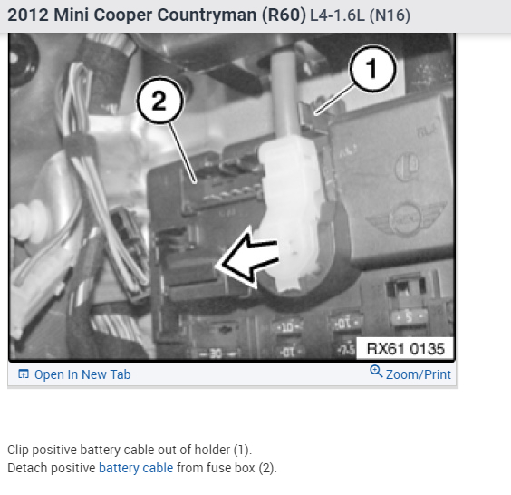

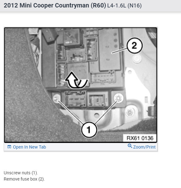

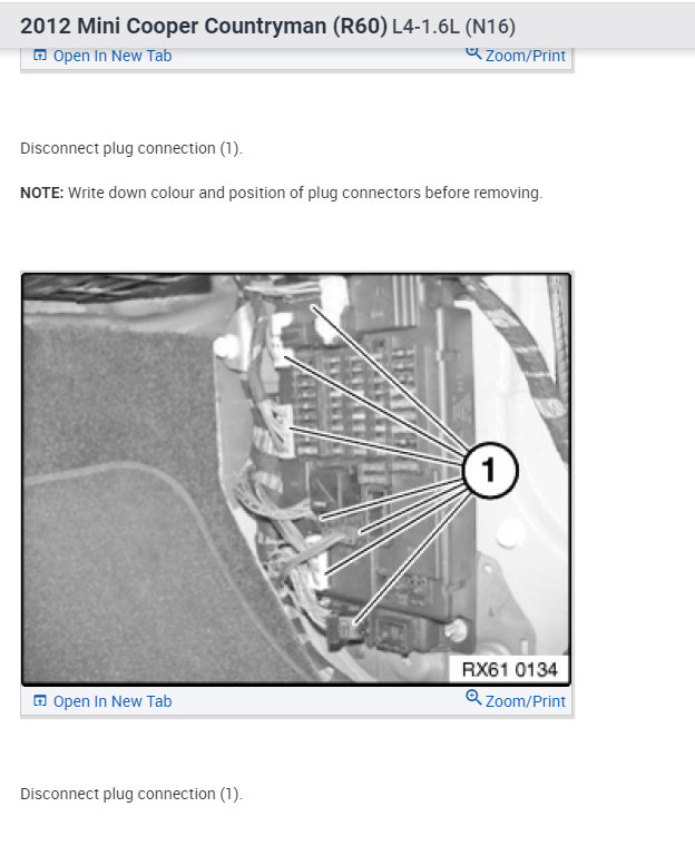

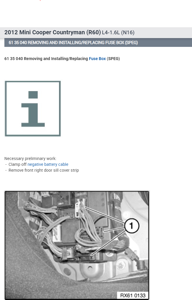

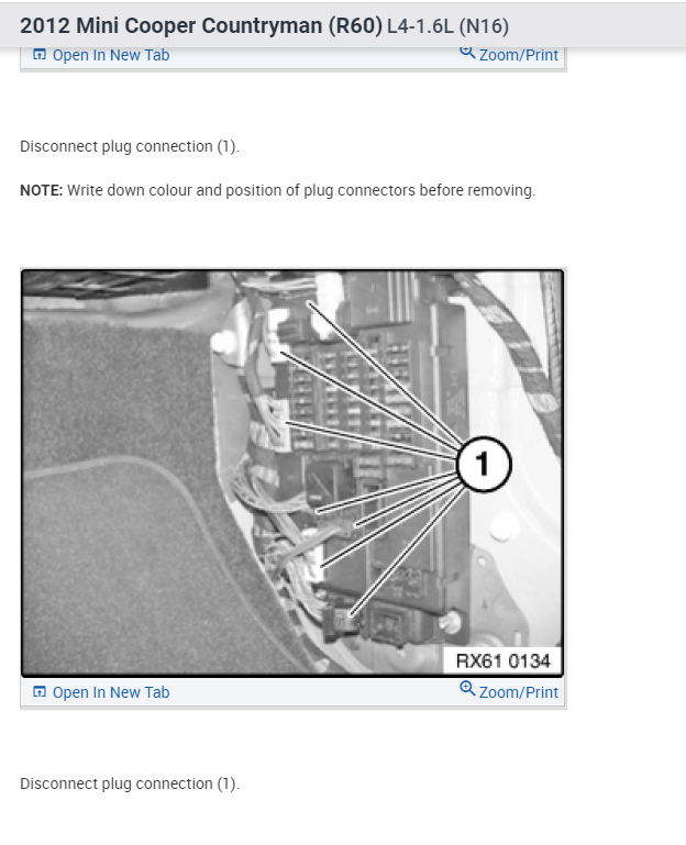

Replacing the fuse is fairly straight forward.
However, this will need programming after replacement.
Unfortunately, Alldata does not provide programming info or steps.
I have attached the replacement instructions below.
