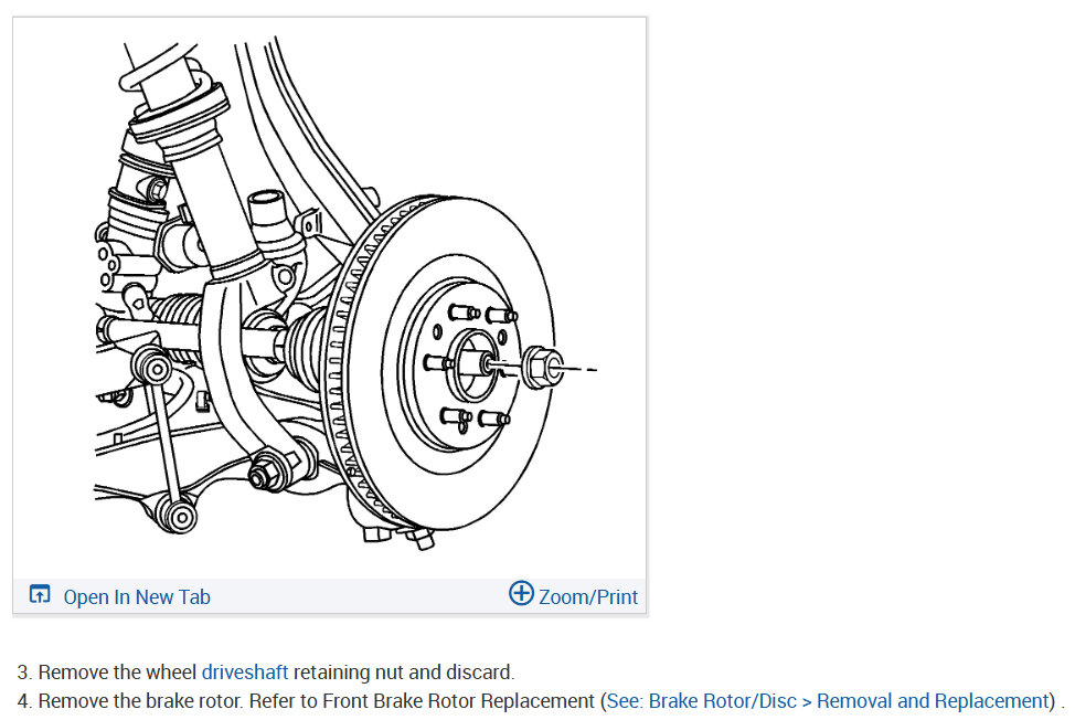

please send information with tightening foot lbs specs for new wheel bearing hub.
Feb 17, 2025 at 2:26 AM
Experienced Mechanic
55,649 POSTS

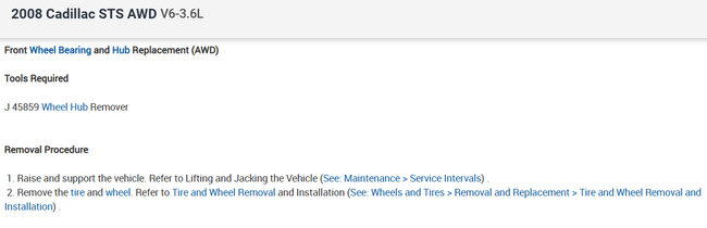

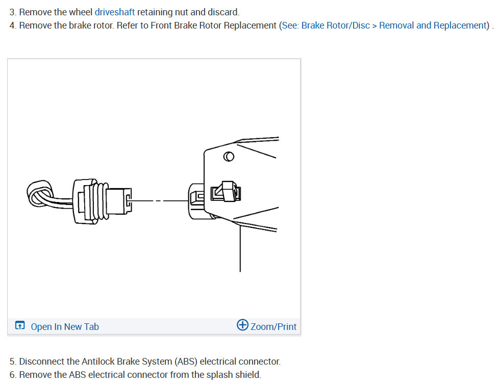

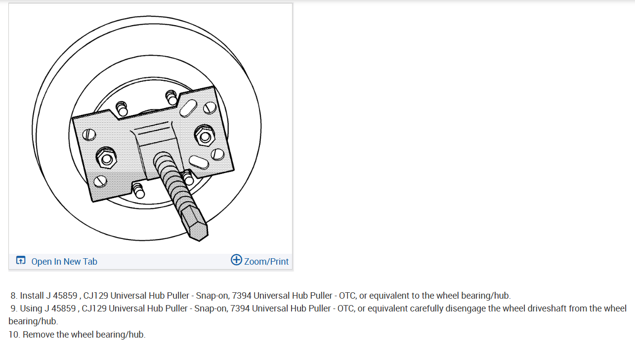

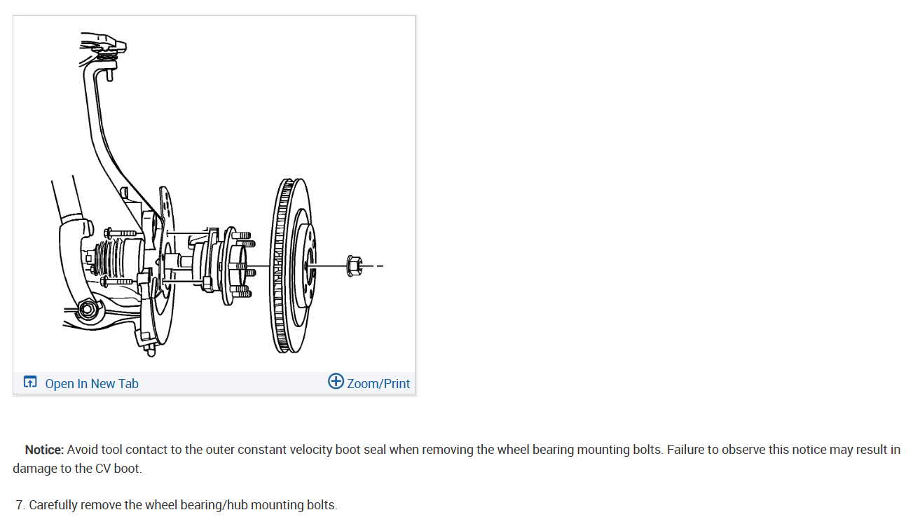

Sure, here is how to change out the front bearing hubs with torque specs as requested.
Tighten the wheel bearing/hub mounting bolts to 135 N.m (100 lb ft).
Install a new wheel driveshaft retaining nut Tighten the nut to 160 N.m (118 lb ft).
Check out the images (below). Let us know if you need anything else.
