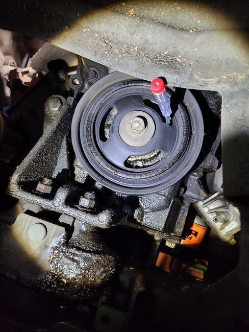

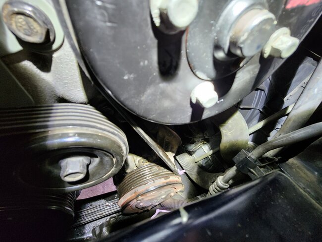

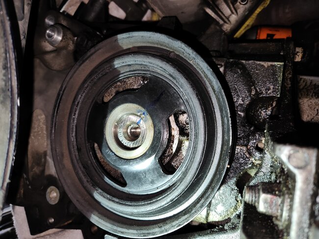

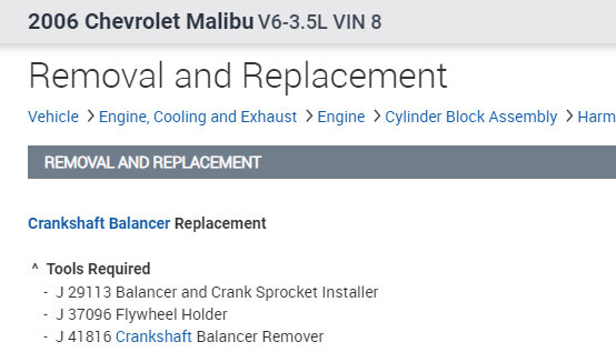

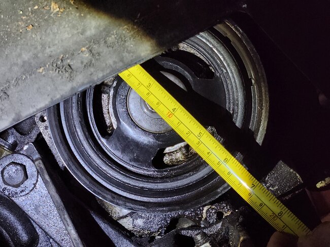

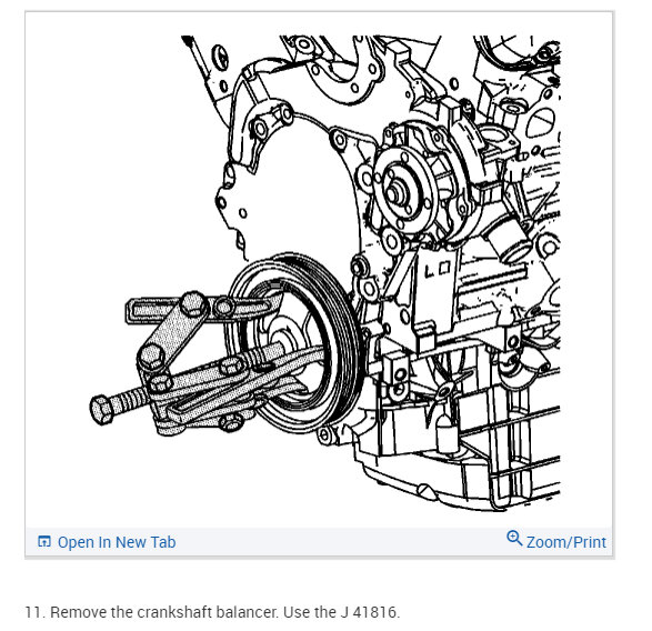

I'm attempting to replace the gaskets on the engine. I've done the head gasket and decided to do the front cover as well as I think I see leaks. I am having a hard time removing harmonic balancer. I did not drop the engine and tried using a gear puller to remove it. It won't budge. Wd40 applied and tried gently hammering on sides. It's difficult to tell whether I'm just not doing it right or it's not the right thing to do at all. From reading on the internet, it should come off fairly easily, so I feel that because there's not enough clearance for a gear puller to be dead center it's not applying pressure evenly.
I think that I need to take it off to replace the cover because there are a couple of small bolts I can see behind the pulley. I took all the other bolts I could find and the cover is moving very slightly.

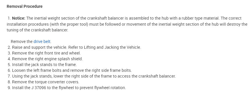

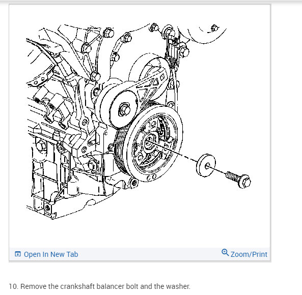

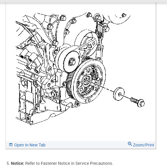

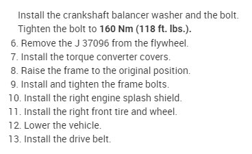

You are exactly correct. If you are not centered, it causes the pulley to come off at an angle. In this case, it prevents it from moving.
I attached the directions below specific to this vehicle. Take a look at them and let me know if they help or if you have other questions.

I don't have to hoist the engine while lowering the frame?
Feb 19, 2023 at 4:57 PM
  • 110,248 POSTS
According to the manual, you shouldn't have to lower the engine. It is important that you keep the puller centered. Once you have pressure on the puller, don't be afraid to tap the puller where you have the socket to remove it. When it is under pressure, a lot of times, tapping it with a light hammer will jar it loose.

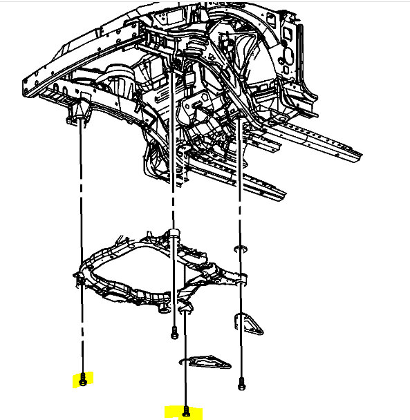

Joe, would you be able point me to any schematics or links that show or talk more about lowering the frame as described up to step 7 of removal procedure?
Feb 25, 2023 at 12:17 PM
  • 110,248 POSTS

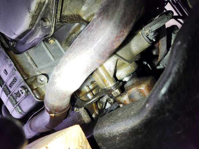

You should be able to loosen the bolts of the subframe (right side) enough to gain access. Try this. Place a floor jack under the right side of the subframe. Loosen the bolts on the left but don't remove them. Only take them out a couple of turns.
Loosen the right side. Remember, we are using the floor jack to hold the frame stationery on the right. Loosen the bolts until they are nearly out but still threaded and slowly lower the jack to see if it gives the clearance you need.
See pic below.

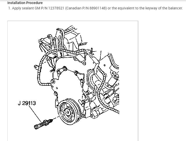

Do you know if there's anything that needs to be applied to bolt threads on the front cover? It looked like some of them had white hardened residue... Is it high temperature seal or water jacket seal?

I know the keyway on the harmonic balancer needs a sealant. However, I don't believe the cover does. On the other hand, if you have it for the keyway, it won't hurt to use it on the cover bolts.

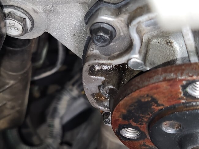

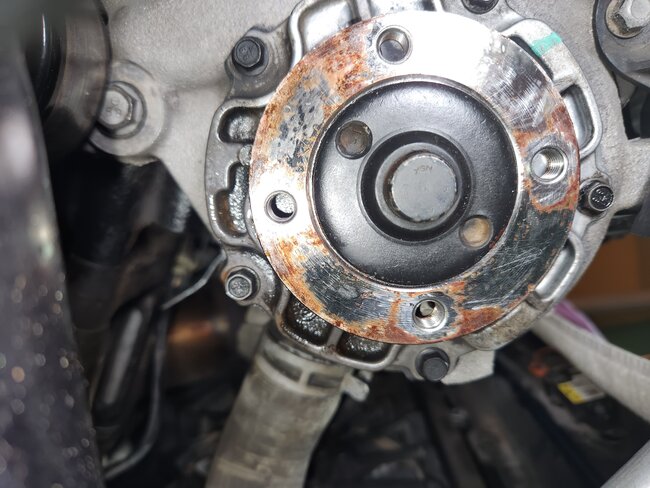

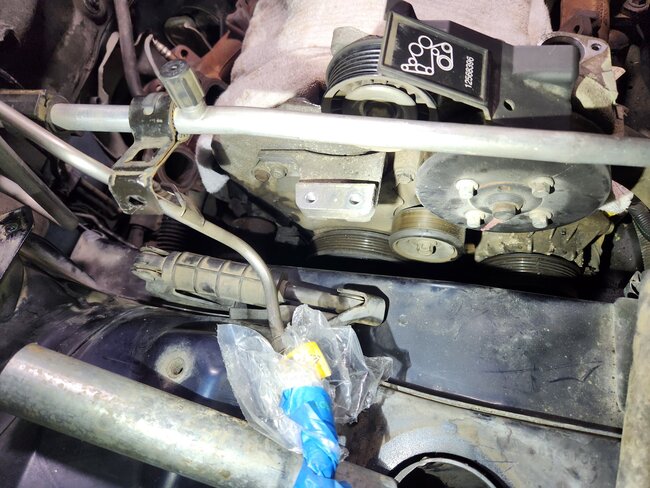

Today I put everything together and filled coolant. It leaked from the water pump and potentially somewhere else. After looking into the water pump, I'll try again and see if there's a leak from one of the bolts. Doesn't seem like the cover gasket is the problem.
Apr 9, 2023 at 12:38 PM
  • 110,248 POSTS

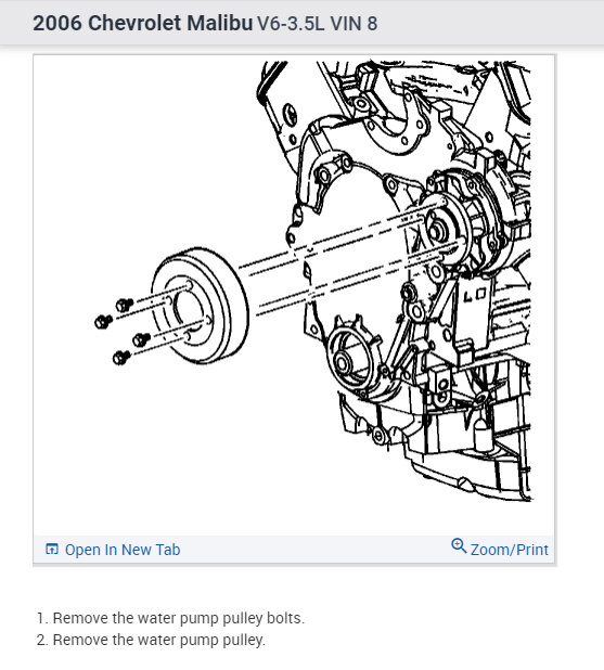

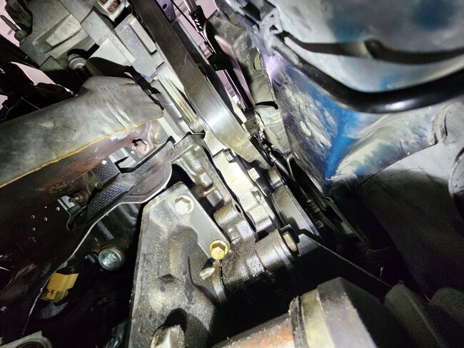

That isn't good. In your first pic, it appears that coolant may be coming from behind the water pump pulley. Are you sure it isn't leaking from the weep hole on the pump?
Take a look at this link:
https://www.2carpros.com/articles/symptoms-of-a-bad-water-pump
Apr 10, 2023 at 1:04 PM

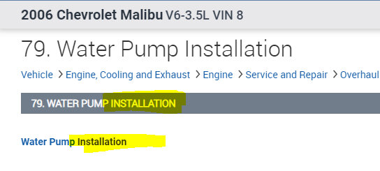

  • 110,248 POSTS

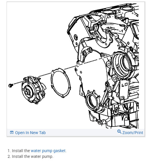

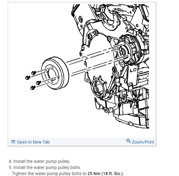

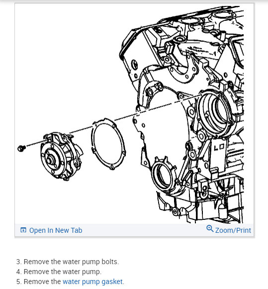

Are you able to locate the weep hole on the pump as seen in the above link? Also, I don't know if you need them, but I attached the very basic directions from my manual for replacing the pump.
If you have a chance, could you let me know how things turn out for you? I'm interested in knowing if this takes care of the issue.

I replaced the water pump. I think that solved that leak, but there might be some loose houses still somewhere as I see some coolant drops in the subframe and exhaust pipe on passenger side. I used Teflon tape on hose fittings where I saw leaks, but I'm not sure if that's the way to go.
Another problem is the engine shakes when I accelerate and there are occasional pops, smell of fuel. Kind of sounds like hissing noise near throttle body, and I can feel air with my hand in that area. Need to figure out how to make all the fittings air/fluid tight. I didn't put anything on hoses and plastic pipes when I put it back together.
