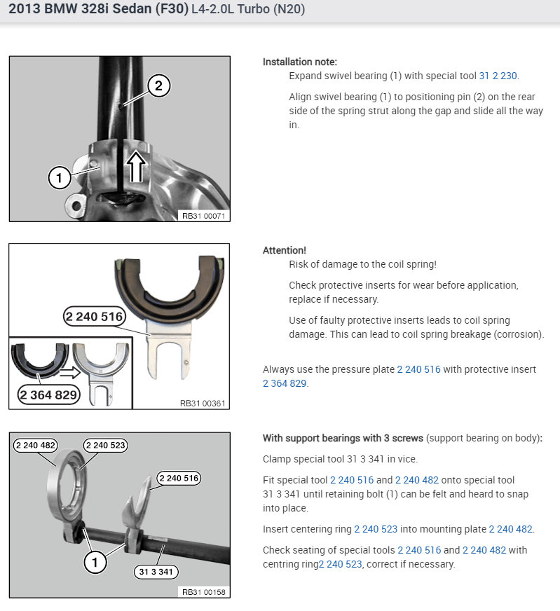

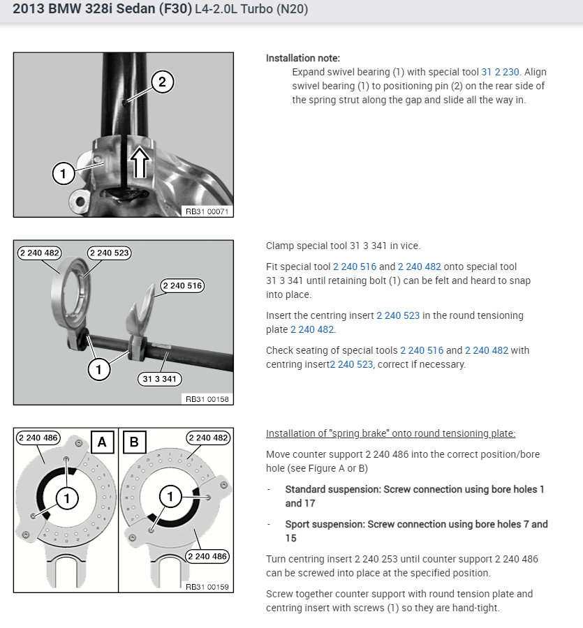

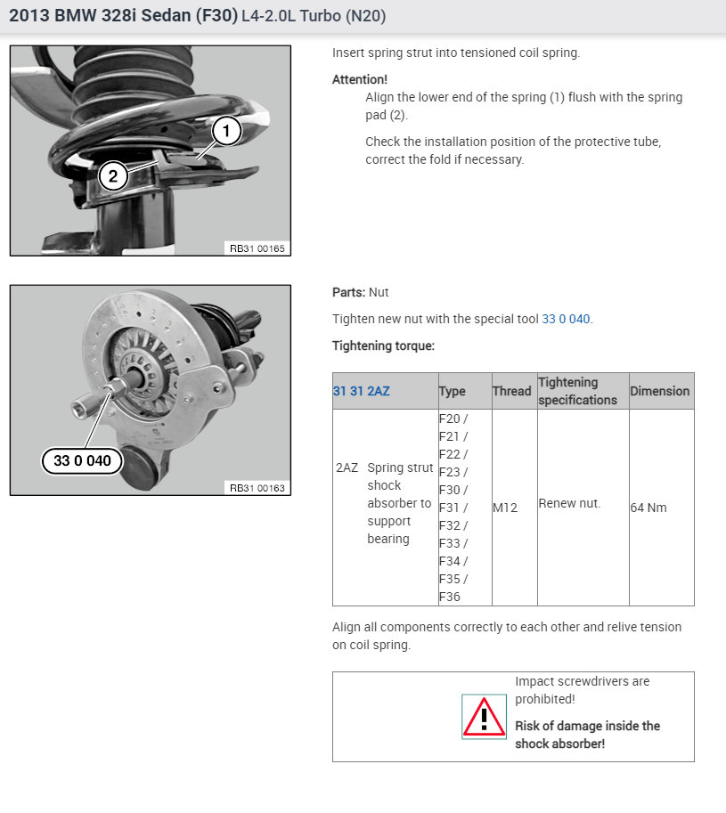

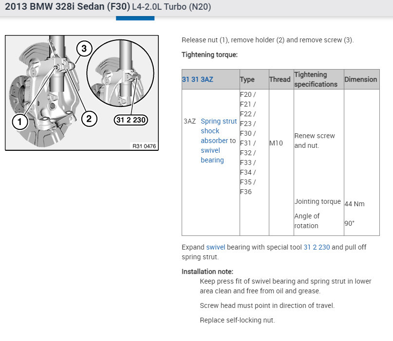

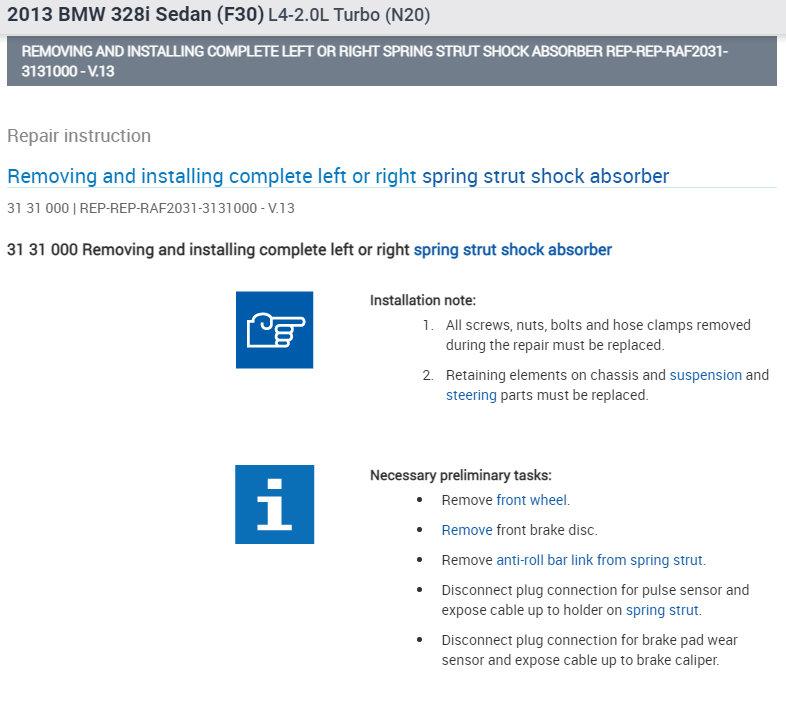

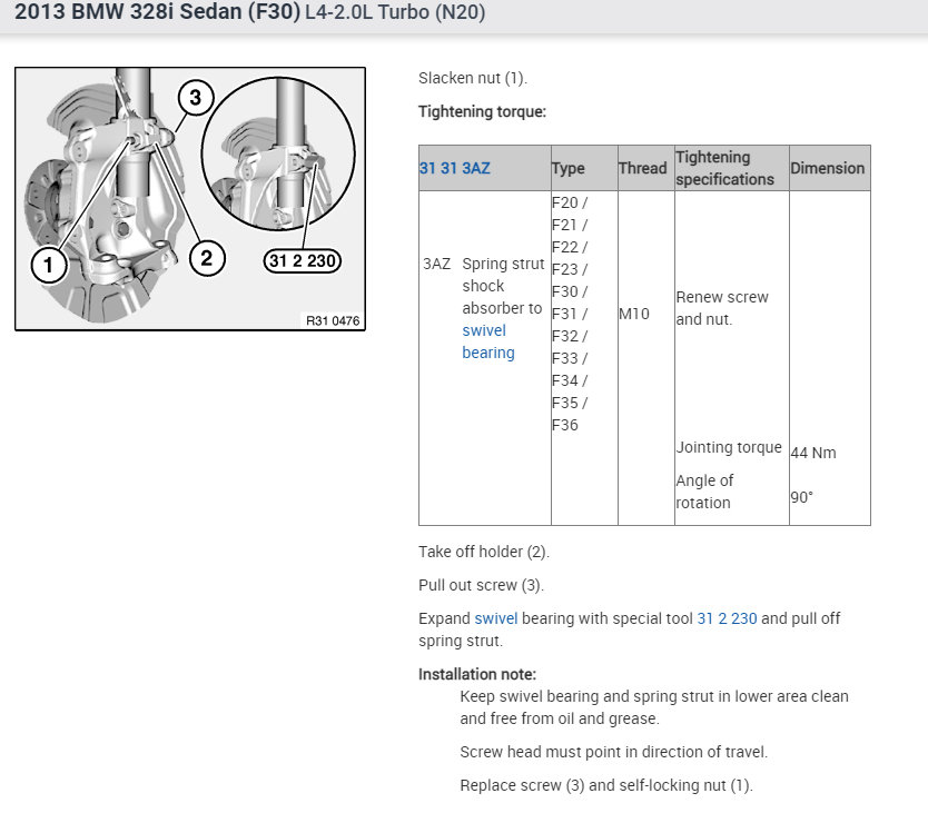

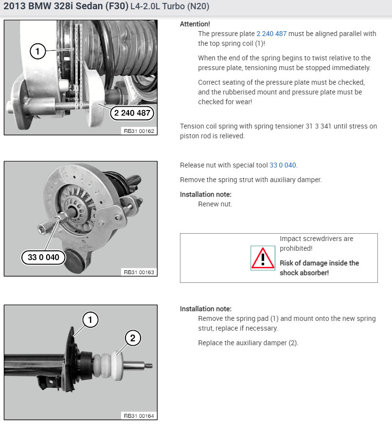

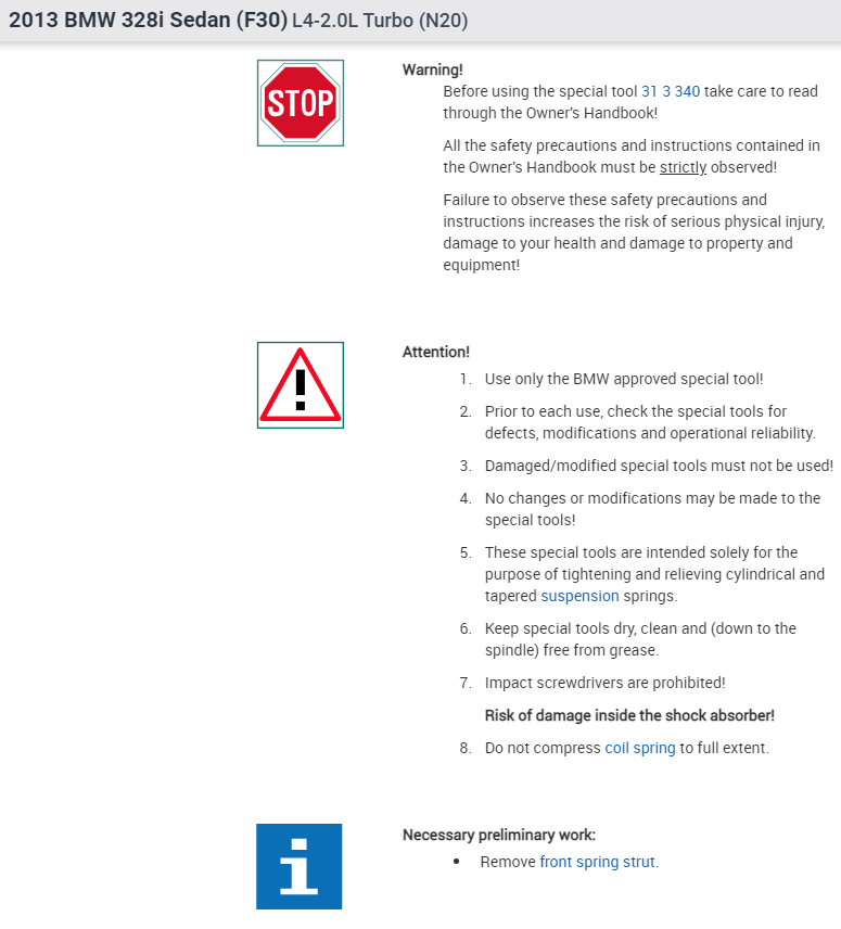

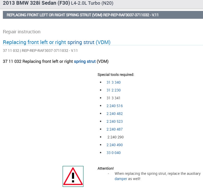

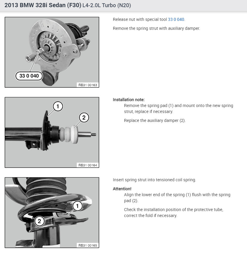

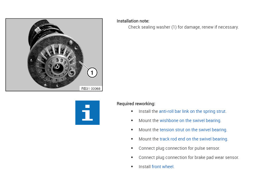

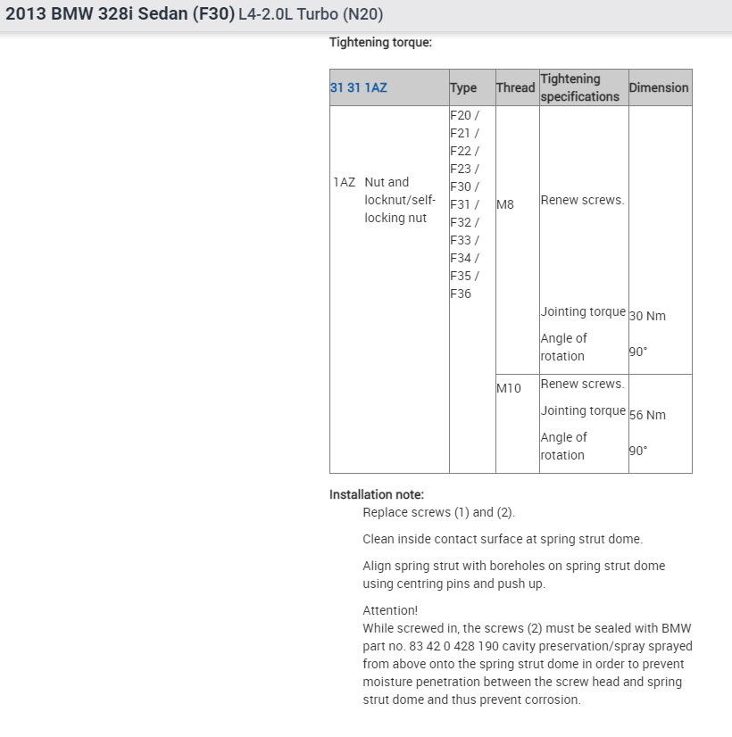

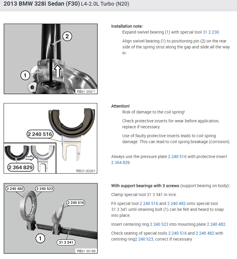

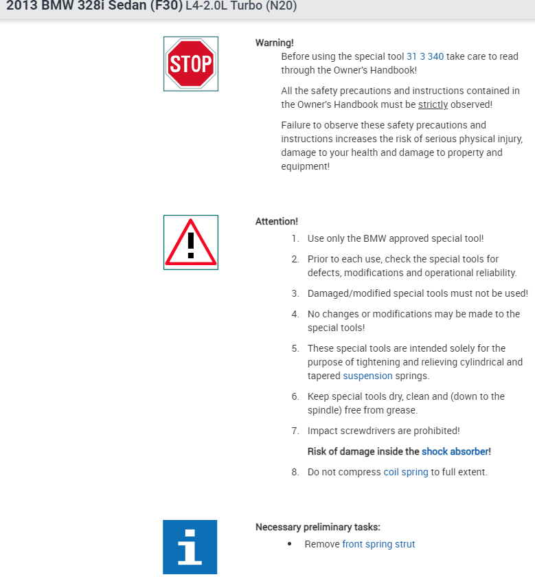

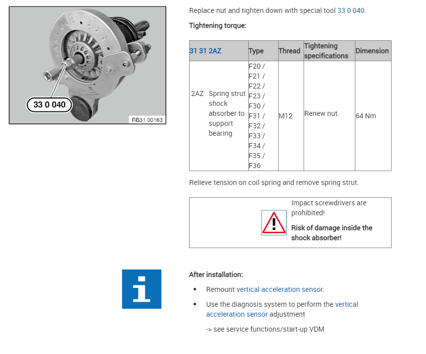

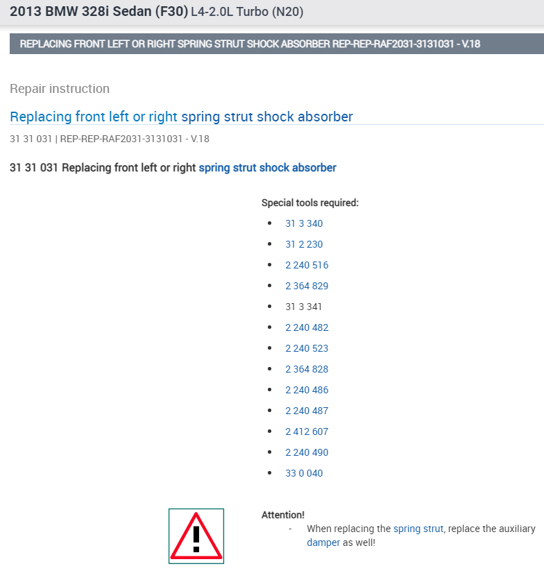

Having a hard time finding information. This is a sedan 2wd and a 4 cylinder. Others are different such as coupes and convertibles, even parts are not the same. I am trying to remove front right.
Oct 25, 2021 at 8:04 AM
SQM
  • 6,383 POSTS

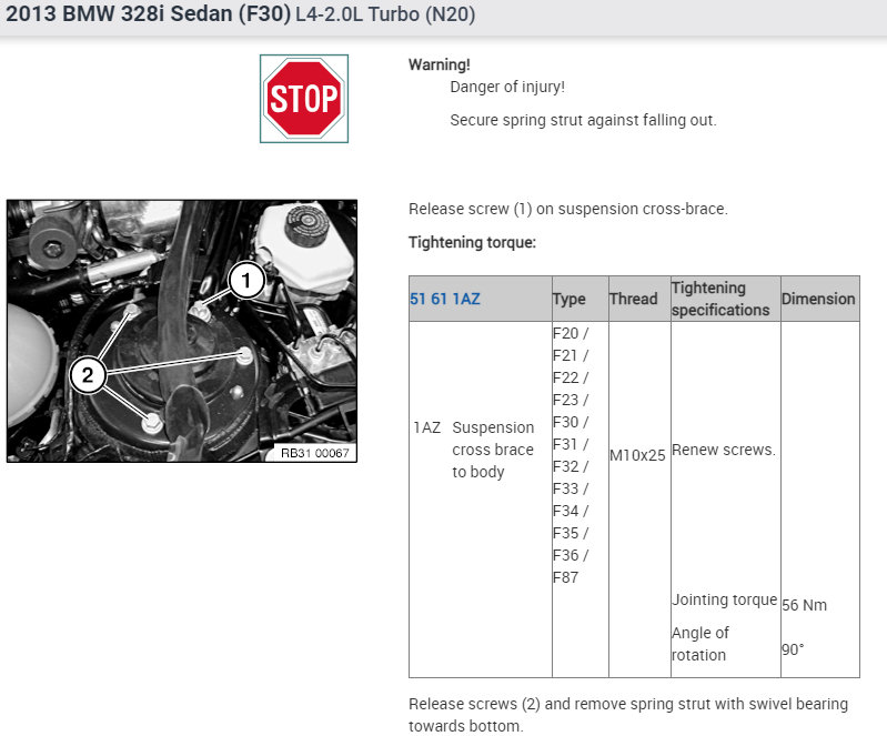

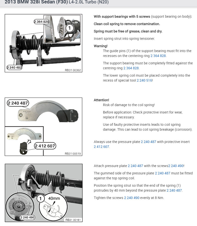

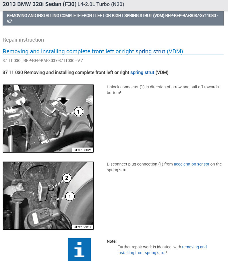

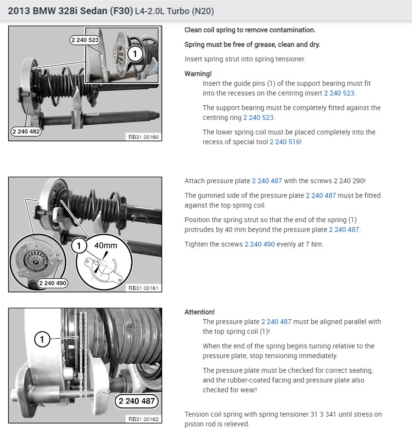

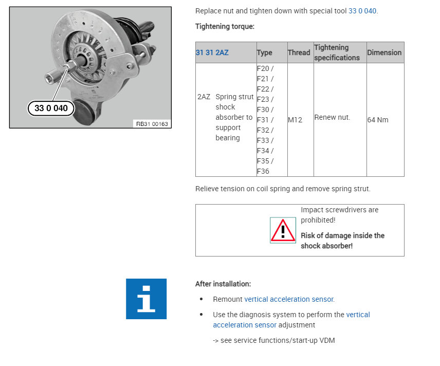

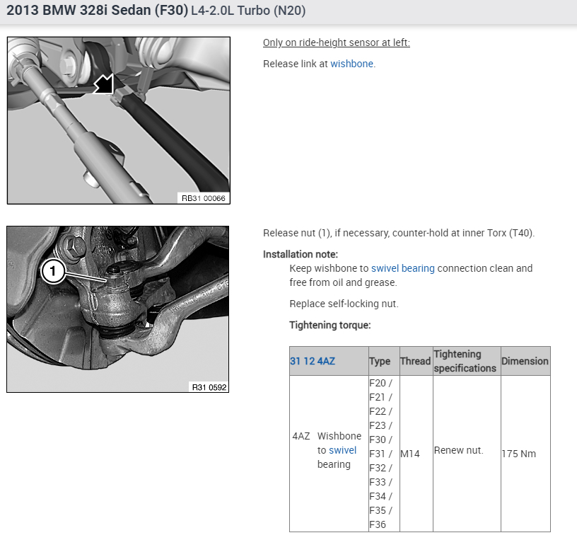

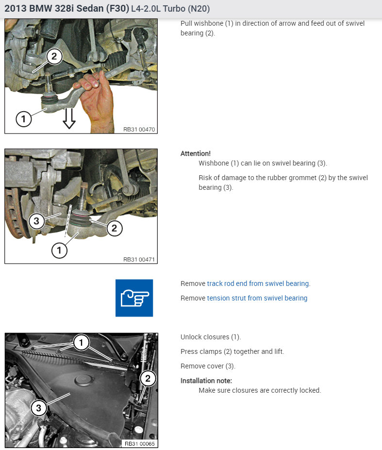

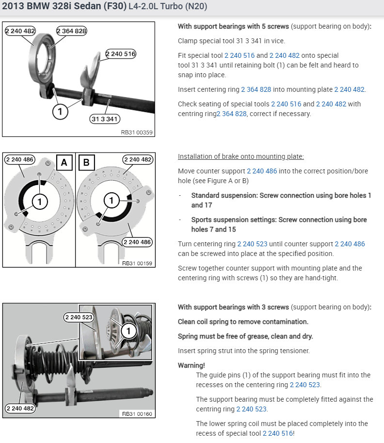

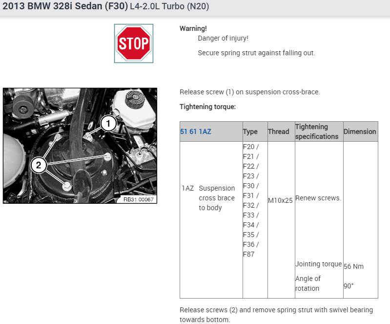

I have attached the instructions below.
Even on Alldata the information is confusing. There are 2 different styles for this 4 door.
Let me know if you need any other information.
https://www.2carpros.com/articles/how-to-replace-a-suspension-strut-and-spring
