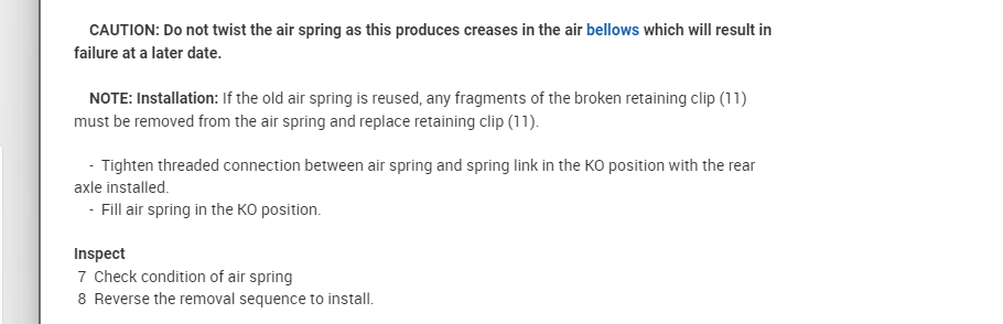

This is an 07 Benz E550 but I did not see an option for the 550. It's 4matic. I need to replace the front air strut as it is very bouncy. Driver side.
Feb 26, 2022 at 9:32 AM

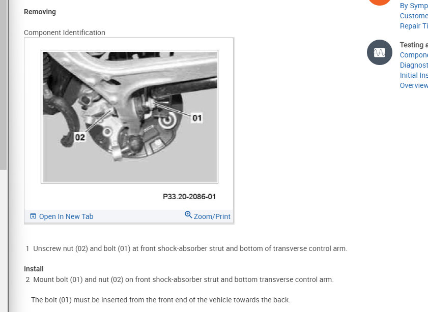

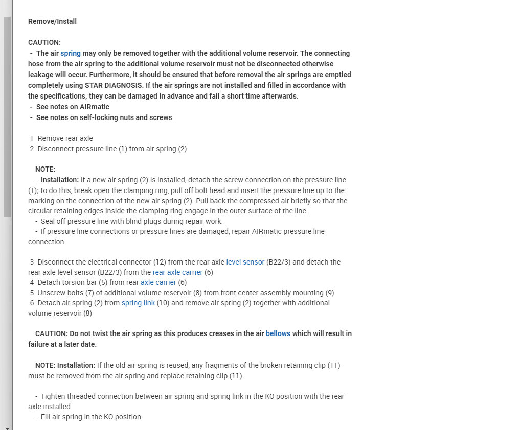

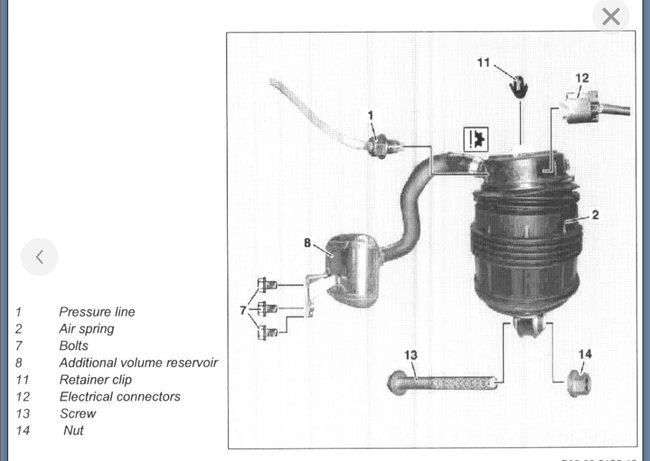

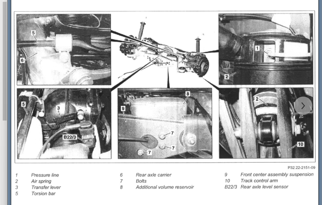

When you say the air strut, I assume you are not talking about the spring because that would not cause a bouncy feeling.
So, I am attaching the info on both the spring and strut just to ensure I give you what is in the manual.
However, here is a video that is on a similar vehicle that will help with this:
https://youtu.be/tXnyEEFlFnA
Please see the attached info and let us know how you make out with this.
