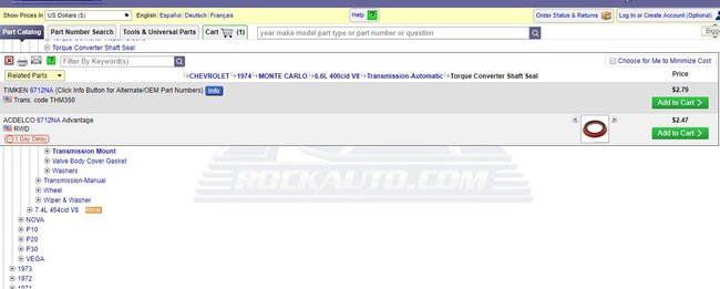

I have no problem. I just would like to know what oil seal you would recommend?
Tuesday, August 20th, 2019 AT 9:51 AM (Merged)
  • 52,797 POSTS
Good evening.
Either Timken or AC Delco. They are both good seals.
BROOKS BONNIWELL
Thank you very much. I will use your advice!
