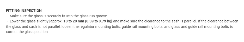

Driver's front glass broke how do i go aboit replacing it?
Mar 9, 2020 at 6:48 AM

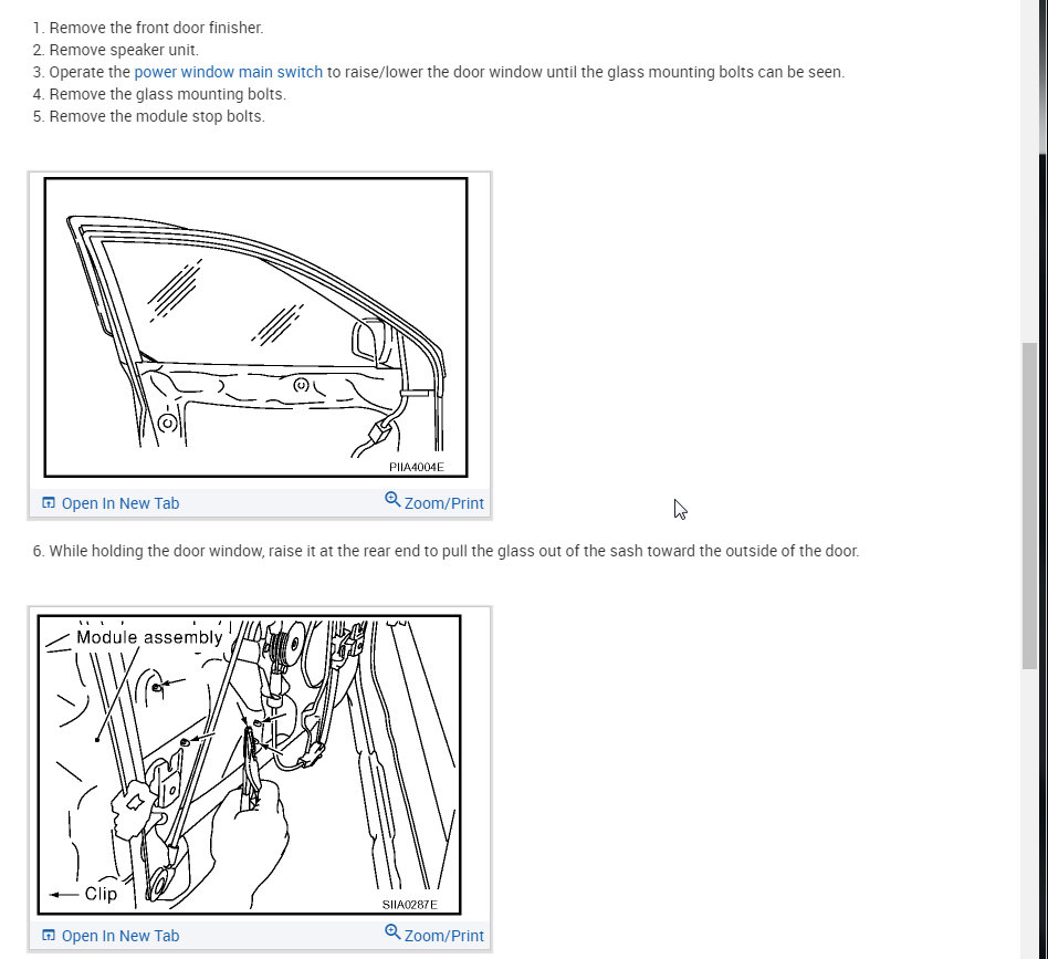

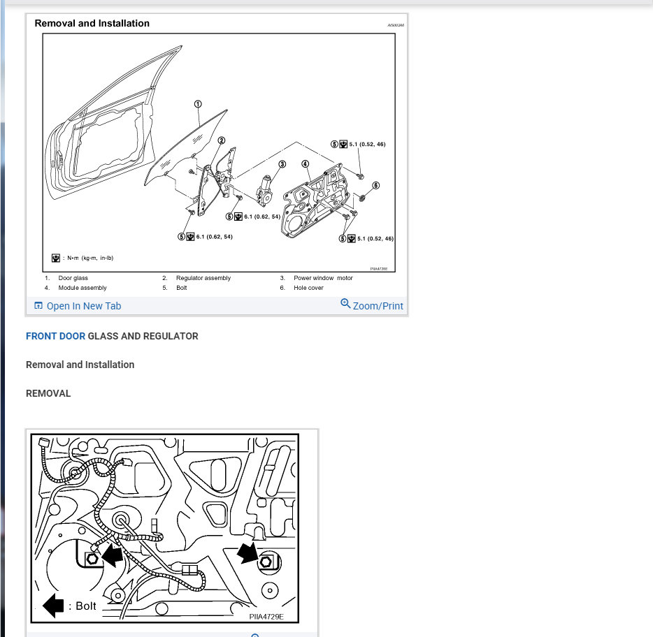

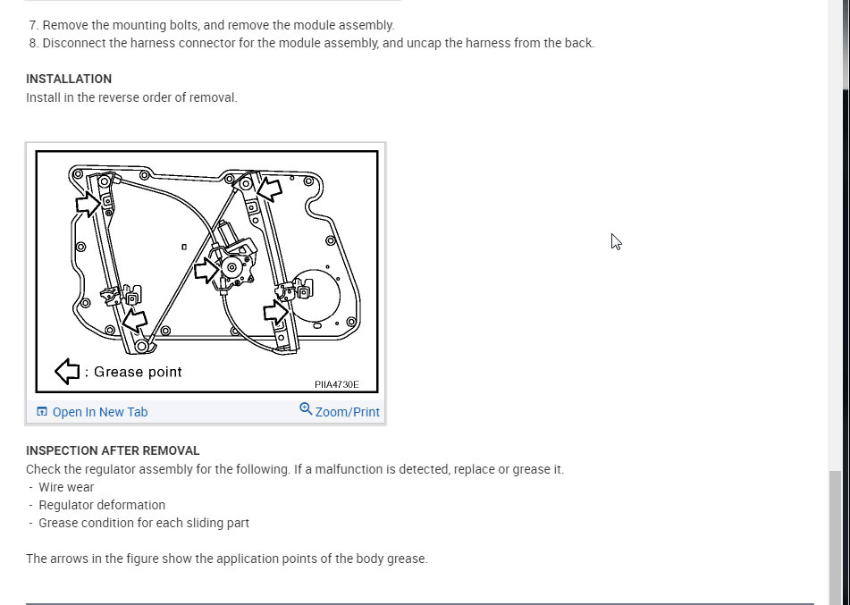

Here is the process for replacing the glass on the front door. Let me know if you need more info. I included the inspection measurements as well. Check out the diagrams (Below). Please let us know if you need anything else to get the problem fixed.
