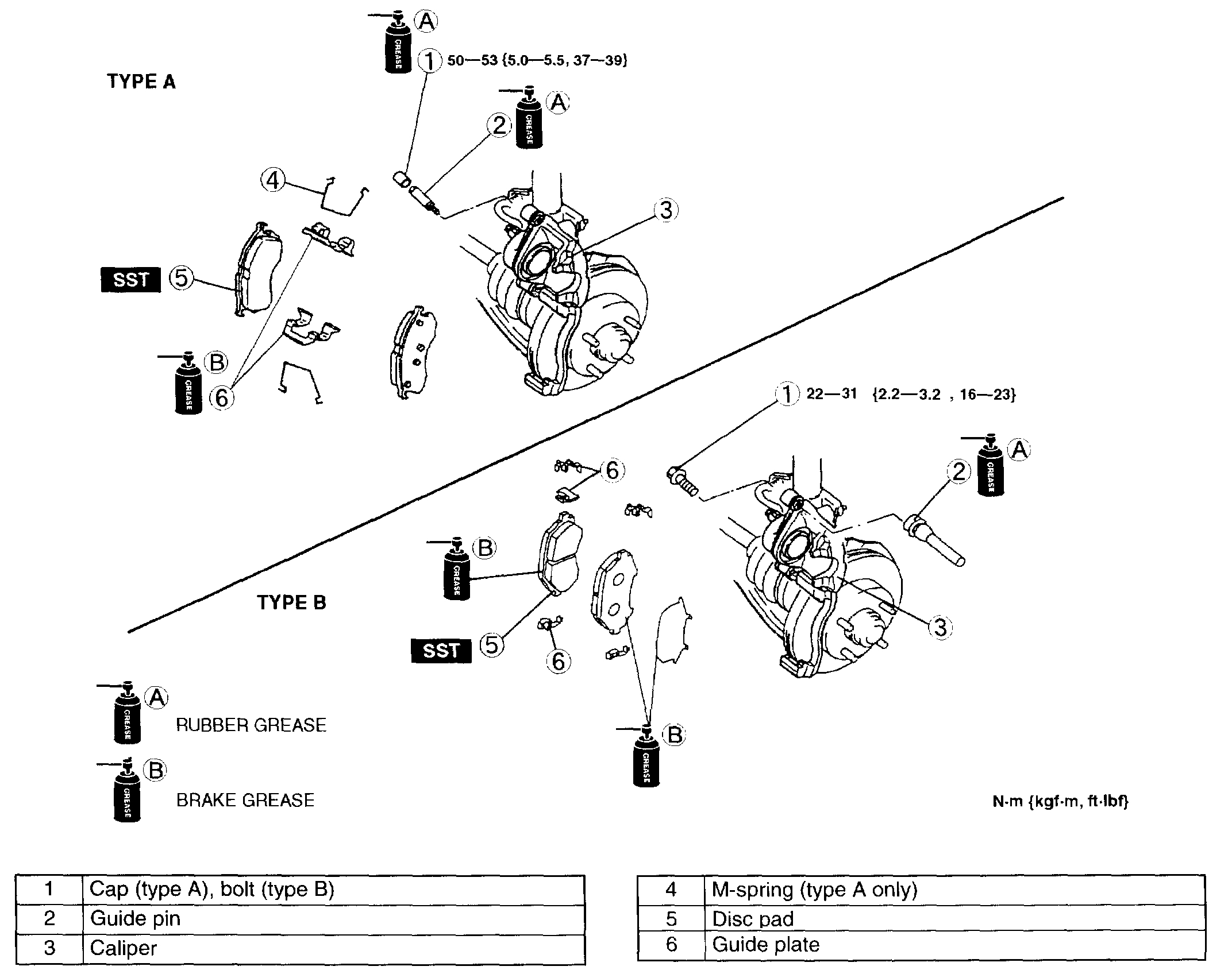

How do you replace the front brake pads on the car listed above DX model?

The directions I provide will be for brake pad and rotor replacement. If the rotors are good, just ignore that portion of the directions.
First, here is a link that shows in general how it is done. I like adding this link as a reference for people to follow.
Here are the directions from the manual. Basically, the directions are in pic 1. This is the reason I like adding the link above.
__________________________________________________
2003 Mazda Protege L4-2.0L DOHC
Front
Vehicle Brakes and Traction Control Disc Brake System Brake Pad Service and Repair Procedures Front
FRONT
DISC PAD (FRONT) REPLACEMENT
pic 1
1. Remove in the order indicated in the table.
2. Install in the reverse order of removal.
