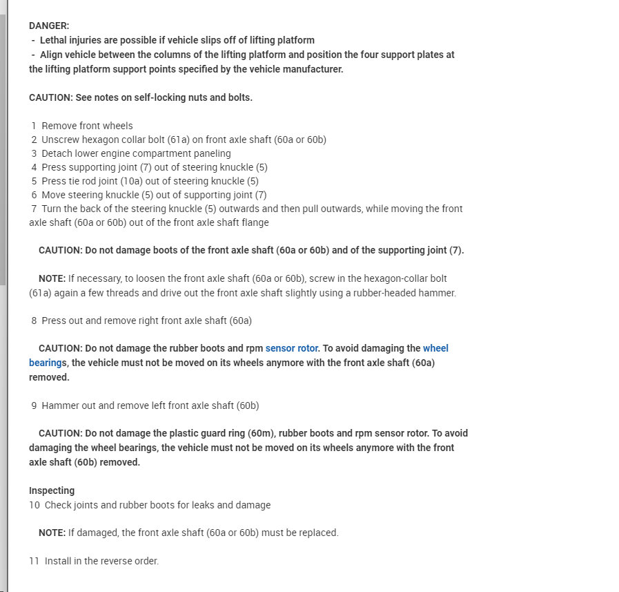

Need to replace the front left axle on this vehicle listed above E550 not E500.
Feb 26, 2022 at 5:33 PM

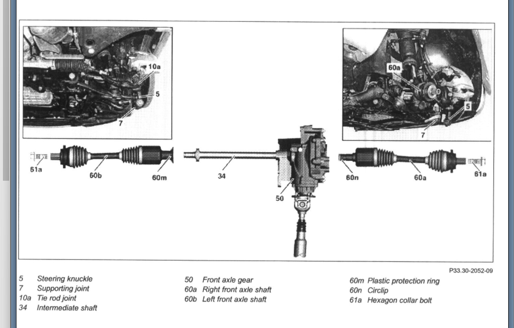

No problem. Please see the attached info from the manual. It is not incredibly detailed, but this is typical for MB.
However, here is a general guide that will help with this as it will have good info:
https://www.2carpros.com/articles/replace-cv-axle

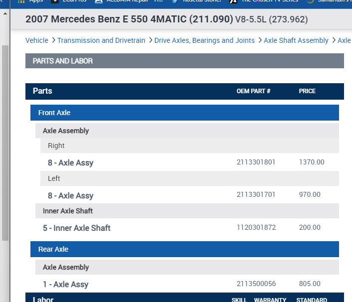

Please see the attached info including the part numbers in case you need this as well.
