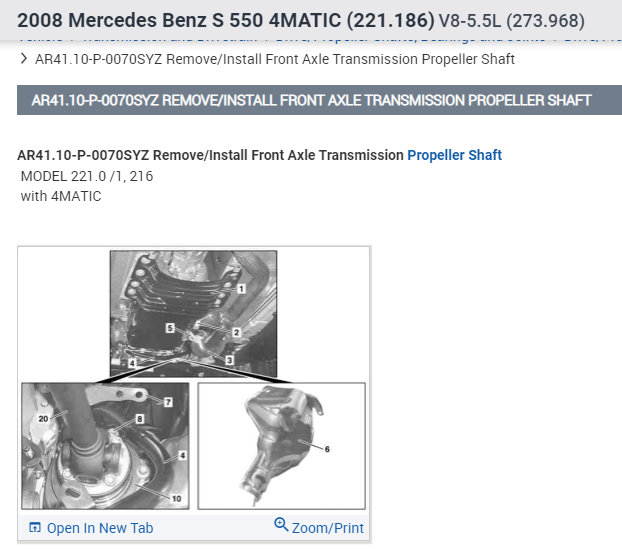

I am converting all the air struts to normal ones. They have a conversion kit for it. Removed front left and noticed the axle is bad. So, i want to remove it before putting everything back as far as strut goes. Can you give me instructions on what is needed to remove the axle?

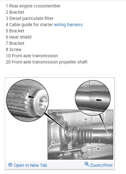

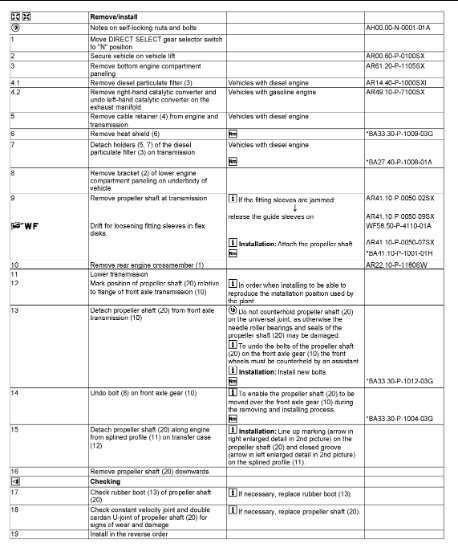

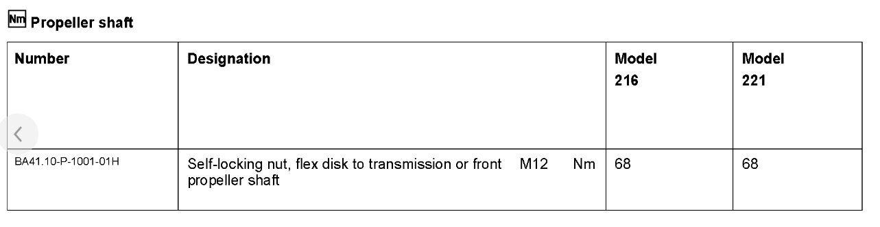

That is a good idea. I attached the directions below for replacing the front axle. Take a look through them and let me know if they help.
Also, let me know if you have questions or if I can help in any way.

I don't think this is what i have. Talks a lot about dieselZ. Also, first picture is for the rear shaft which has bolts, mine has no bolts going into the transfer case.
