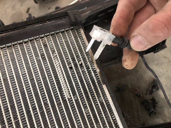

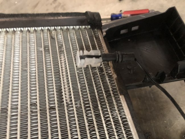

I have an A/C leak underneath the dash on passenger side. I used the leak detector to find it. Can you provide any instructions? I know dash has to come out.
Mar 25, 2021 at 1:48 AM
Hello again my friend,
I attached the procedure below for you. You have a big job ahead of you as this is a tough one.
https://www.2carpros.com/articles/air-conditioner-leak-detection

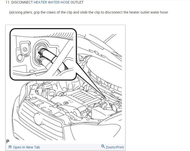

11. DISCONNECT HEATER WATER HOSE OUTLET
(a)Using pliers, grip the claws of the clip and slide the clip to disconnect the heater outlet water hose.
NOTICE:
* Do not apply excessive force to the heater outlet water hose.
* Prepare a drain pan or cloth in case the coolant leaks.

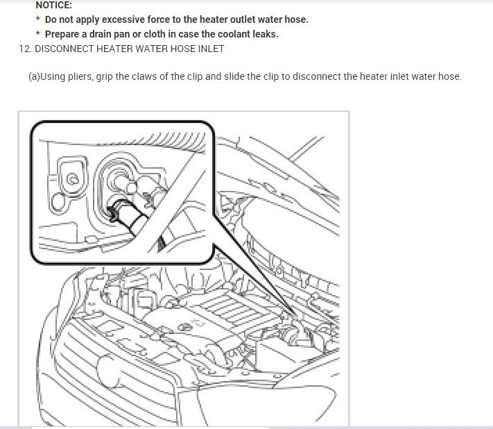

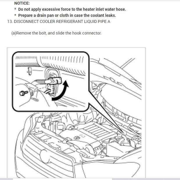

12. DISCONNECT HEATER WATER HOSE INLET
(a)Using pliers, grip the claws of the clip and slide the clip to disconnect the heater inlet water hose.
NOTICE:
* Do not apply excessive force to the heater inlet water hose.
13. DISCONNECT COOLER REFRIGERANT LIQUID PIPE A
(a)Remove the bolt, and slide the hook connector.
(b)Disconnect the cooler refrigerant liquid pipe A.
(c)Remove the O-ring from the cooler refrigerant liquid pipe A.

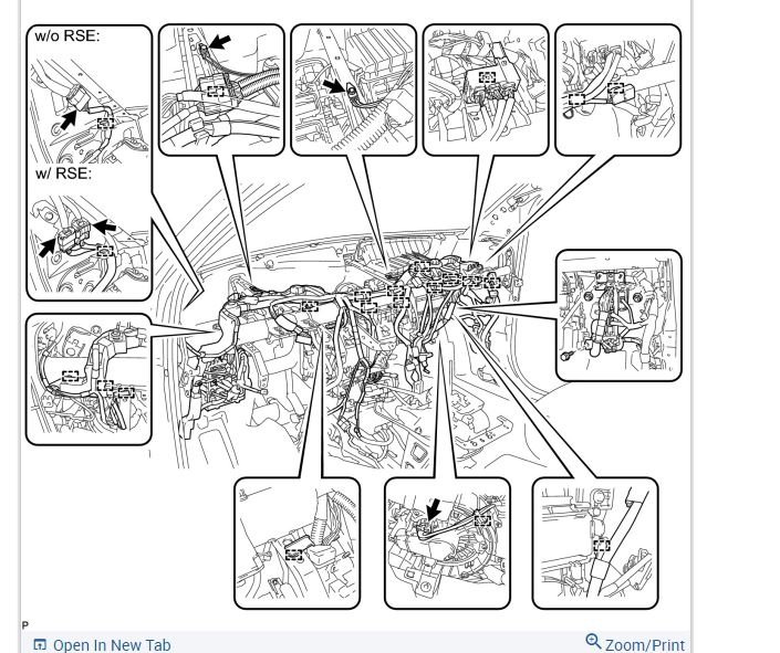

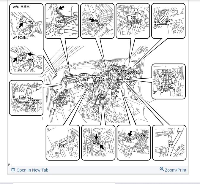

54. DISCONNECT INSTRUMENT PANEL WIRE ASSEMBLY See: Air Bag > Removal and Replacement > Removal

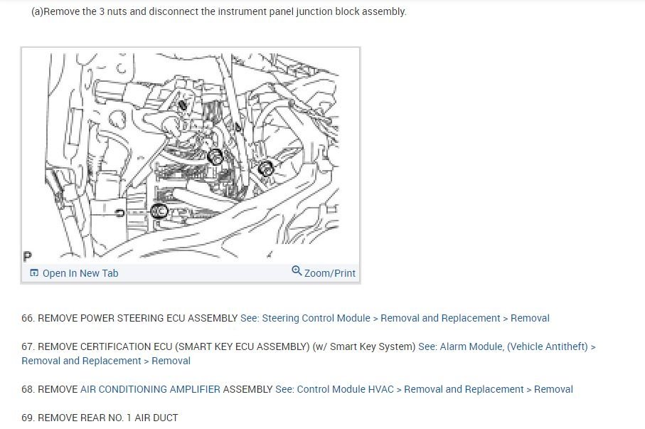

65. DISCONNECT INSTRUMENT PANEL JUNCTION BLOCK ASSEMBLY
(a)Remove the 3 nuts and disconnect the instrument panel junction block assembly.
66. REMOVE POWER STEERING ECU ASSEMBLY See: Steering Control Module > Removal and Replacement > Removal
67. REMOVE CERTIFICATION ECU (SMART KEY ECU ASSEMBLY) (w/ Smart Key System) See: Alarm Module, (Vehicle Antitheft) > Removal and Replacement > Removal
68. REMOVE AIR CONDITIONING AMPLIFIER ASSEMBLY See: Control Module HVAC > Removal and Replacement > Removal

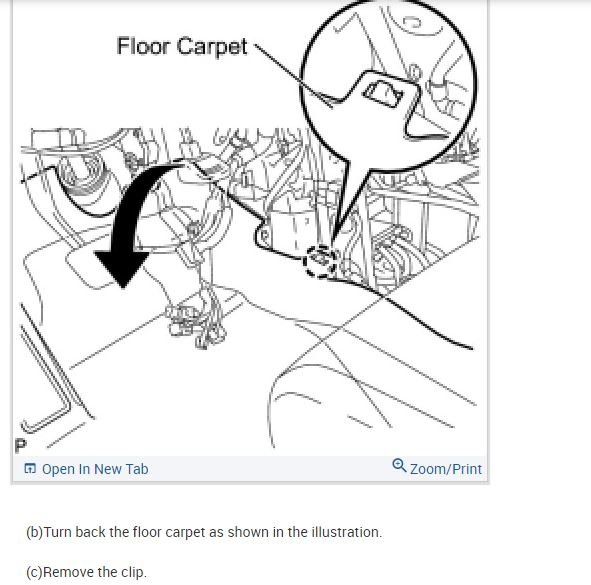

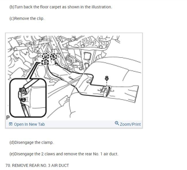

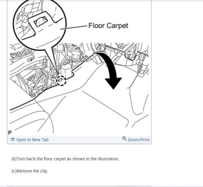

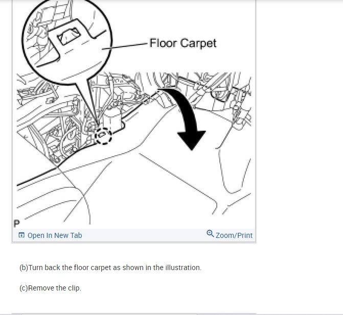

69. REMOVE REAR NO. 1 AIR DUCT
(a)Disengage the claw.
(b)Turn back the floor carpet as shown in the illustration.
(c)Remove the clip.
(d)Disengage the clamp.
(e)Disengage the 2 claws and remove the rear No. 1 air duct.
70. REMOVE REAR NO. 3 AIR DUCT
(c)Remove the clip.
(d)Disengage the 2 claws and remove the rear No. 3 air duct.

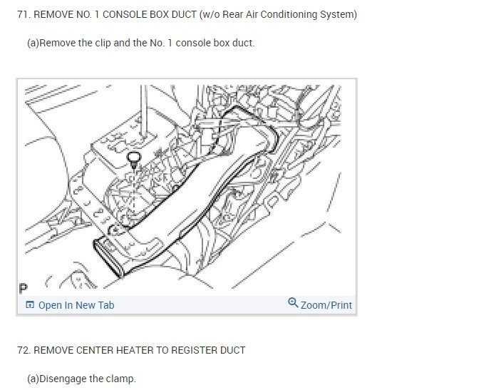

71. REMOVE NO. 1 CONSOLE BOX DUCT (w/o Rear Air Conditioning System)
(a)Remove the clip and the No. 1 console box duct.

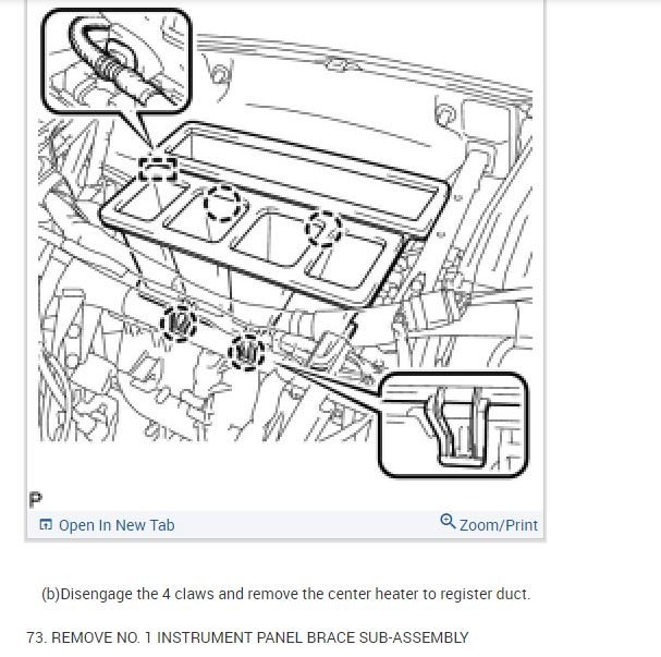

72. REMOVE CENTER HEATER TO REGISTER DUCT
(a)Disengage the clamp.
(b)Disengage the 4 claws and remove the center heater to register duct.

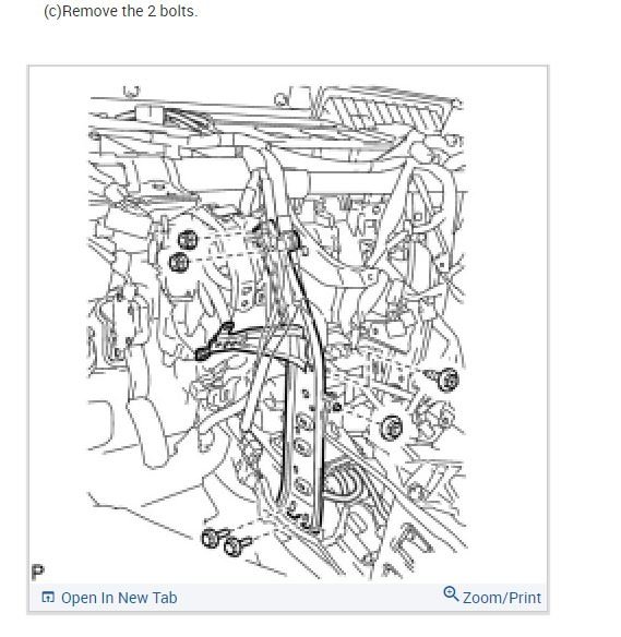

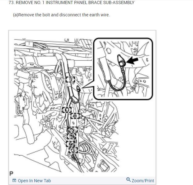

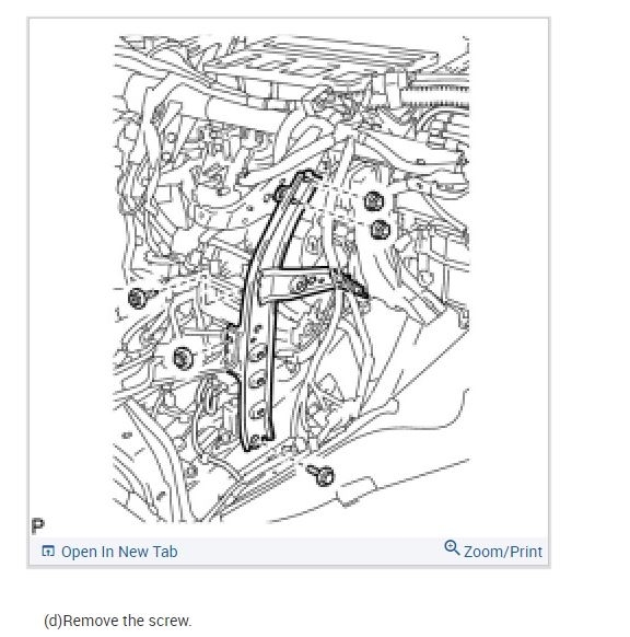

73. REMOVE NO. 1 INSTRUMENT PANEL BRACE SUB-ASSEMBLY
(a)Remove the bolt and disconnect the earth wire.
(b)Disengage each clamp.
(c)Remove the 2 bolts.
(d)Remove the screw.
(e)Remove the 3 nuts and the No. 1 instrument panel brace sub-assembly.

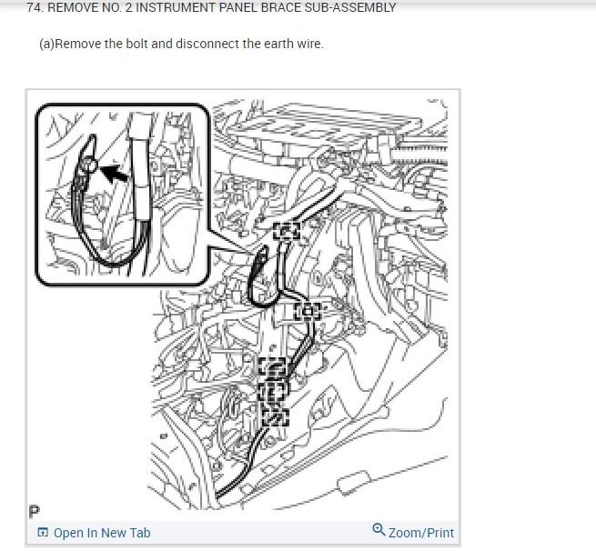

74. REMOVE NO. 2 INSTRUMENT PANEL BRACE SUB-ASSEMBLY
(c)Remove the bolt.
(e)Remove the 3 nuts and the No. 2 instrument panel brace sub-assembly.

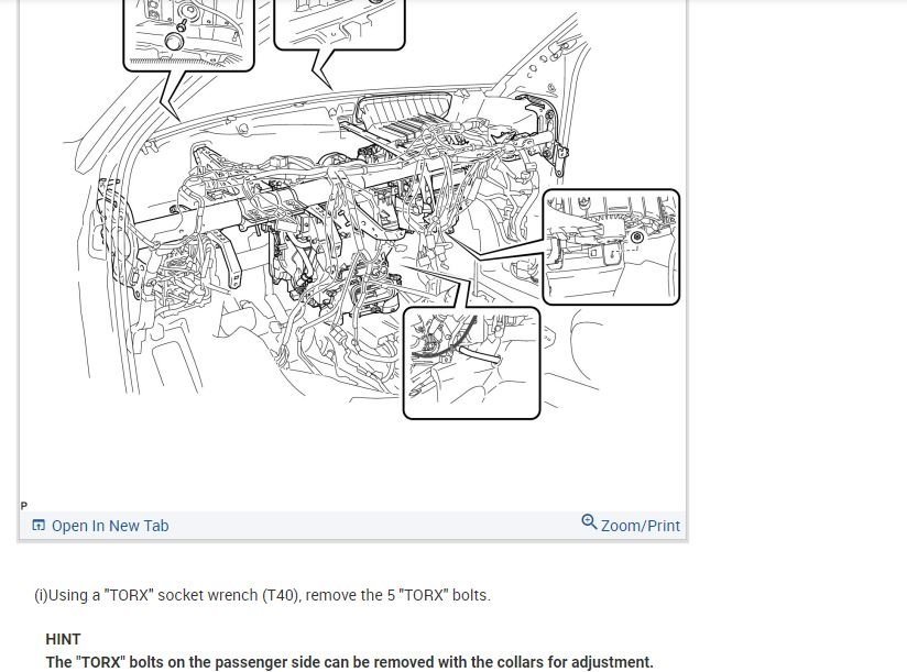

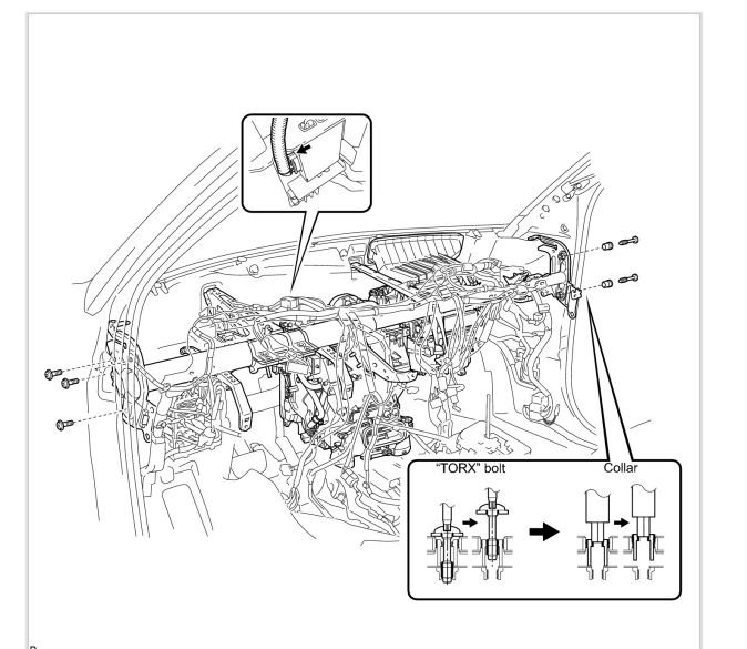

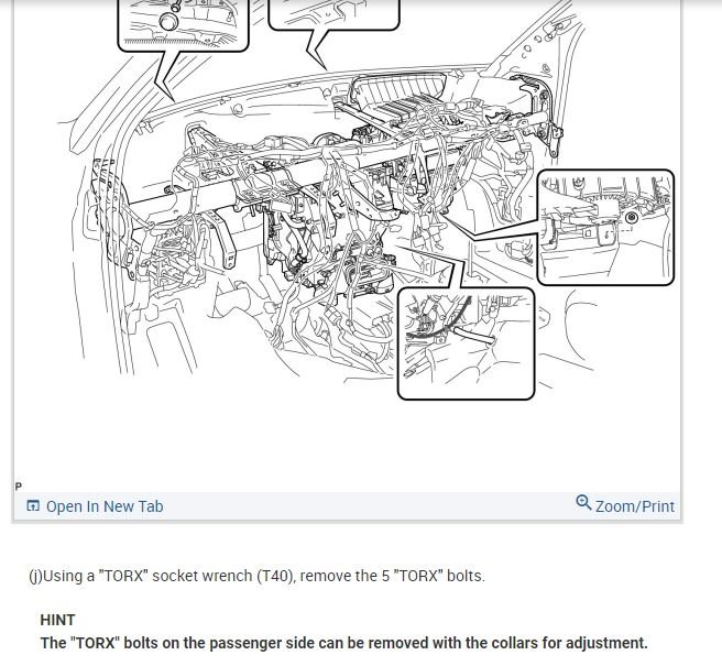

75. REMOVE INSTRUMENT PANEL REINFORCEMENT ASSEMBLY WITH AIR CONDITIONING UNIT (w/o PTC Heater)
(a)Disengage each clamp.
(b)Remove the 2 bolts and disconnect the 2 earth wires.
(c)Disconnect each connector.
(d)Remove the 2 nuts and bolt.
(e)Disconnect the blower motor connector.
(f)Remove the 2 caps and the 2 bolts from the engine compartment side.
(g)Disconnect the cooler drain hose.
(h)Remove the nut.
(i)Using a "TORX" socket wrench (T40), remove the 5 "TORX" bolts.
HINT
The "TORX" bolts on the passenger side can be removed with the collars for adjustment.
(j)Using a 12 mm hexagon wrench, remove the 2 collars and the instrument panel reinforcement assembly with air conditioning unit.
(k)Disconnect the connector.

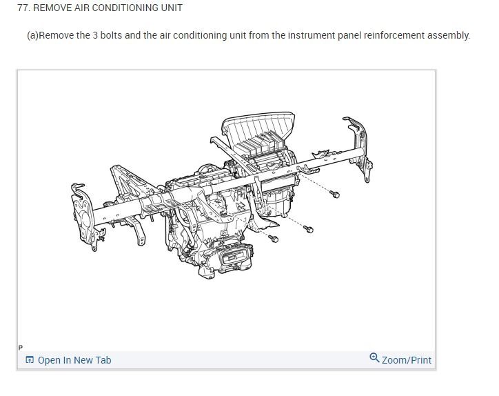

77. REMOVE AIR CONDITIONING UNIT
(a)Remove the 3 bolts and the air conditioning unit from the instrument panel reinforcement assembly.

Ya, i know. this is worse than removing the motor, lol. done it on a couple of Lexus's before so I am aware of how bad, it is what it is. Thanks for your help.

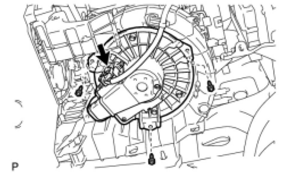

Do you know how the A/C blower comes out? I cant see a way at all.
AIR CONDITIONING: FRONT BLOWER MOTOR: REMOVAL
1. REMOVE NO. 2 INSTRUMENT PANEL UNDER COVER SUB-ASSEMBLY See: Dashboard / Instrument Panel > Removal and Replacement > Removal
2. REMOVE FRONT BLOWER MOTOR SUB-ASSEMBLY
(a)Disconnect the connector.
(b)Remove the 3 screws and the front blower motor sub-assembly.

Finally out, geez this is insane, and I thought German cars are stupid. There is a sensor that sticks into the evaporator on the old one, with 2 teeth, do you know what it's for? I don't know where to install it on the new one. Pictures below.
Mar 29, 2021 at 5:13 AM
That is the evaporator temperature sensor. That prevents icing in the system.
You can mount it the center of the evaporator.
Mar 29, 2021 at 5:18 AM
NASER NASER
  • 836 POSTS
but inserting it in the evaporator won't poke a hole? also, the new evaporator did not come with the expansion valve o rings, having a hard time finding it, even new expansion valves do not come with o rings. what is your take on that?
Mar 29, 2021 at 5:26 AM
That is the manufacturer.
It goes in the fins.
