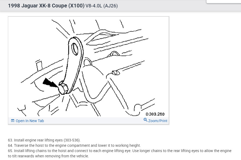

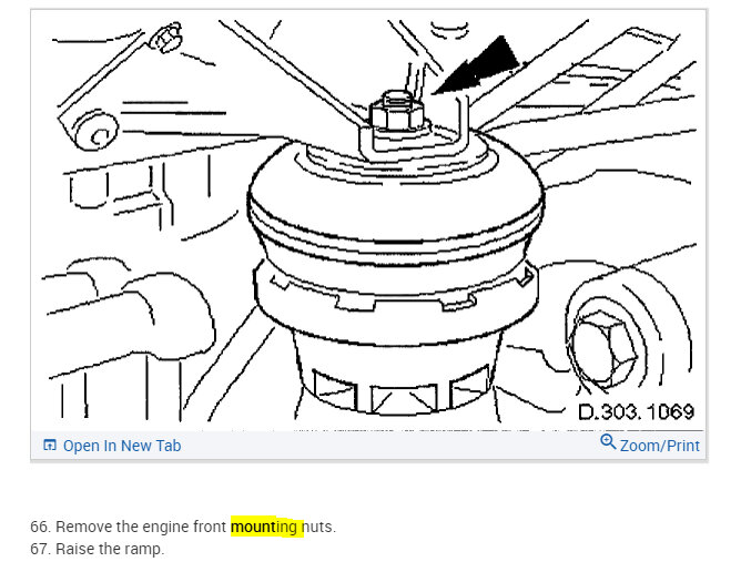

Since it is really tight, I am not able to remove the nut on the top on the driver side, jacked up the motor and I got more room, but this thing is super tight, no way to place a cheap bar or anything, you can only have 2-3 inches of leverage, what does the manual say about replacing this side?

The manual doesn't provide specifics just for the mounts, so I went to engine removal. I attached two pics below that are the only things listed for the front mounts (both sides).
Let me know if this helps. If you want all the directions for engine removal, let me know.

Yes, that does not help, but thanks for looking.

All done, had a friend who is a mechanic come by, he installed a pair of vise grips on too of the ratchet vertically and used a prybar and got it loose.
