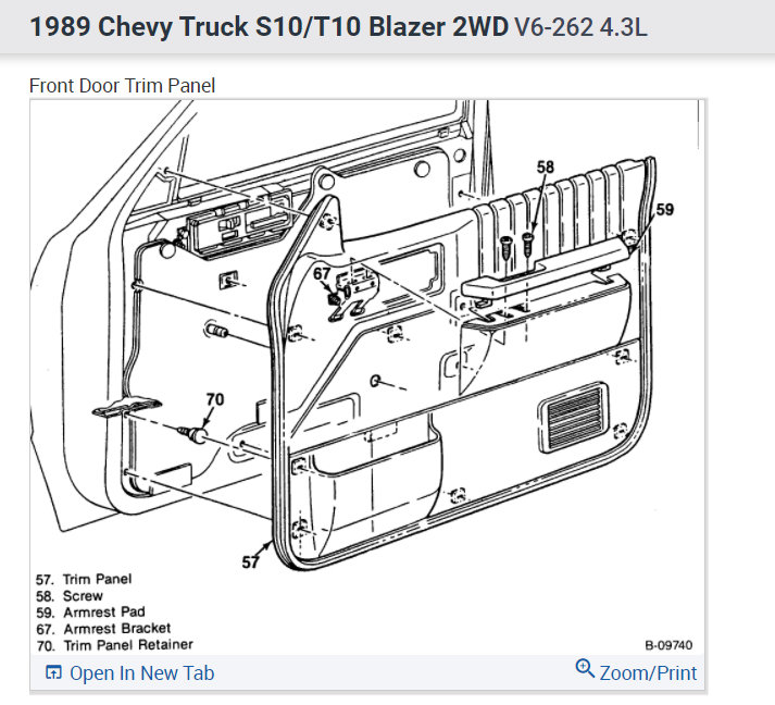

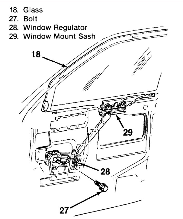

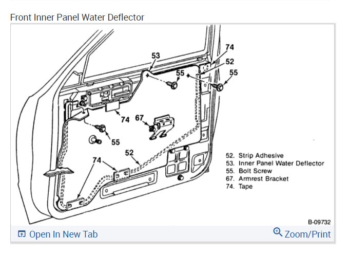

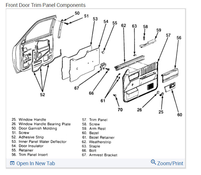

I'm trying to reassemble driver side power window. My kid's have lost the bolt's. Can you send me a diagram of how to put everything back? I have the window in and wood pieces holding it up.
Apr 30, 2021 at 5:09 AM
  • 55,402 POSTS
Here is a guide to help you step by step with instructions in the diagrams below to show you how on your car:
https://www.2carpros.com/articles/how-to-check-and-replace-a-electric-power-window-motor
