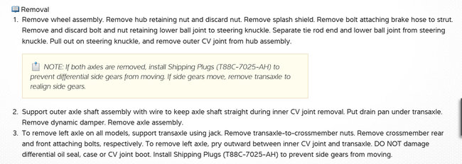

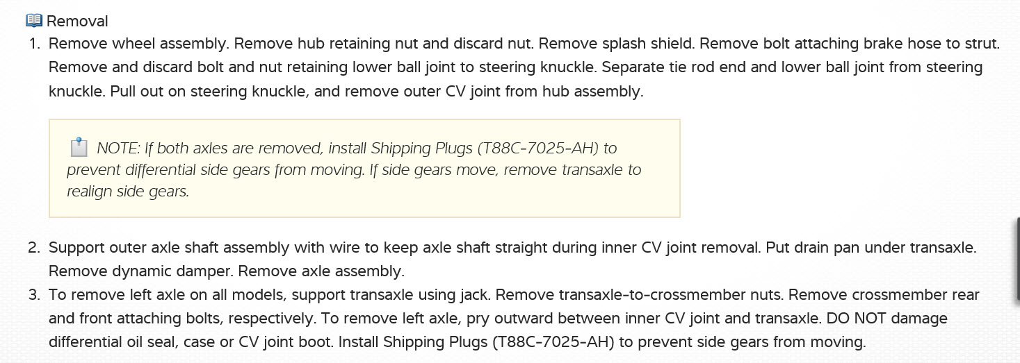

Need to know how to replace myself
Apr 14, 2016 at 6:36 PM
HMAC300
Experienced Mechanic
48,601 POSTS
we don't have festivas in USA that year . here is for a n escort it's similar. we have no specs on torque for this for an escort they are 174-200 ft.lb.
