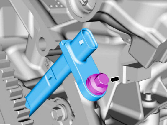

replacing crankshaft sensor?
2018 FORD F-150
118,342 MILES • 2.7L • V6 • TURBO • 4WD • AUTOMATIC
GREG BLANTON
will not fire at all after replacing sensor
Feb 4, 2026 at 11:55 PM
  • 55,433 POSTS
I would think the new sensor is defective, I would get an OEM sensor to replace it with. Here is the location of the sensor to make sure we are on the same page, this sensor is not easy to get to so make sure the electrical connector is attached correctly with the wiring intact, and is free from dirt. Check the length of the sensor, this is important. Also, using a scan tool, perform the Misfire Monitor Neutral Profile Correction procedure by following the on-screen instructions. Check out the images (below). Let us know how it goes
