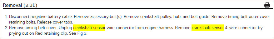

Hello, I have a late model Ranger 2.3 ltr 10/94. Could you please send me remove and replace instructions for the crankshaft position sensor? All help will be greatly appreciated.
Thank you,
Tina
Sep 17, 2018 at 9:28 AM
DANNY L
  • 5,648 POSTS
Hello, I am Danny.

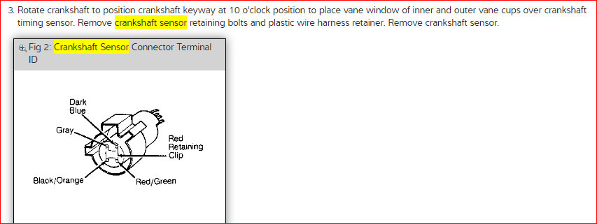

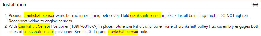

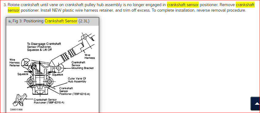

I have attached a tutorial for you showing what is involved as well as step-by-step instructions. It is located on the lower front of engine near crankshaft pulley. Hope this helps and thanks for using 2CarPros.
