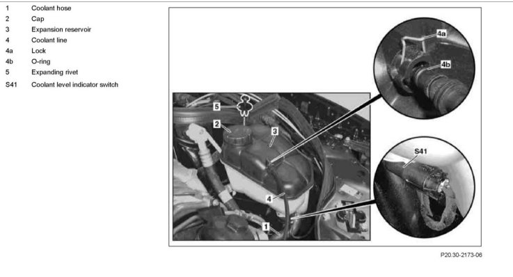

Do I need to flush the radiator to replace the coolant reservoir?
Jul 24, 2017 at 2:44 AM
  • 55,766 POSTS
Yes that is a very good idea to make sure all of the coolant is new and in good shape. Here are a couple of guides to show you what you are in for when doing the job.
https://www.2carpros.com/articles/coolant-flush-and-refill-all-cars
and
https://www.2carpros.com/articles/coolant-reservoir-replacement
Diagram below for your car.
