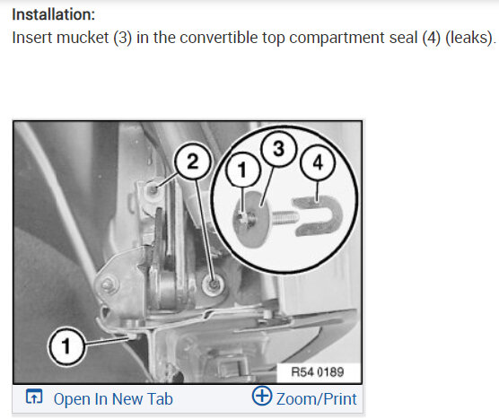

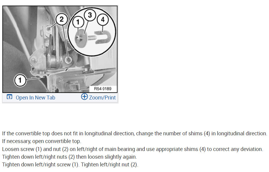

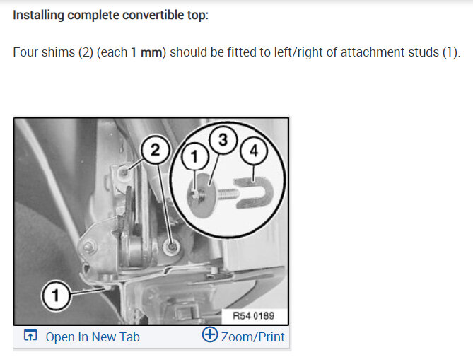

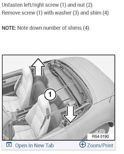

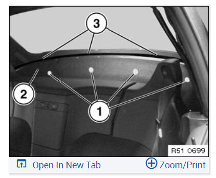

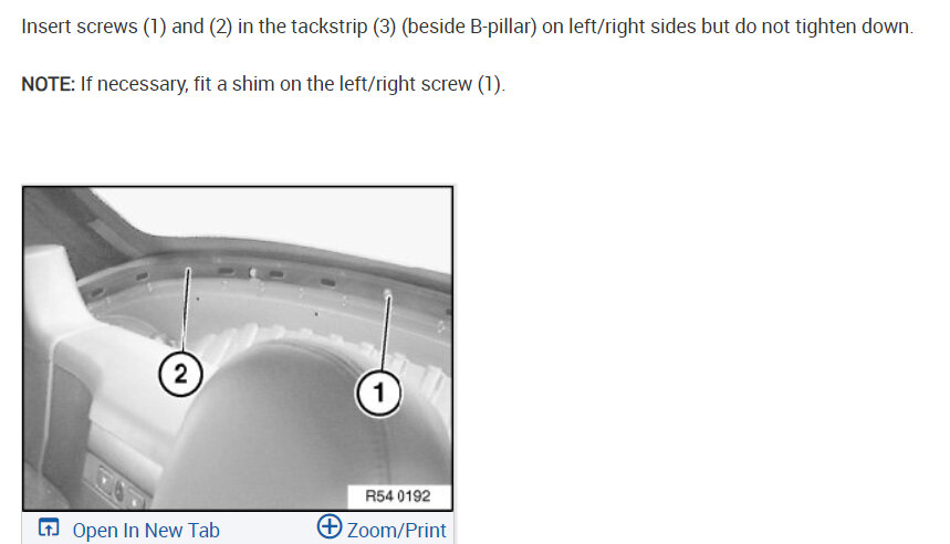

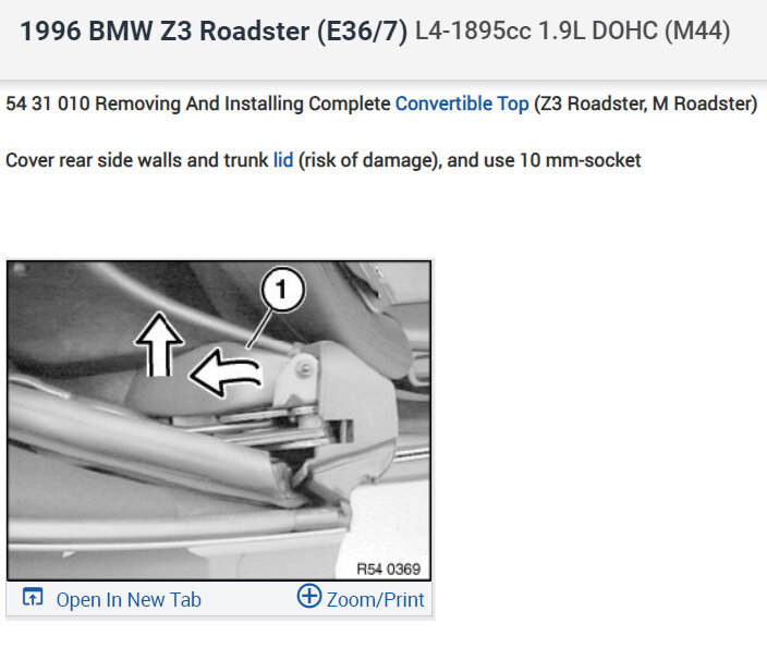

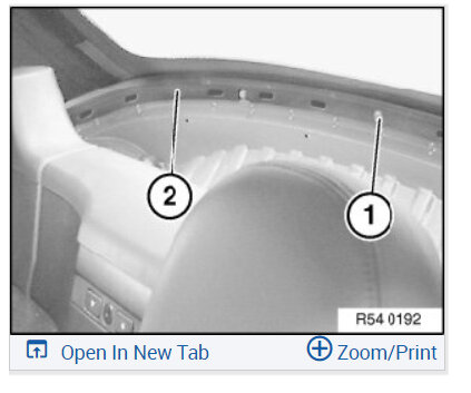

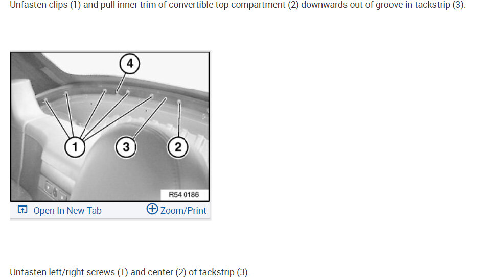

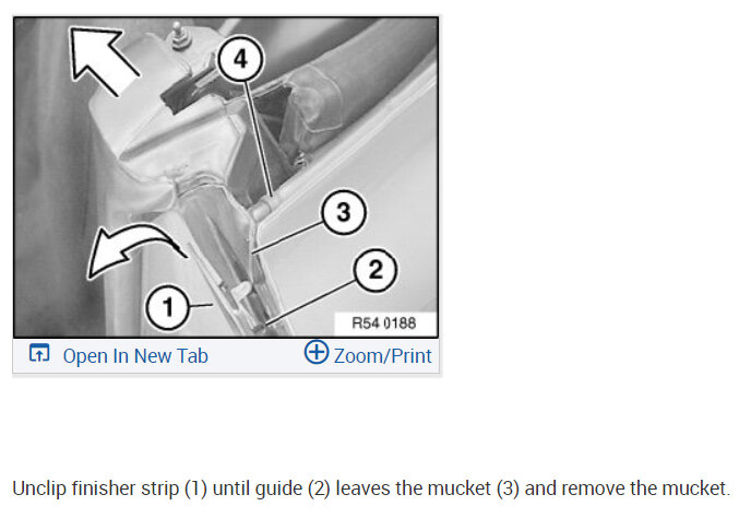

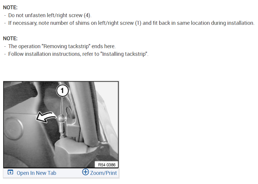

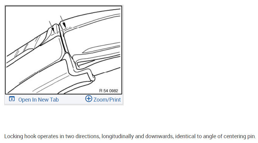

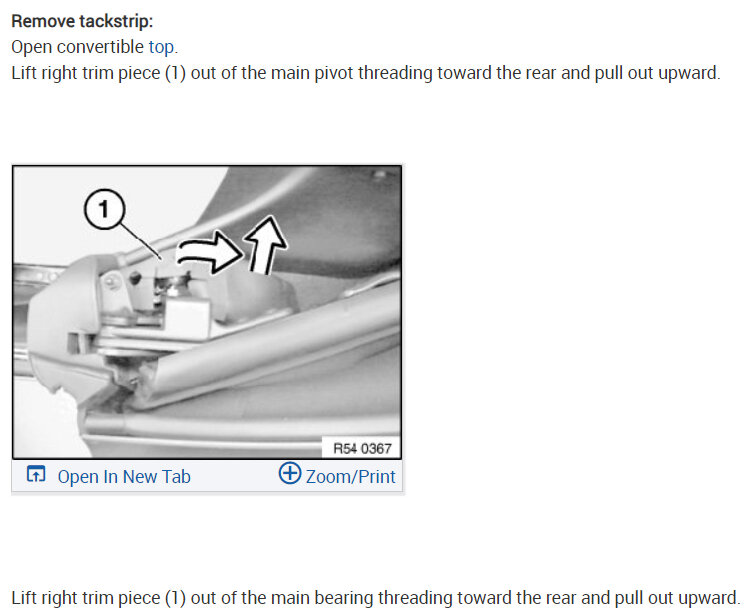

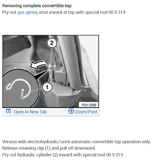

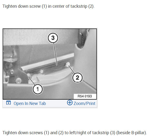

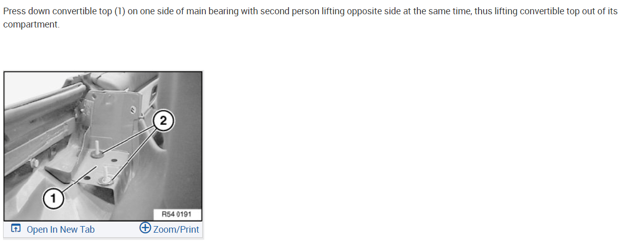

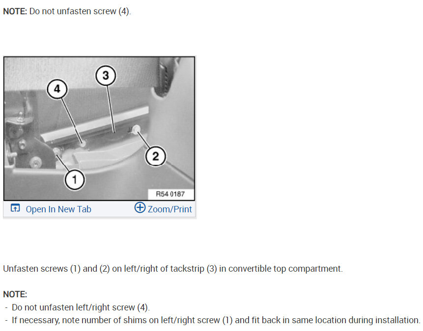

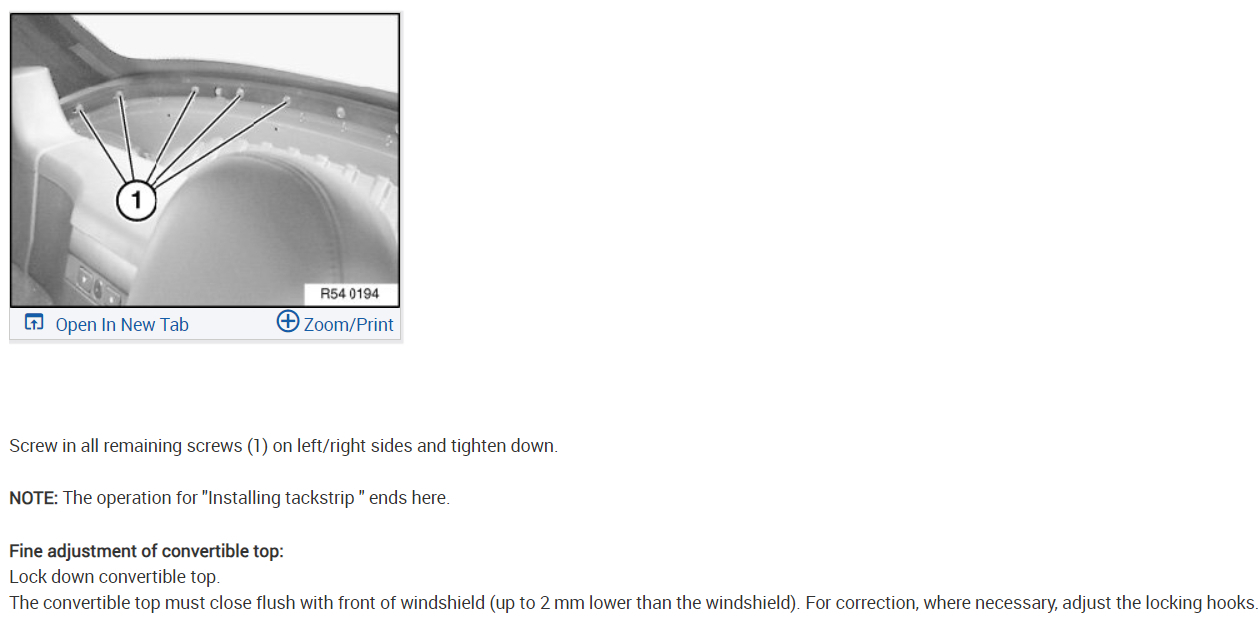

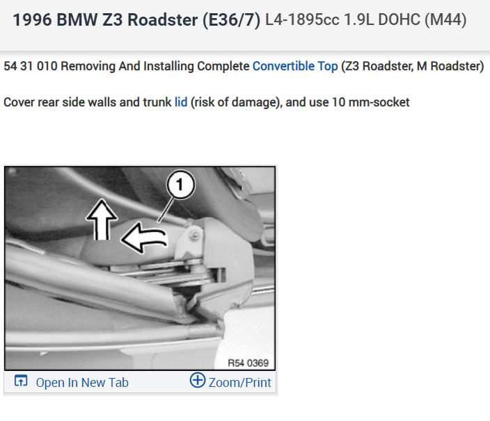

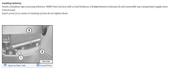

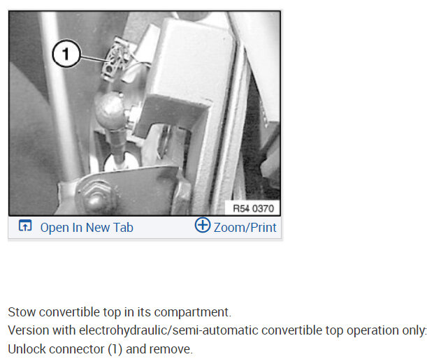

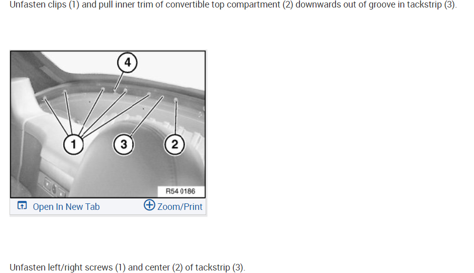

I need to replace my top including frame. What is the process?
Jun 22, 2024 at 12:42 AM
  • 55,399 POSTS
I would start by disconnecting the battery, here are the complete instructions on how to change out the convertible top as you have requested. Check out the images (below). Let us know if you need anything else.
