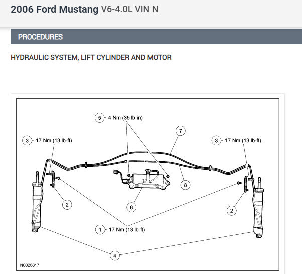

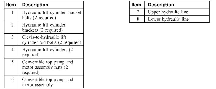

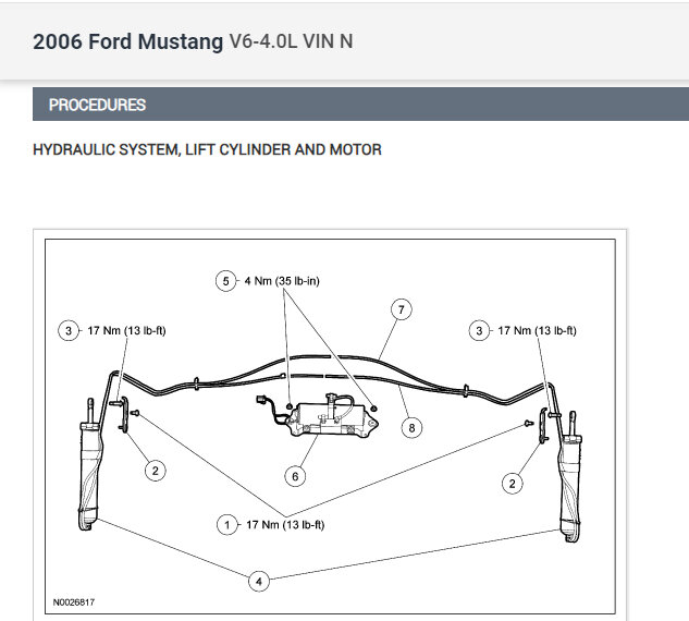

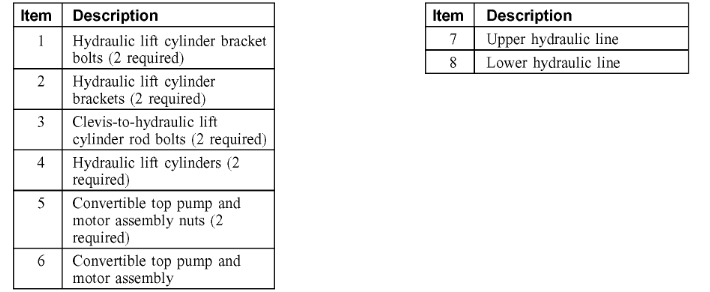

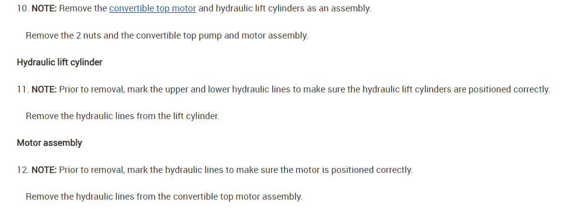

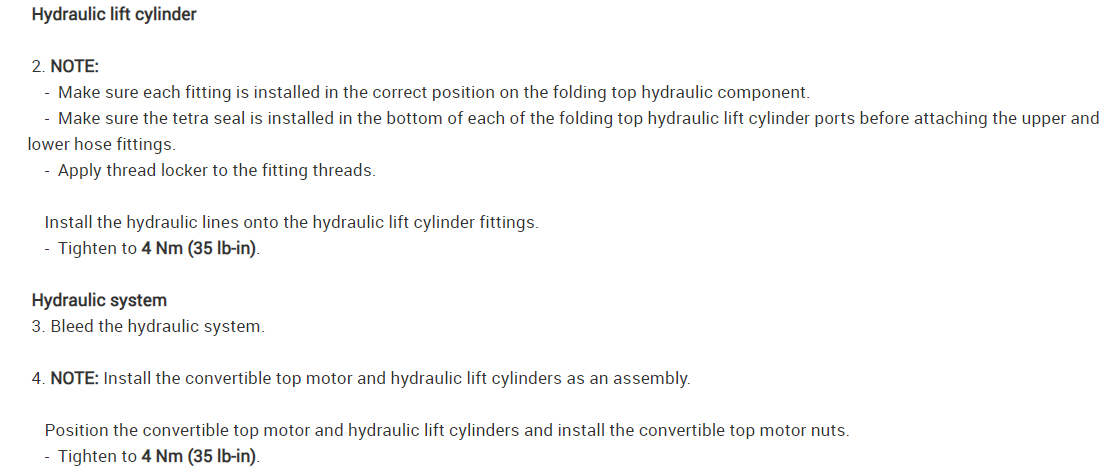

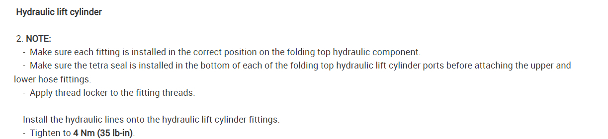

Can you get me some instructions on how to replace the passenger side top cylinder? it is leaking, but I cannot find anything online about how to do so.
Feb 20, 2024 at 11:18 PM
  • 110,240 POSTS
I attached what I have below. It should help. Take a look through it and let me know if you have questions.
Let me know if this helps.

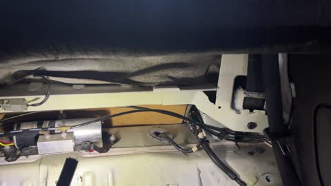

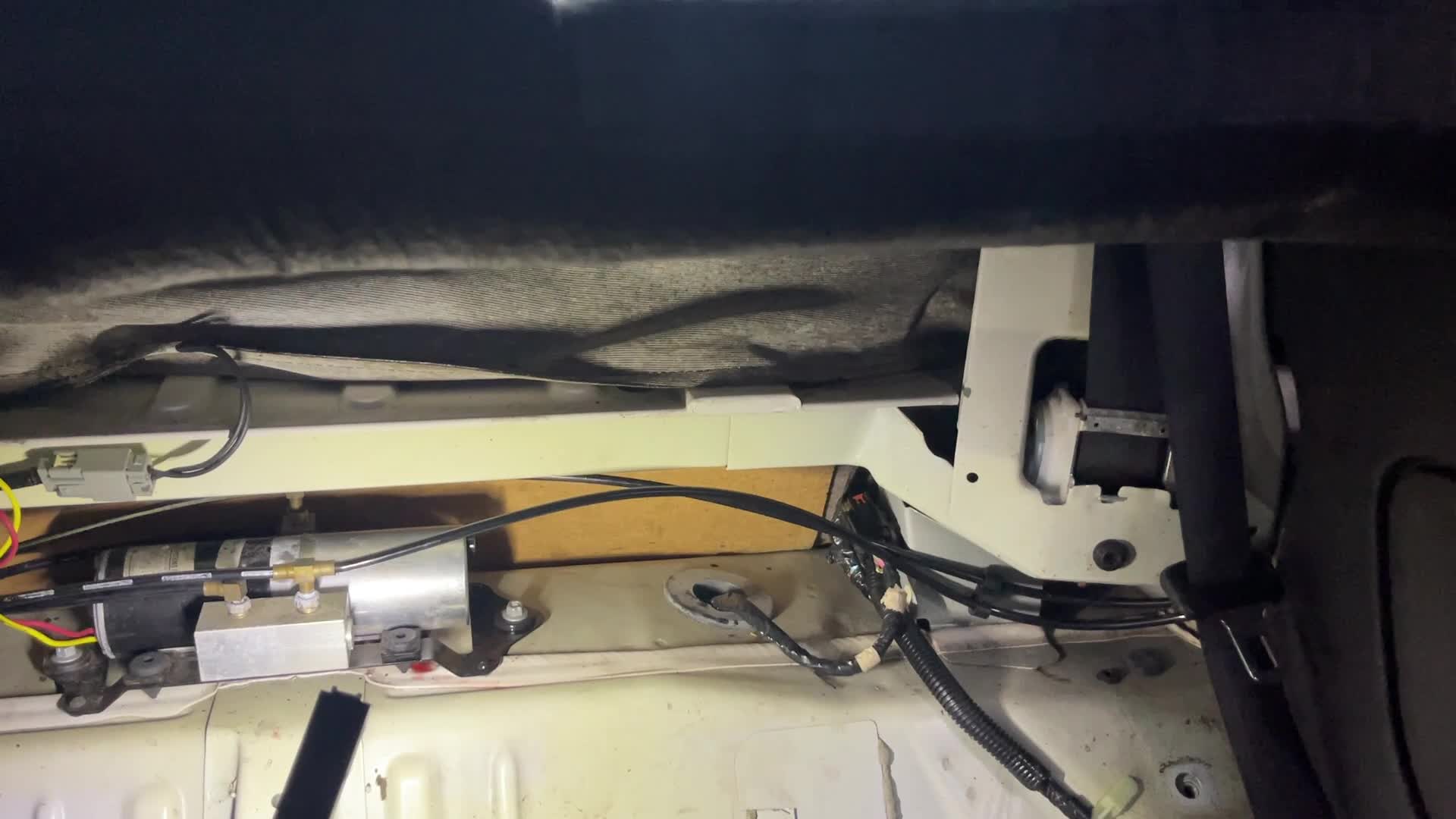

Got it in. Motor sounds noisy does it not? And sometimes needs a minute to cool down before it can work again. Let me know if you think it is. I was trying to bleed it by going up and down. It did but very noisy.
Feb 26, 2024 at 5:52 AM
  • 110,240 POSTS
I think it is so loud because it is exposed. It sounds normal other than a little loud. Once you have things covering it, you won't notice it as much.
I have two convertibles and they sound the same. LOL

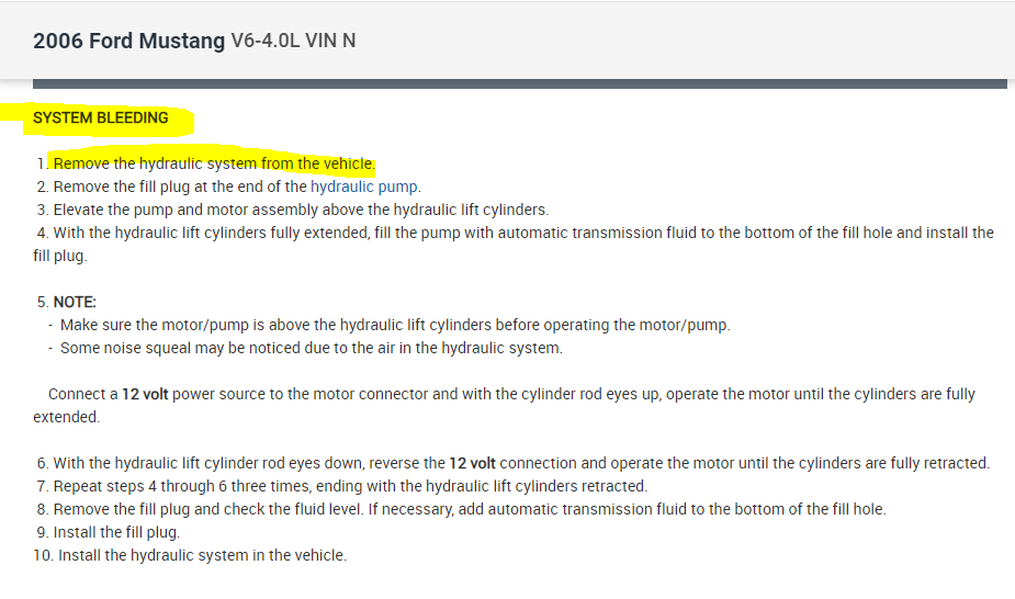

But its taking a minute for the bleeding, sounds like its bubbling on inside and stops every 2 runs.

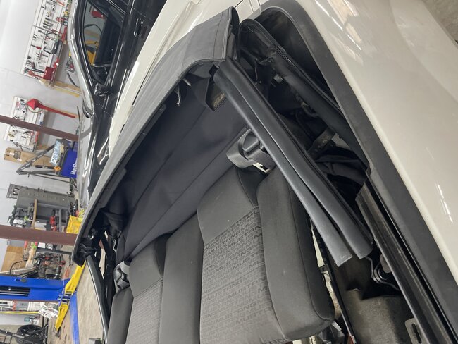

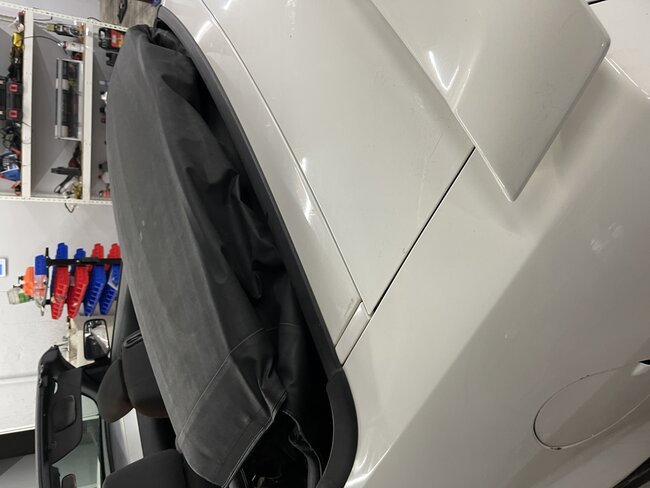

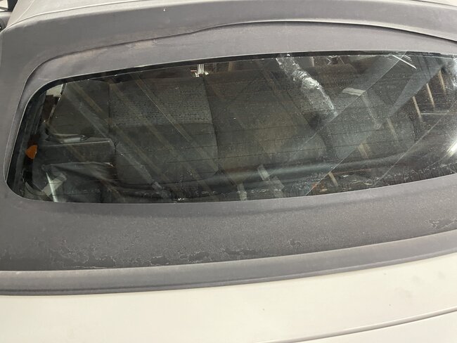

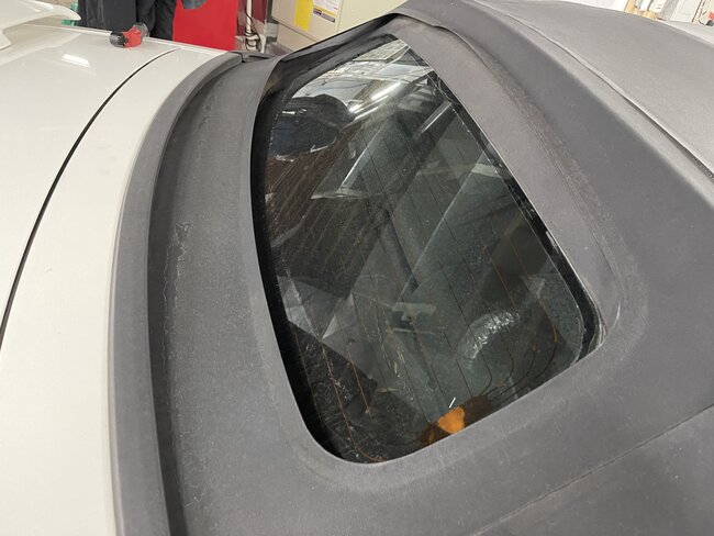

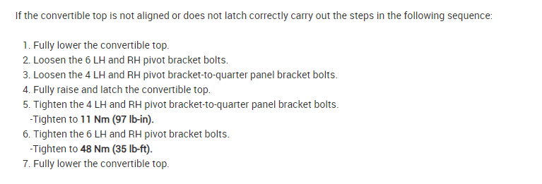

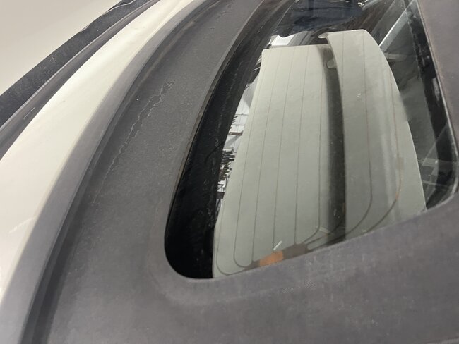

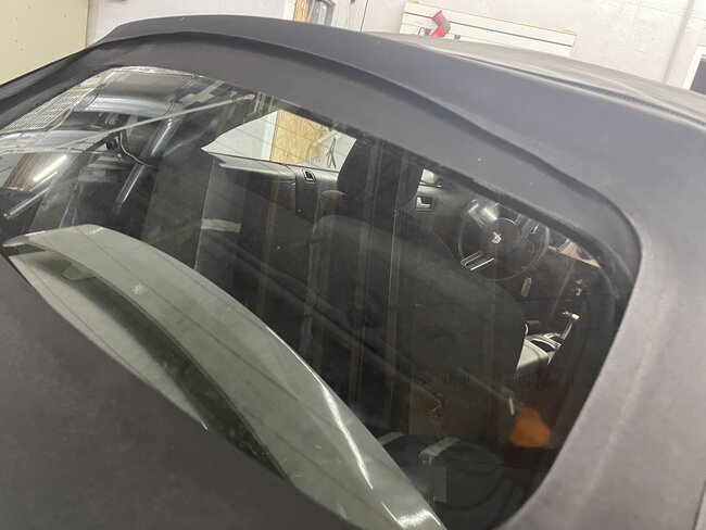

It has gotten better after a few times but still stops after a minute, maybe getting too hot. But even with the top closed the back window doesn't seem right. No tears of any kind but I am not seeing the window flush with outer top material as it should. Front is locked fine but rear windshield is not pushed up.
Feb 26, 2024 at 11:05 PM
BHAMDOC1973
  • 2,007 POSTS

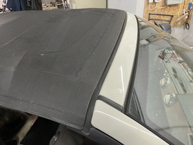

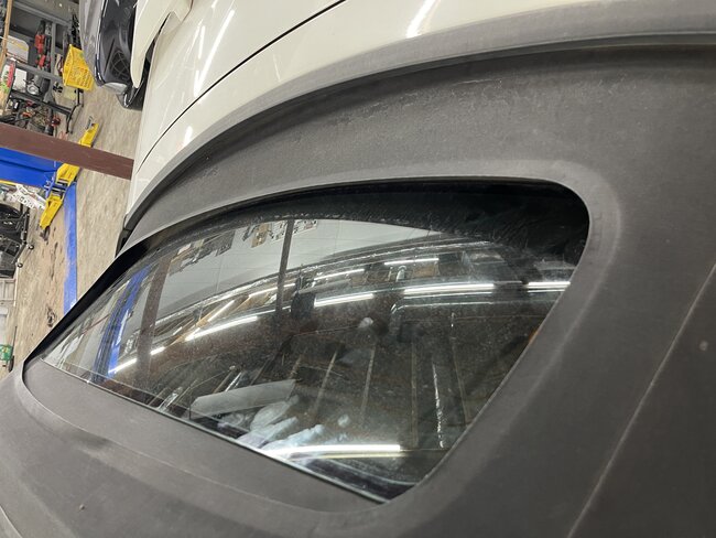

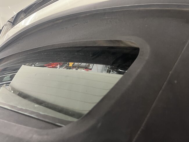

Also, top in rear does not fully seat, should be more flat than this.
Feb 26, 2024 at 11:06 PM
BHAMDOC1973
  • 2,007 POSTS

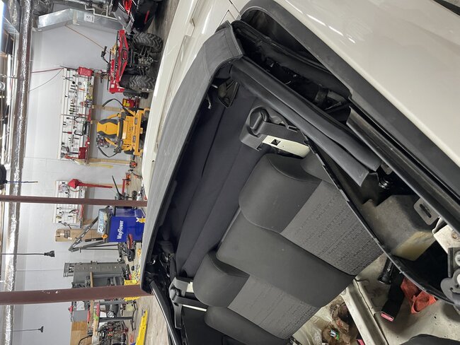

This is best it can go down. I adjusted the straps, so they are tighter on both ends. It did not help. Nothing is in there to prevent it from folding down more.
Feb 27, 2024 at 12:18 AM
  • 110,240 POSTS

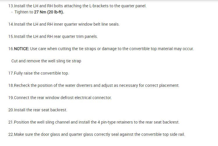

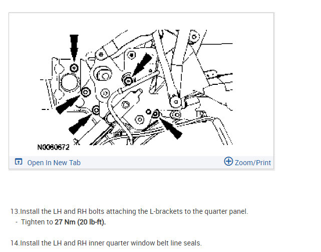

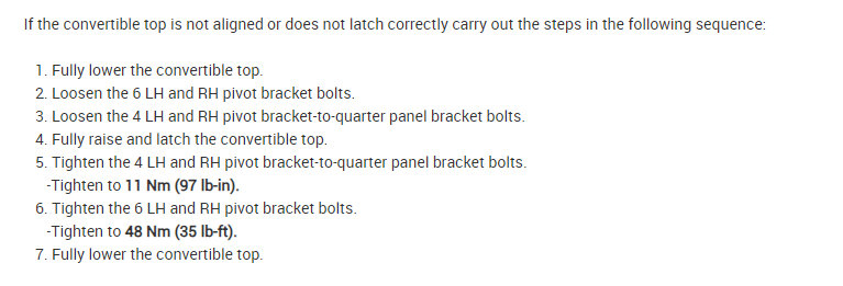

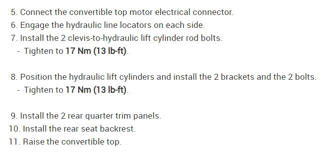

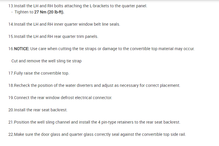

Hi:
That can't be right. LOL Do me a favor. Take a look at the directions I added below. See if the adjustments they indicate help.
Note: The directions are when the top is replaced. However, I feel they are relevant to this issue as well.
See pics below
Feb 27, 2024 at 10:02 AM
BHAMDOC1973
  • 2,007 POSTS
Thanks. Which are the first 6 bolts and which are the 4 bolts
Feb 27, 2024 at 10:21 AM
  • 110,240 POSTS
The four will attach to the body of the vehicle. The six are the pivot bracket.
Feb 27, 2024 at 11:38 AM
BHAMDOC1973
  • 2,007 POSTS
Unfortunately, that did not solve it. I am leaning towards a weak motor. As the top goes down fine but the folding and the power needed to push the top-down motor once it's about to fold is much more than just pulling the top down, that's what I am thinking.
Feb 27, 2024 at 10:11 PM
  • 110,240 POSTS
That is very possible. You did mention it appears to overheat. I thought the motor was new as well. Is that correct?

no, I ordered one but it has not arrived yet.
Feb 28, 2024 at 10:32 AM
  • 110,240 POSTS

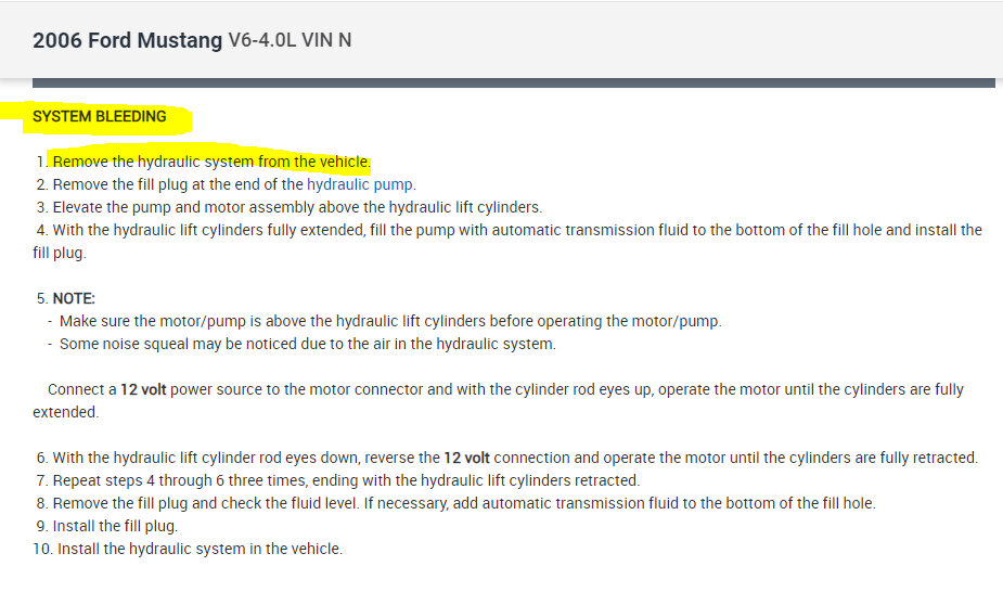

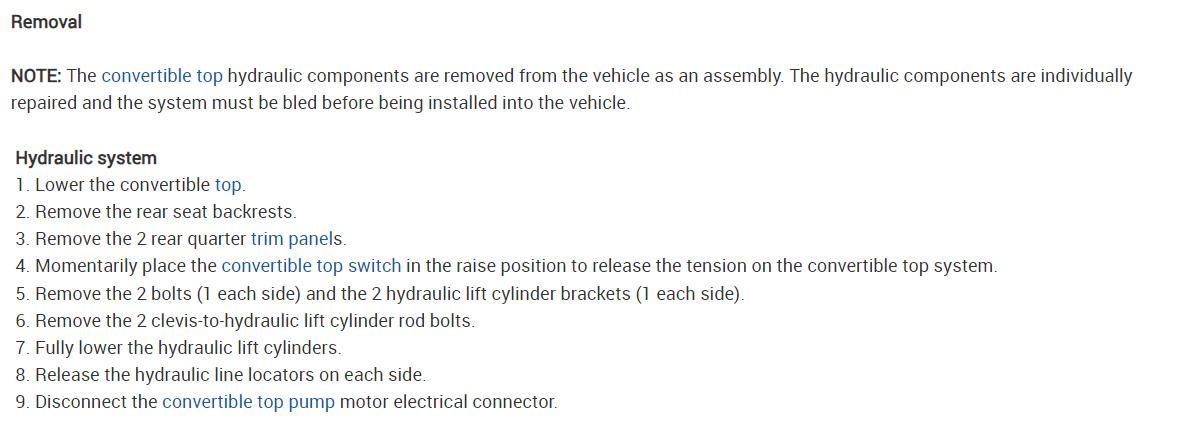

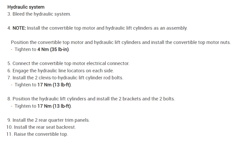

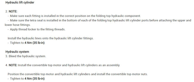

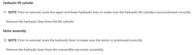

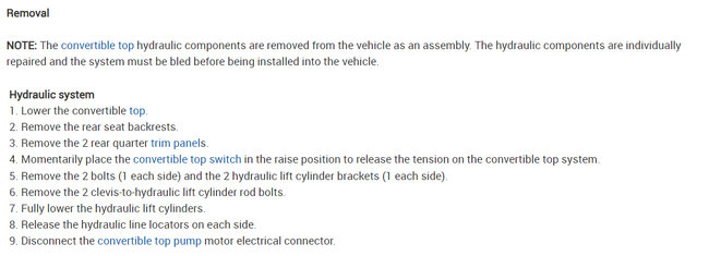

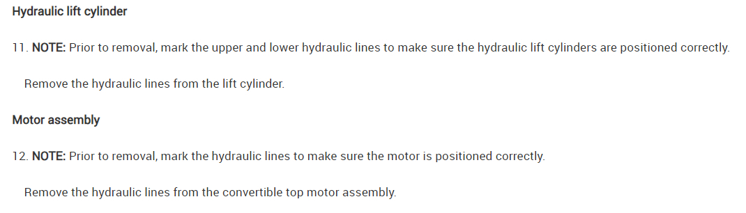

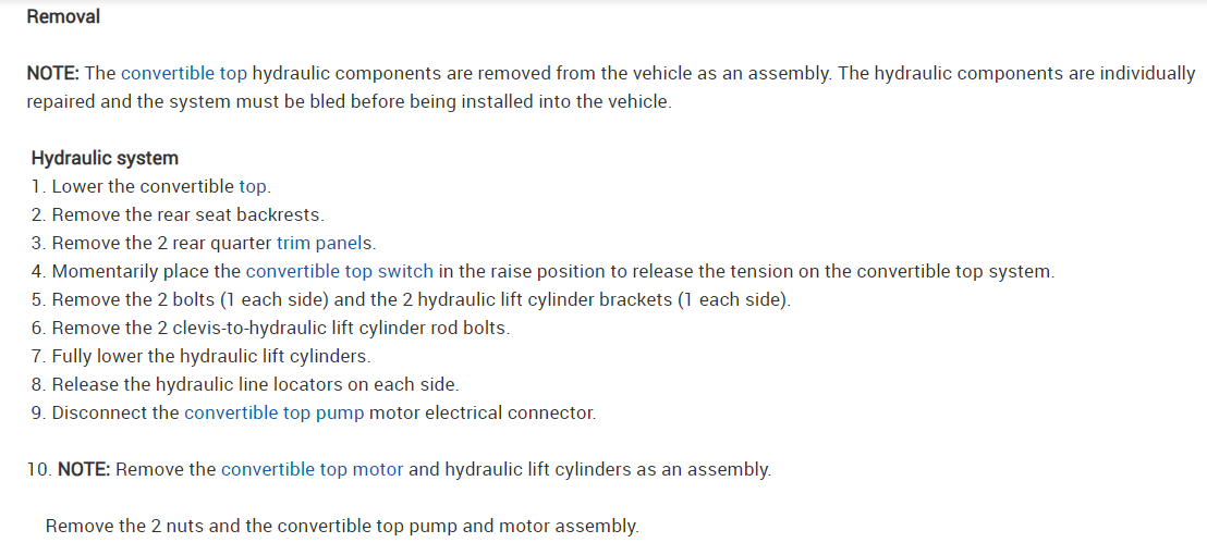

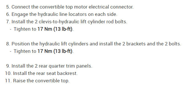

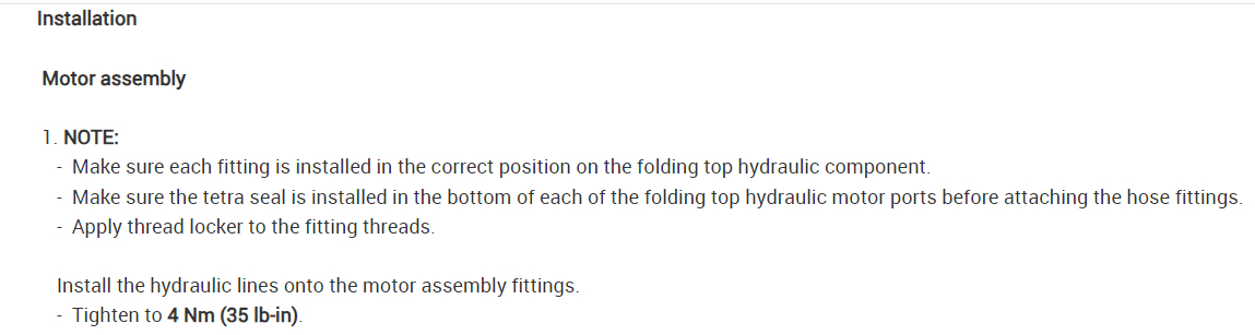

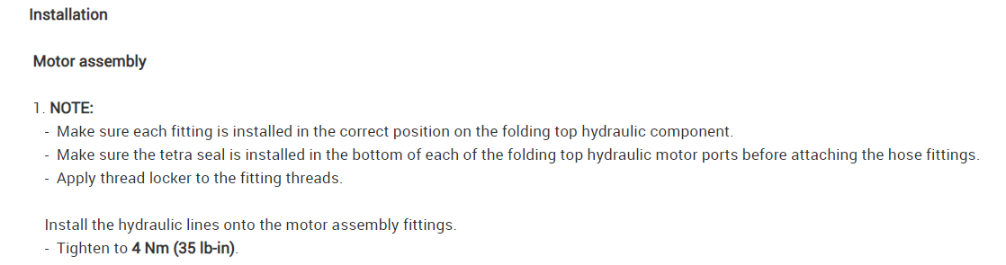

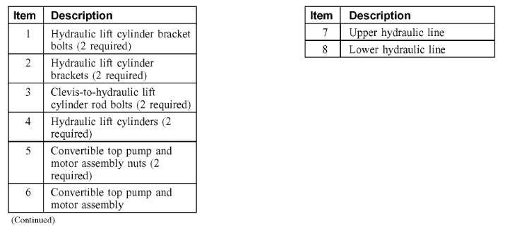

I attached the directions for replacing the motor below. Note: The last pic is the directions for bleeding the hydraulics. Read that before starting.
Let me know if it resolves the issue.
Feb 28, 2024 at 11:03 AM
BHAMDOC1973
  • 2,007 POSTS
Unfortunately, it did not. Must be in the bars, maybe a bent frame.

I looked at the Fram everywhere thing is the top still closes a d reaches the windshield and closes but the rear window still not looking right.
Mar 1, 2024 at 8:53 PM
  • 110,240 POSTS
I'm not sure what to say. Not being there limits me. I agree with you that the rear window doesn't appear to be sitting right. Are there any different bolt holes in the frame that would allow it to stretch and lay better? In other words (I'm not there so please bear with me) could there be a joint where you could be one bolt hole off?

Not sure. It's just weird also that when top is closed the rear window doesn't pop back tight as it should, not understanding the logic of how that happens.

Not sure, but i bought it with to being open as one of the strikers was broken by the windshield. so, i replaced it and now top closes but who knows what previous people did, just strange i fixed many tops not sure what makes the rear tight enough for the shield to look flush.
Mar 2, 2024 at 3:44 AM
BHAMDOC1973
  • 2,007 POSTS
Is it possible someone replaced the top vinyl but did something wrong? The top looks great with no tears and it is hard to believe its original. Thats only thing i can think of.
Mar 3, 2024 at 3:55 AM
  • 110,240 POSTS
Anything is possible. Are you able to press it into place? If so, can you tell where the excess material is coming from?
