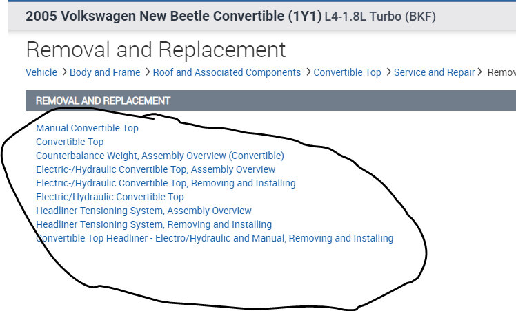

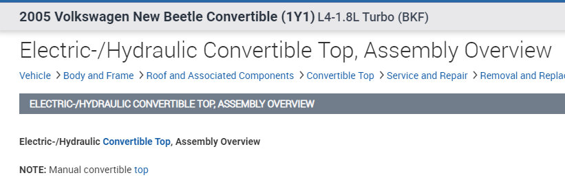

I would be happy to help. However, I need to know if this has a manual convertible or if it is hydraulic.
Also, take a look through the list below and let me know which sections you need. LOL There are several.
See pic below.

Joe,
Thanks for the reply.
It's a power top.

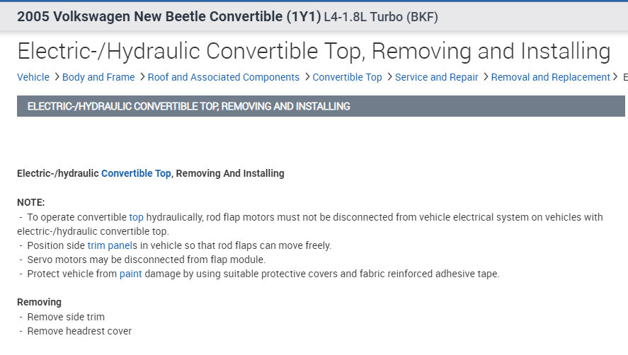

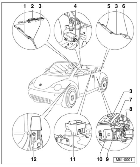

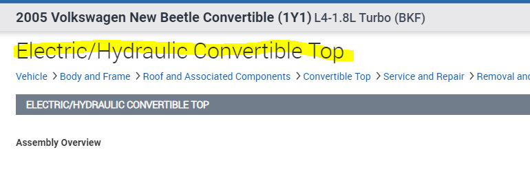

Please provide the following sections:
Electric/hydraulic convertible top assembly overview.
Electric/hydraulic convertible top removing and installing.
Electric/hydraulic convertible top.
Oct 24, 2022 at 8:28 PM
  • 110,248 POSTS

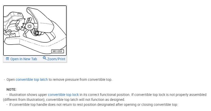

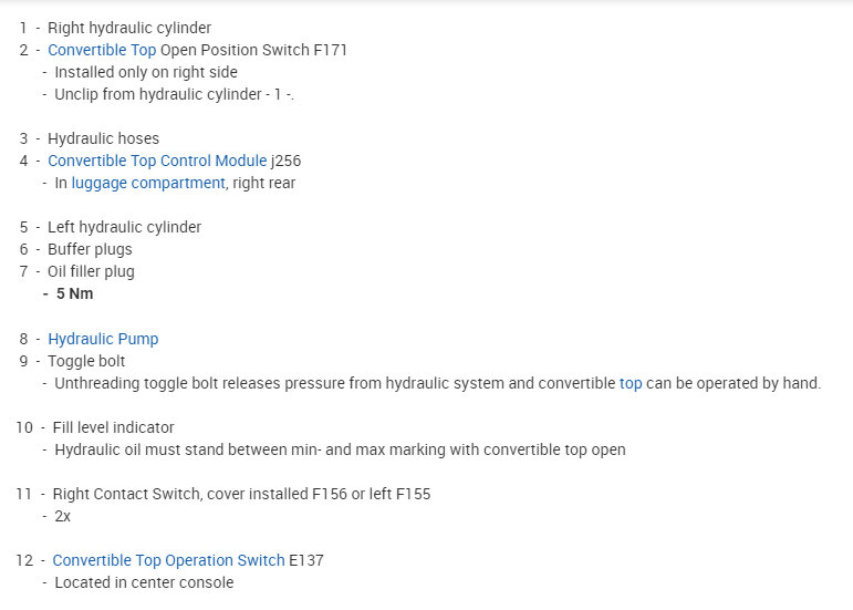

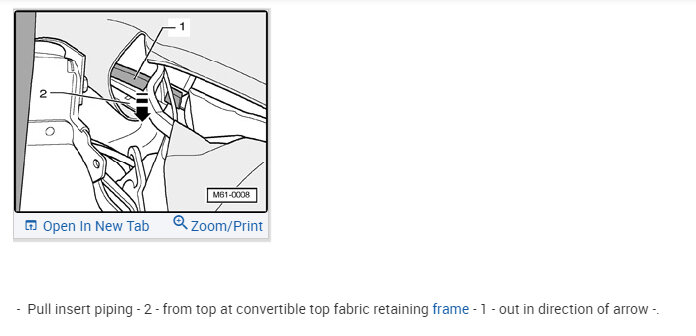

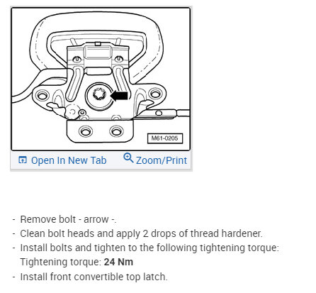

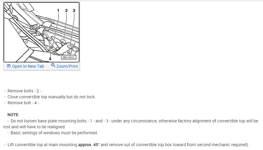

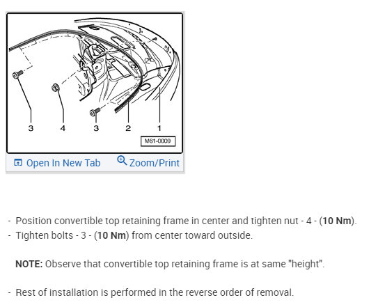

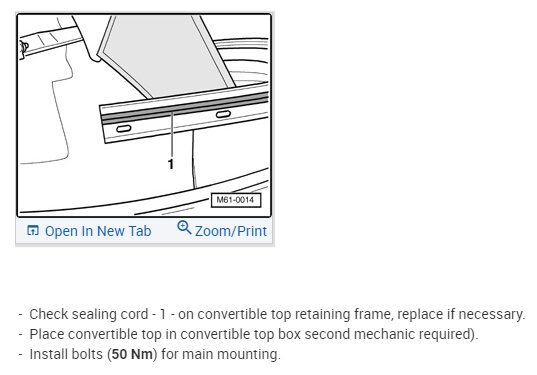

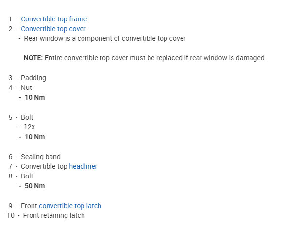

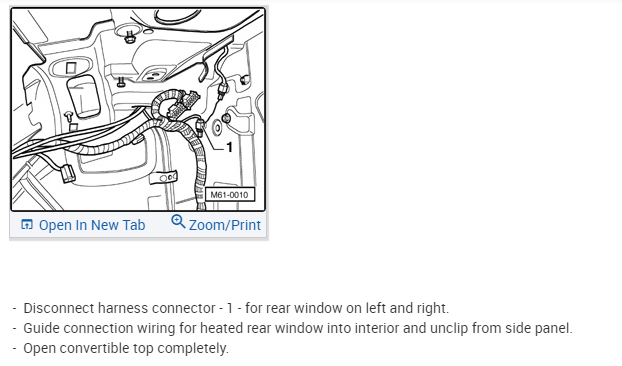

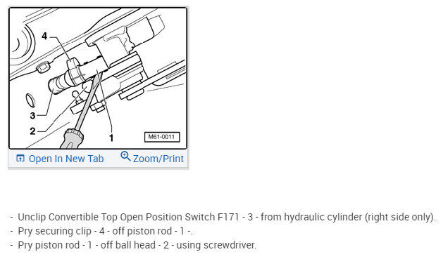

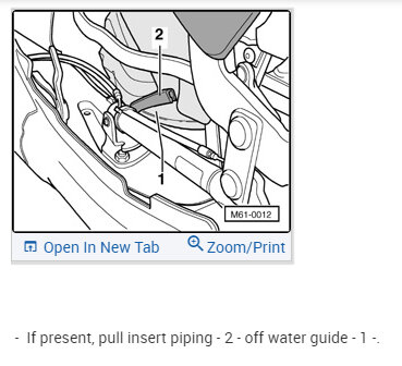

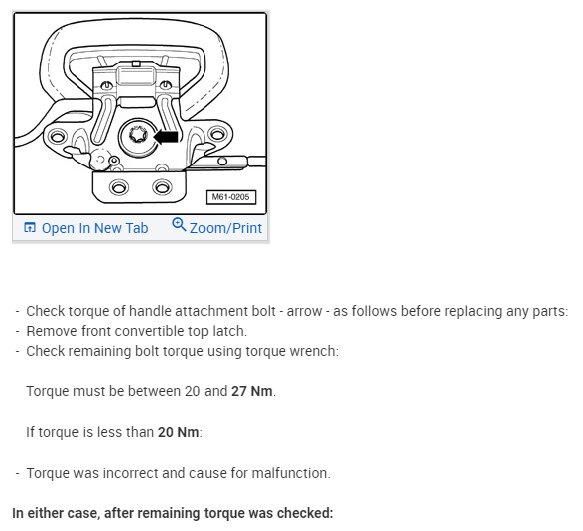

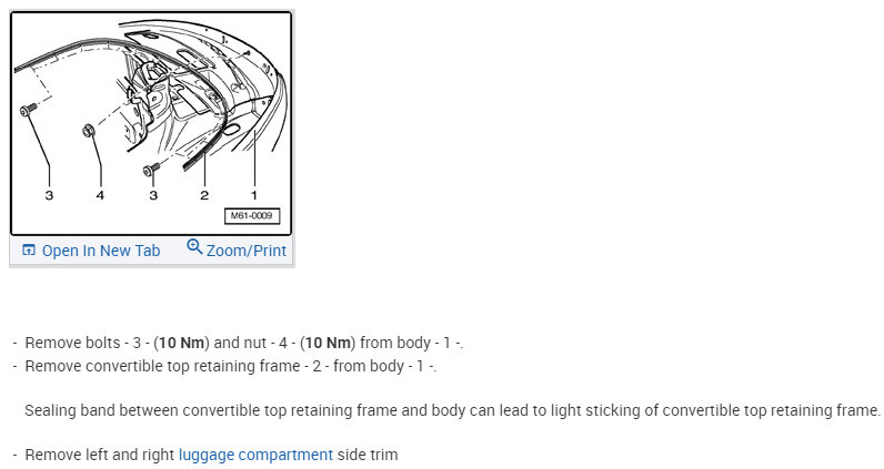

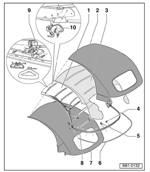

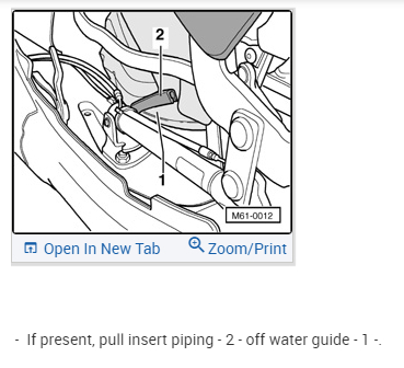

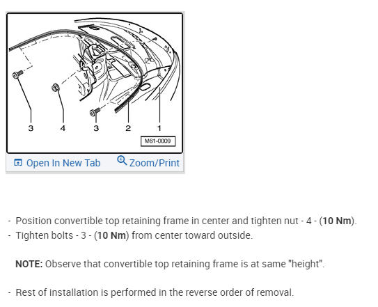

No problem whatsoever. If you look below, I attached the three things you requested. I hope this helps. Take a look through them and let me know if you have questions.
