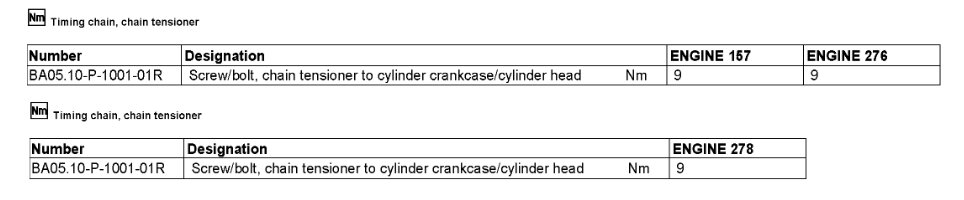

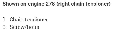

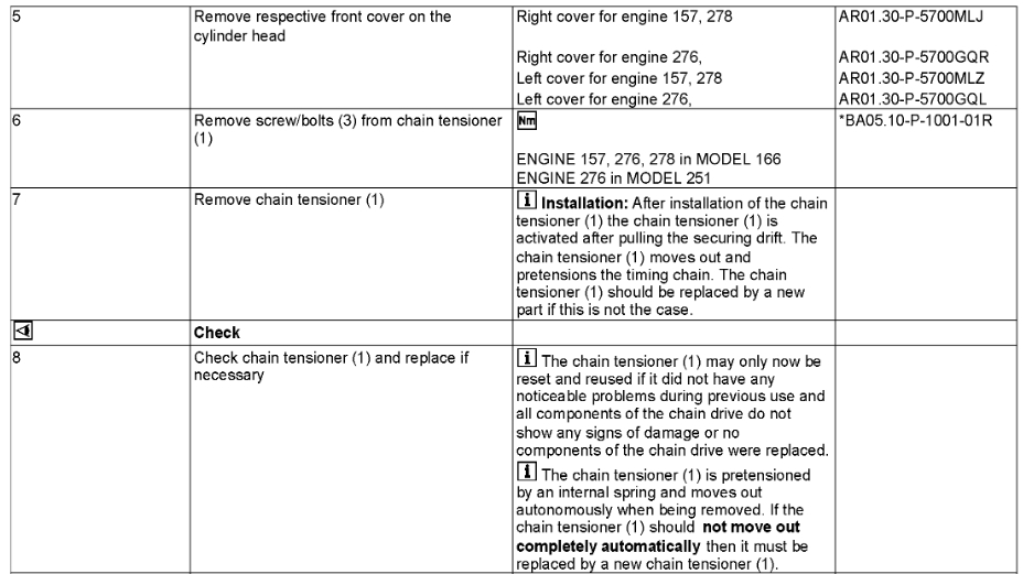

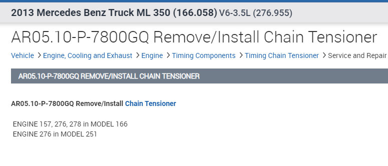

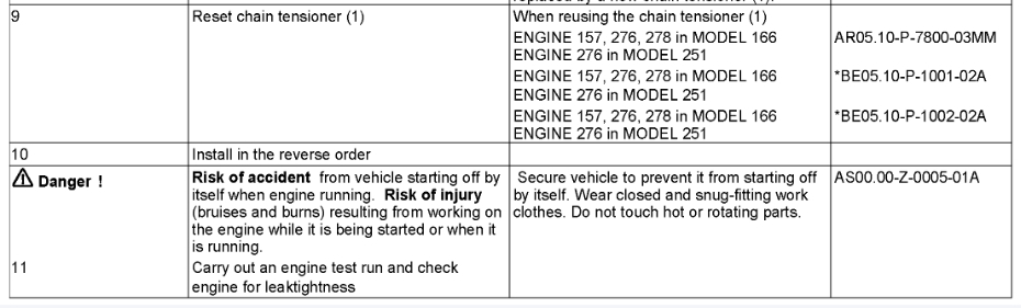

How to replace the chain tensioner?
2014 MERCEDES BENZ ML350
127,000 MILES • 6 CYL • 2WD • AUTOMATIC
BHAMDOC1973
  • 2,007 POSTS

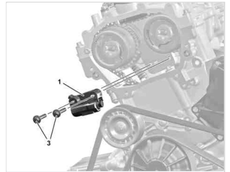

Any instructions on how to replace the tensioner?
Jul 8, 2023 at 7:52 AM
  • 110,244 POSTS

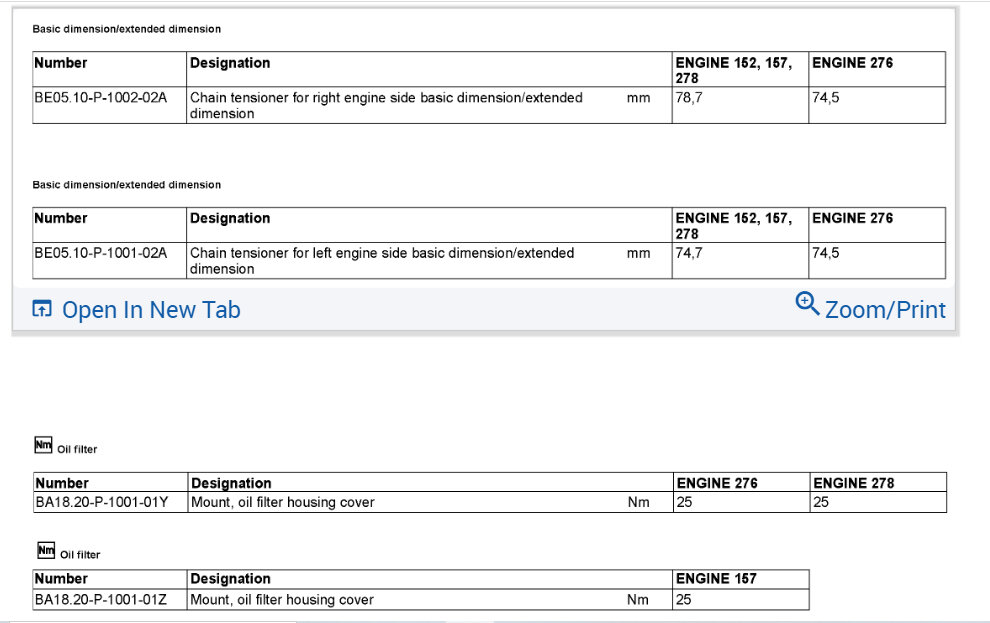

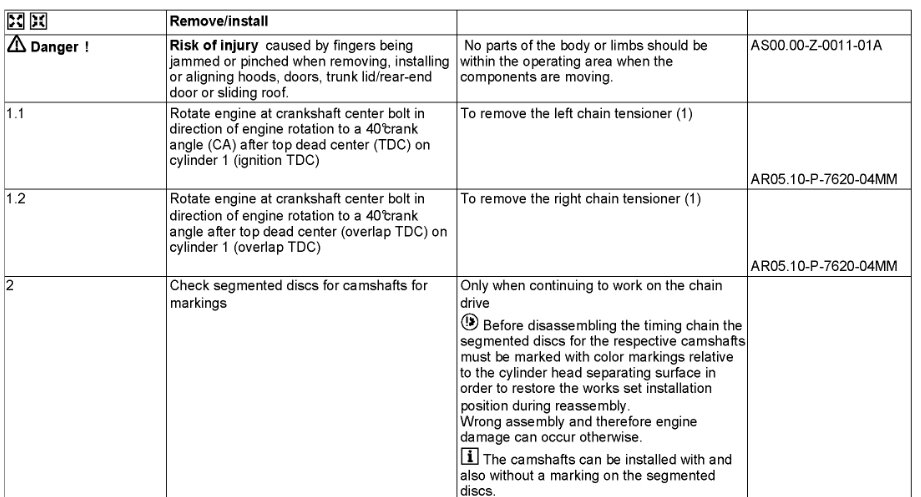

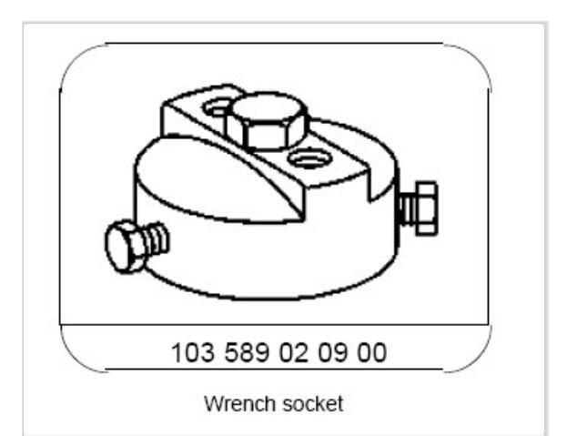

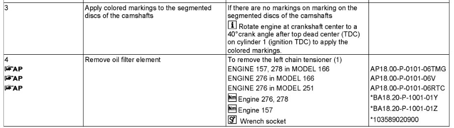

I attached the directions below for replacing the timing chain tensioner. If it is something other that you need, let me know.
Take a look through the directions and let me know if you have questions. I hope this helps.
