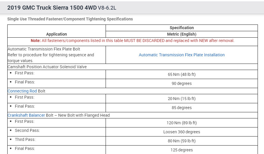

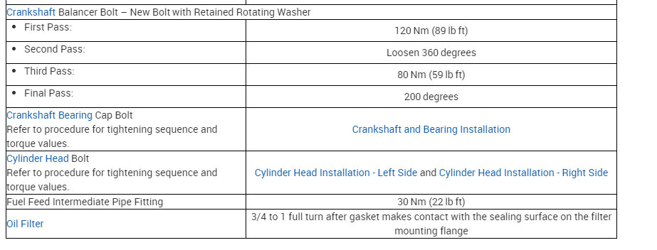

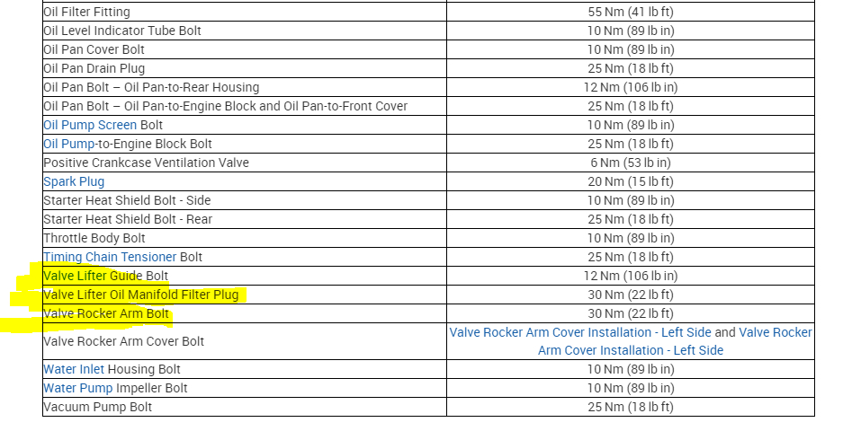

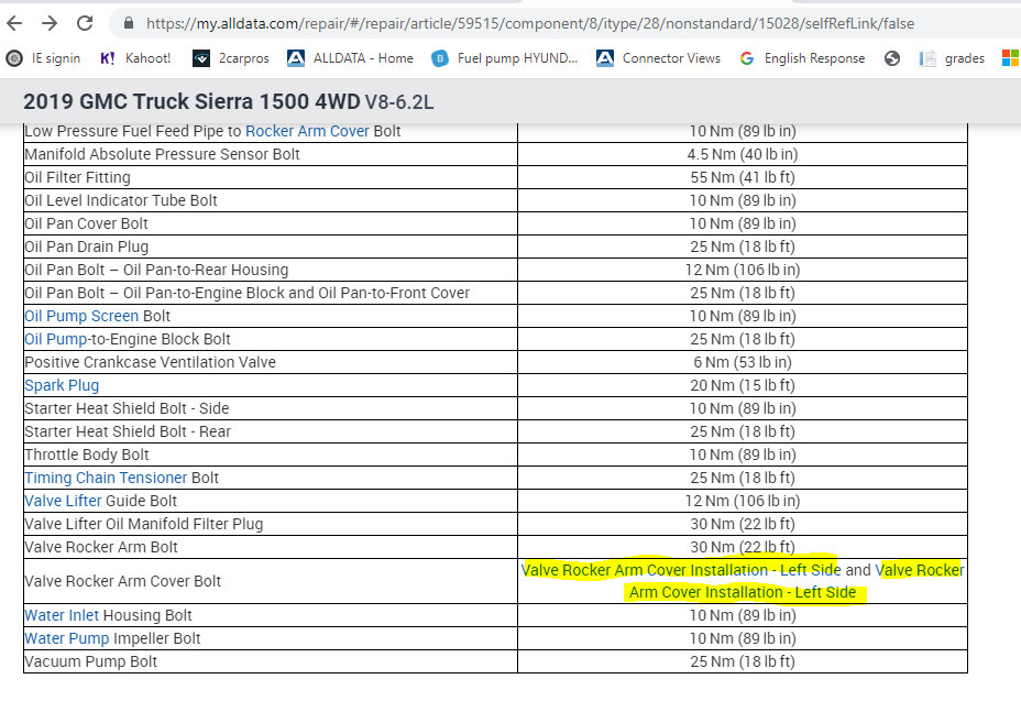

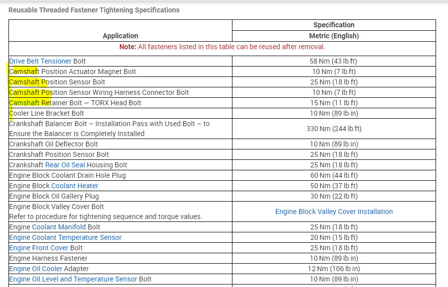

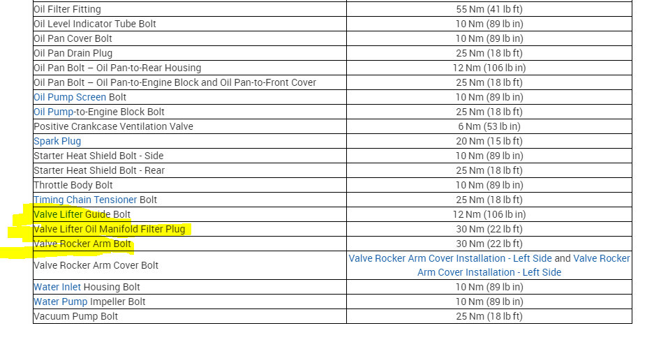

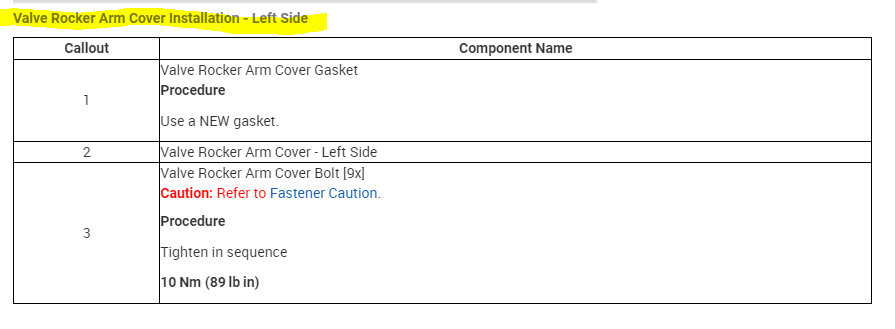

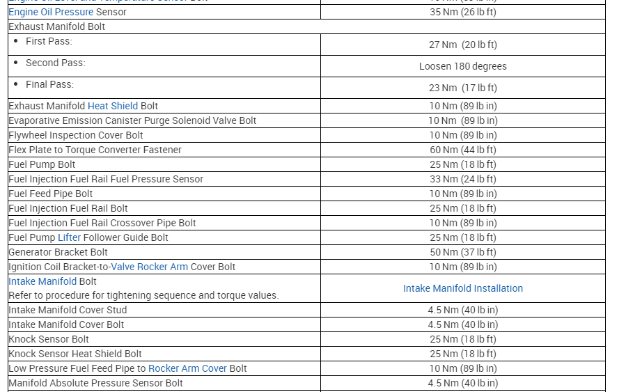

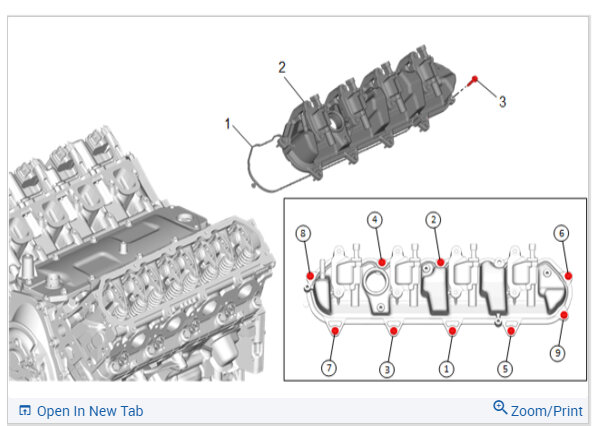

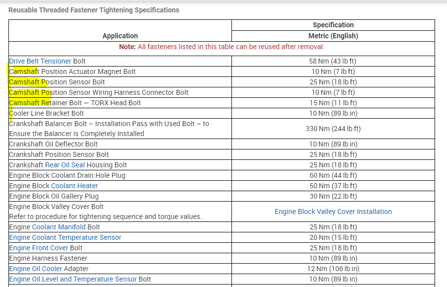

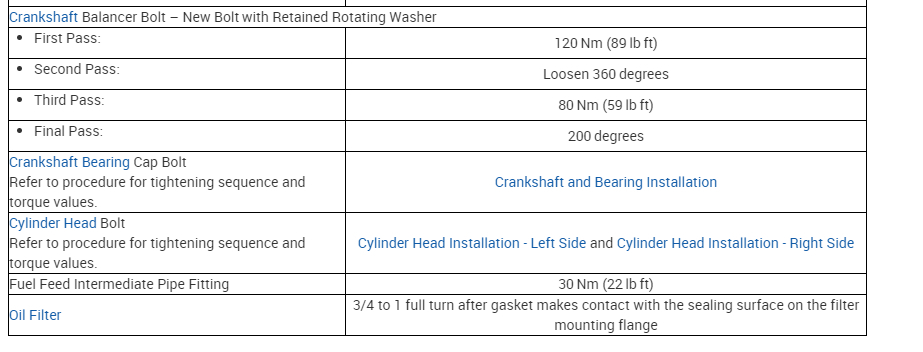

Having a difficult time finding all the torque specifications needed for reassembly. Cam phaser bolt oil pump bolts, cylinder head bolts, rocker arm bolts.
Dec 29, 2022 at 11:13 AM
  • 110,240 POSTS

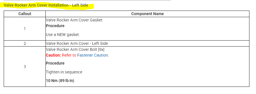

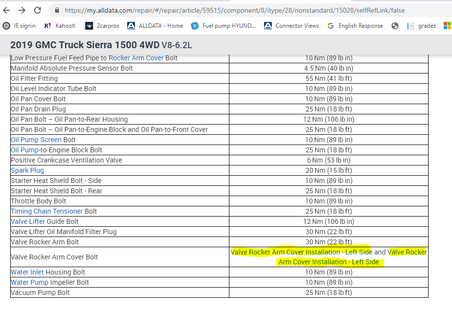

The torque specs are listed based on components. For example, cylinder heads, rod bearings, and so on.
If you look below, I attached a few pics. They are the torque specs for everything on the engine. Take a look through them and let me know if there is anything missing that you need.
Also, pay attention to some. They are listed in inch-pounds and not foot-pounds.
Let me know if this helps.
joe

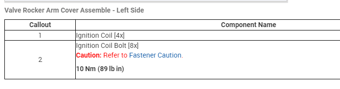

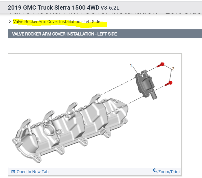

See pics below. Note: The first 4 pics are for the valve covers.
