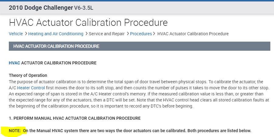

Once replaced do i need a calibration done on them.

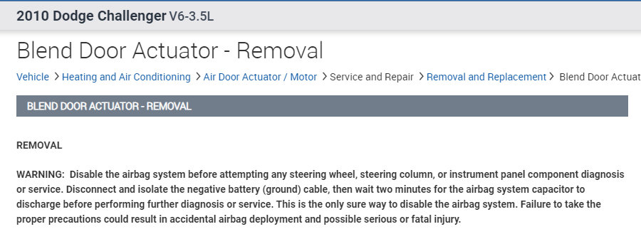

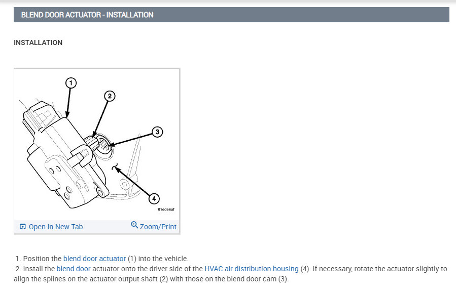

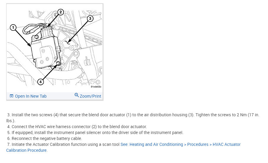

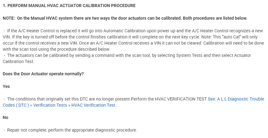

Do you have dual climate control? Everything I'm finding indicates there is one blend air door actuator. You indicated hearing two making noise. What is done to cause the noise or stop it?
Keep in mind, there is a mode door actuator and a fresh air door actuator. One of these could be making noise.

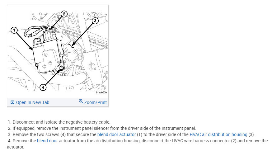

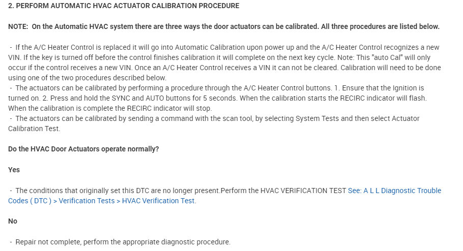

I attached the directions for replacing the blend door actuator below and recalibration. Let me know if that helps. Also, let me know if airflow direction or fresh/recirculate operation is normal.
Let me know if this helps.

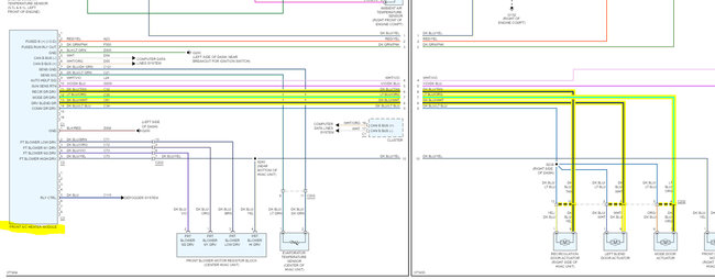

There isn't one fuse that can be removed for each actuator. Power is sent via the front AC/Heater module. If you remove the fuse powering the module, nothing will work. See pic below
Are you able to feel the actuator vibrating when this happens?

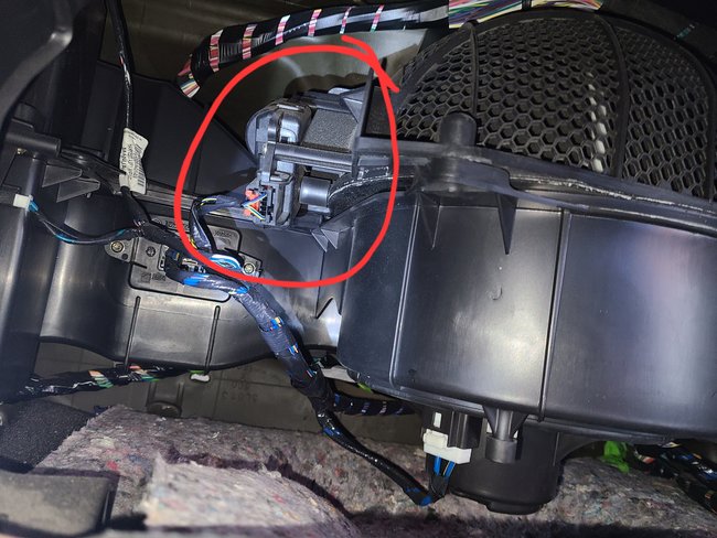

Once the battery is 100% I will hook it back up to the car and check if i can feel the vibration. i ordered two actuators just in case. Today I'll be removing the passenger side panels to locate that actuator and then I'll take apart the driver's side and locate that one as well.
i think only the Blend Door and the Mode door actuator are faulty.
Sep 21, 2022 at 2:55 PM

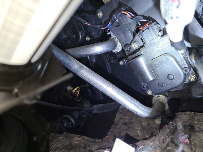

LEMONCAR
  • 36 POSTS

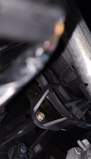

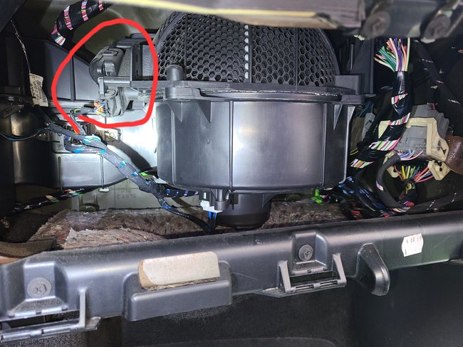

heres a picture of the passenger side actuator. i am hoping to only find 1 on the driver side will post pictures.
Sep 22, 2022 at 3:28 AM
LEMONCAR
  • 36 POSTS

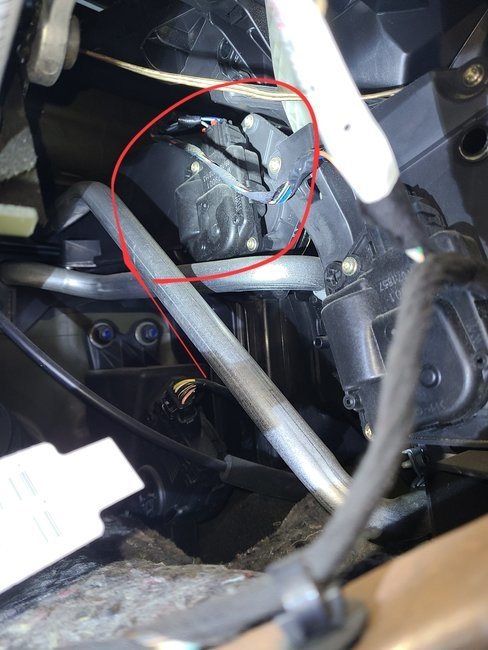

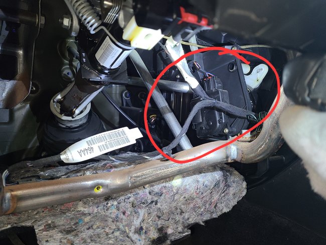

The driver side has two. I'll have to order another actuator.
Sep 22, 2022 at 4:35 AM
  • 110,248 POSTS
Do you have dual climate control? The manual doesn't show one for this vehicle. The third one you found could be the fresh air actuator.

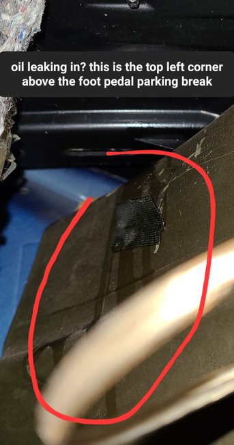

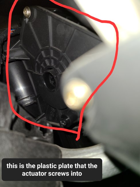

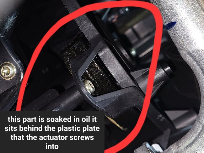

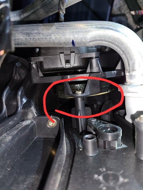

when i was removing the upper actuator on the driver's side i noticed some part that sits behind a plastic plate which the actuator screws into soaked in oil. Also, to the top left corner above the foot pedal parking brake evidence of oil dripping in. hopefully nothing serious and i can take that plastic plate off to get a better look.
Sep 22, 2022 at 6:29 PM
LEMONCAR
  • 36 POSTS
Bad news, that oil leakage is more than likely coming from the A/C compressor. one thing after another with this car. if i let it run dry that compressor is $800.00 (Canadian) and I will be replacing it myself if i can order it to save me some money. how do i fill / top up my a/c compressor oil?
