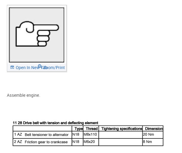

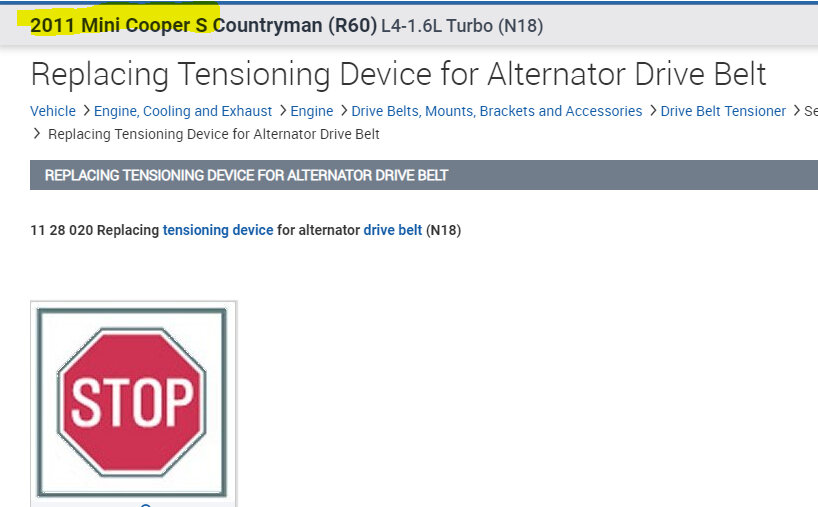

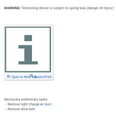

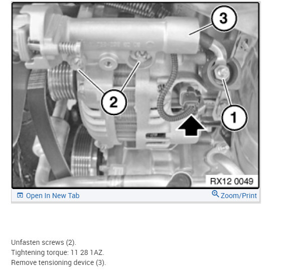

This isn't too difficult of a job, but it takes a little time. As far as the tensioner itself is concerned, I attached the directions for replacement specific to your vehicle.

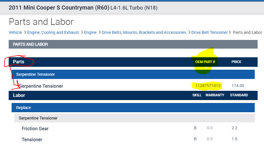

Additionally, the last pic below provides the parts and labor information. I highlighted the OEM part number for you. Chances are you can find an aftermarket part for less money.
Let me know if this helps or if you have questions.
