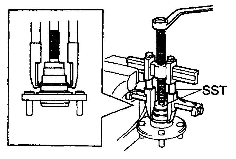

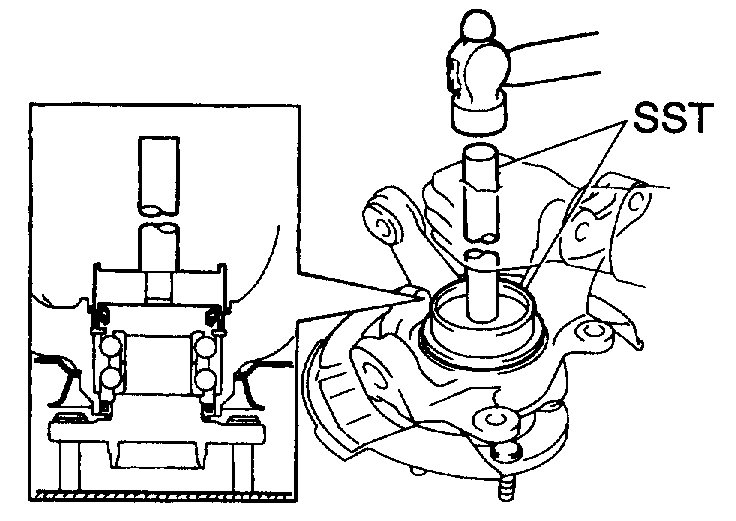

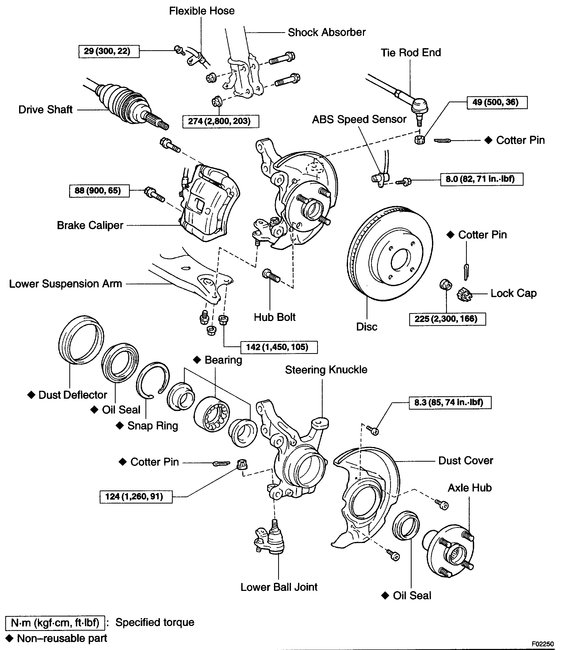

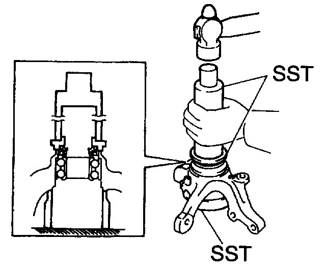

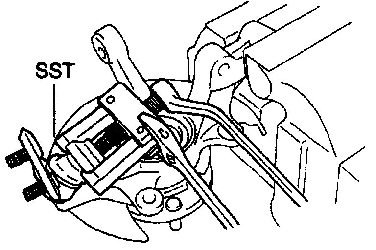

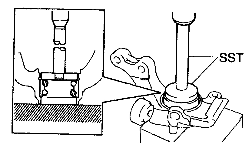

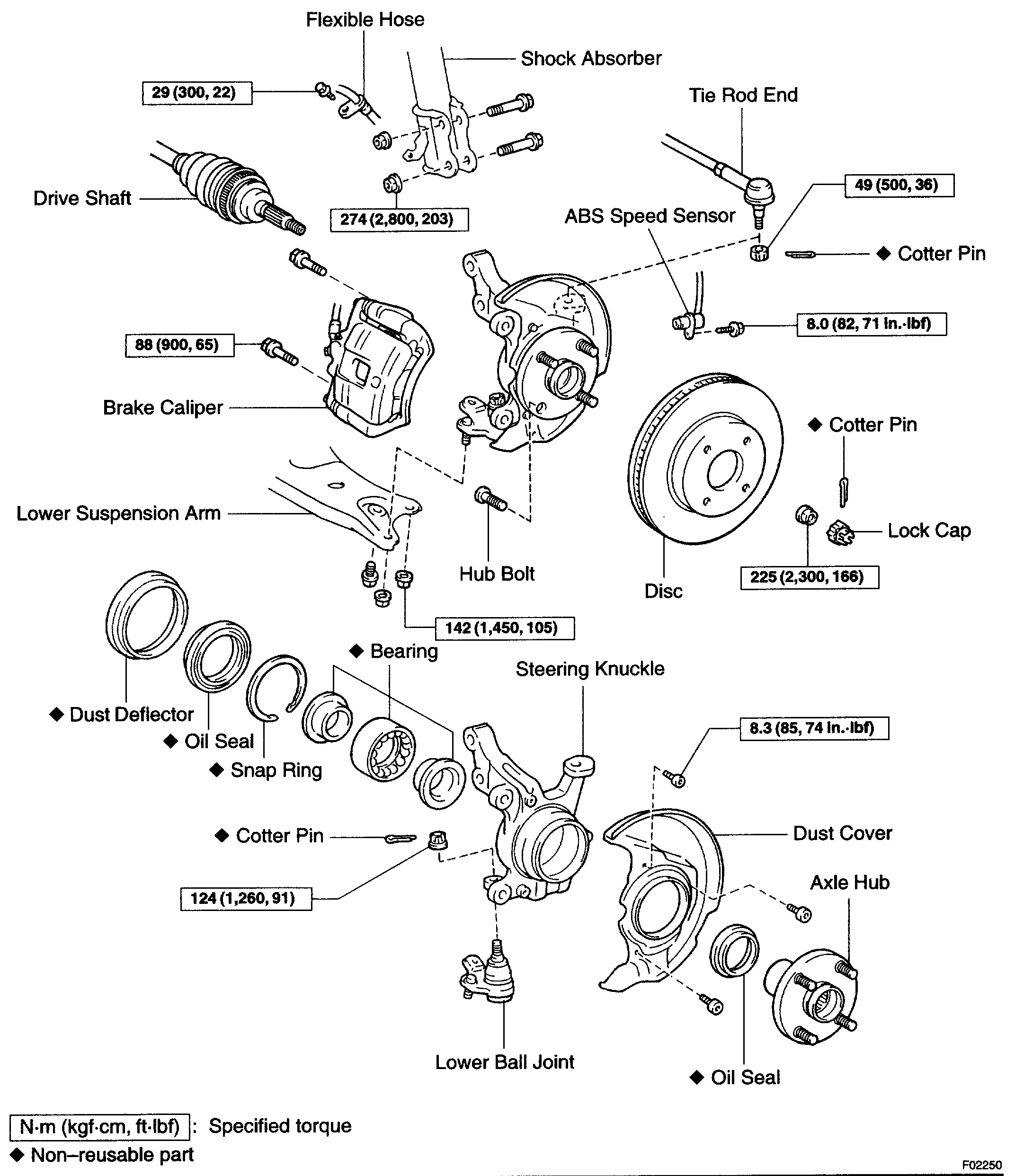

Do I remove CV axle to repair the bearings?
Nov 17, 2018 at 4:22 AM
  • 110,244 POSTS
The front wheel bearings on this vehicle are not the simple type to replace. Yes, the axle will need removed as will the steering knuckle. Here are the directions specific to your vehicle for replacement. All attached pictures correlate with these directions.
_____________________________________
DISASSEMBLY AND REASSEMBLY
DISASSEMBLY

2. REMOVE LOWER BALL JOINT
a. Remove the cotter pin and nut.
b. Using SST, remove the lower ball joint.
SST 09628-62011

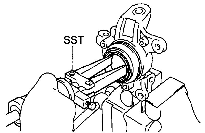

3. REMOVE INNER OIL SEAL
Using SST, remove the inner oil seal.
SST 09308-00010

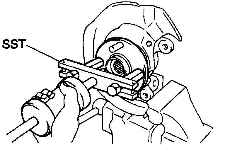

5. REMOVE AXLE HUB
a. Using SST, remove the axle hub.
SST 09520-00031 (09520-00040, 09521-00010, 09521-00020)
b. Remove the inner race (inside).
c. Using SST, remove the inner race (outside) from the axle hub.
SST 09950-40011 (09951-04020, 09952-04010, 09953-04030, 09954-04010, 09955-04061, 09957-04010, 09958-04011), 09950-60010 (09951-00360)

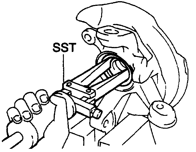

7. REMOVE OUTER OIL SEAL
Using SST, remove the outer oil seal.
SST 09300-00010

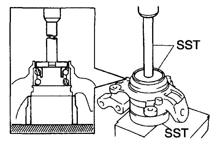

8. REMOVE BEARING FROM STEERING KNUCKLE
a. Place the inner race (outside) on the bearing.
b. Using SST and a press, remove the bearing from the steering knuckle.
SST 09527-17011, 09950-60010 (09951-00650), 09950-70010 (09951-07150)

1. INSTALL BEARING
a. Remove the inner races from a new bearing.
b. Using SST and a press, install the bearing to the steering knuckle.
SST 09950-60020 (09951-00710), 09950-70010 (09951-07150)
c. Install the inner races.
NOTICE: If the inner race and balls become loose and come out from the bearing outer race, make sure to install them on the same side as before.
2. INSTALL OUTER OIL SEAL
a. Using SST and a hammer, install a new outer oil seal.
SST 09316-60011 (09316-00011, 09316-00061), 09527-17011
b. Coat MP grease to the oil seal lip.

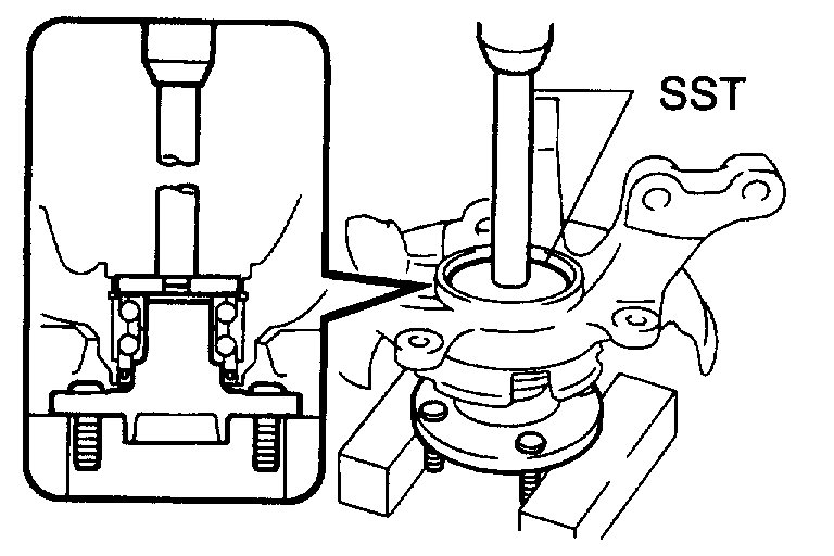

4. INSTALL AXLE HUB
Using SST and a press, install the axle hub.
SST 09950-60010 (09951-00650), 09950-70010 (09951-07150)

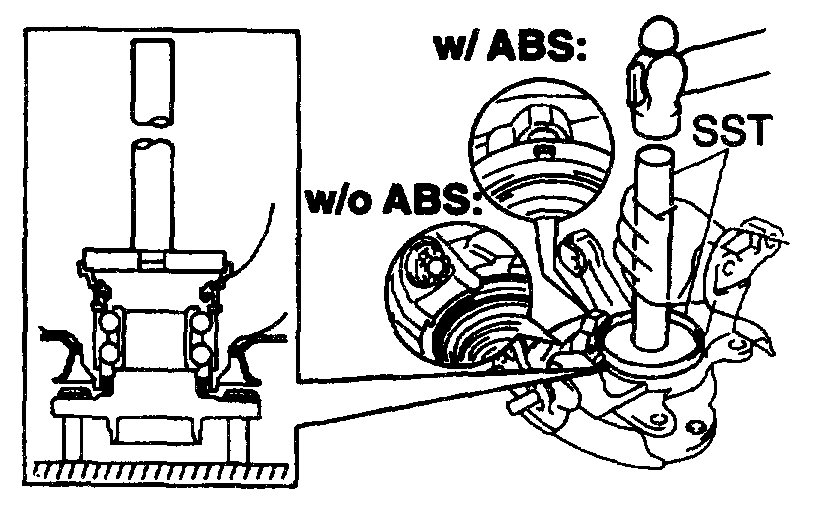

6. INSTALL INNER OIL SEAL
a. Using SST and a hammer, install a new inner oil seal.
SST 09608-32010, 09950-70010 (09951-07150)
b. Coat IMP grease to the oil seal lip.

8. INSTALL DUST DEFLECTOR
Using SST and a hammer, install a new dust deflector.
SST 09950-60020 (09951-00890), 09950-70010 (09951-07150)
HINT: Align the hole for the ABS speed sensor in the dust deflector with the one in the steering knuckle.

Let me know if this helps.
