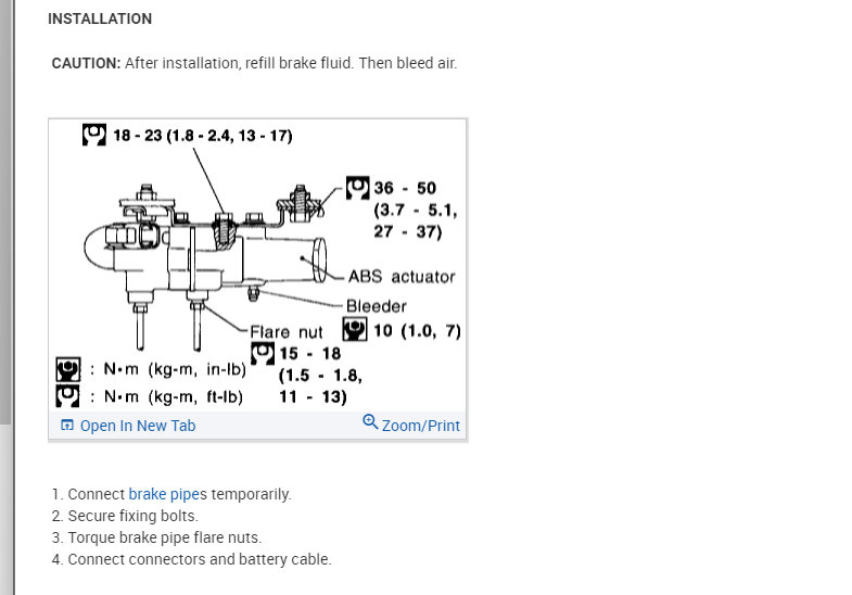

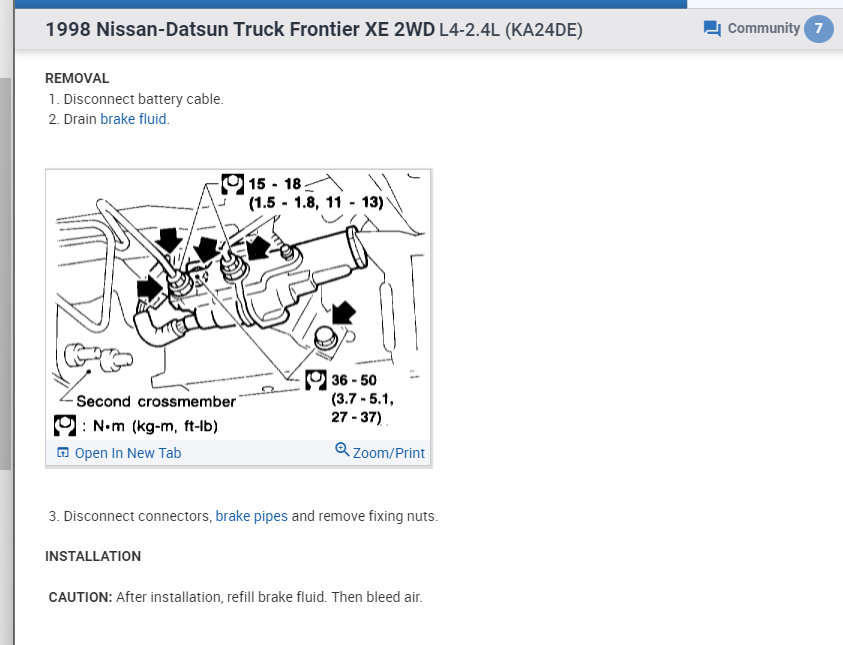

I want to change the anti lock brake pump motor Any advice will be helpful
Apr 7, 2016 at 6:13 AM
No problem. I will attach all the info below on how to replace this also here is a guide that will help with this as well:
https://www.2carpros.com/articles/how-to-replace-a-abs-controller
After running through this guide please review the specific steps from the manual that will give what you need to complete this including torque specs.
Please let us know what other questions you have. Thanks
