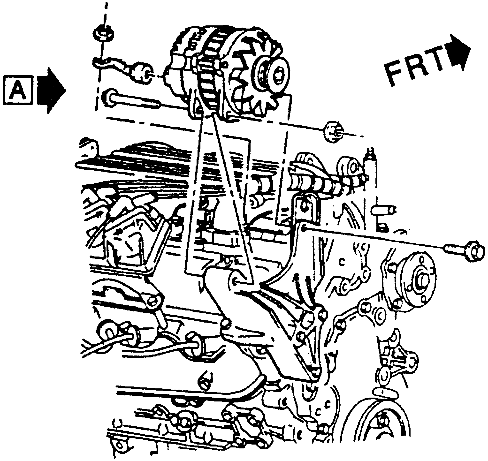

Here is a link that shows in general how to replace an alternator:
https://www.2carpros.com/articles/how-to-replace-an-alternator
Here are the directions specific to your vehicle. The attached picture correlates with these directions.
___________________________________
ALTERNATOR ASSEMBLY REPLACEMENT
Fig. 5 Alternator Removal
1. Disconnect battery ground cable.
2. Disconnect alternator electrical connectors.
3. Remove serpentine drive belt.
4. Remove alternator mounting bolts, Fig.5 .
5. Disconnect alternator air inlet connector.
6. Remove alternator.
7. Reverse procedure to install.
