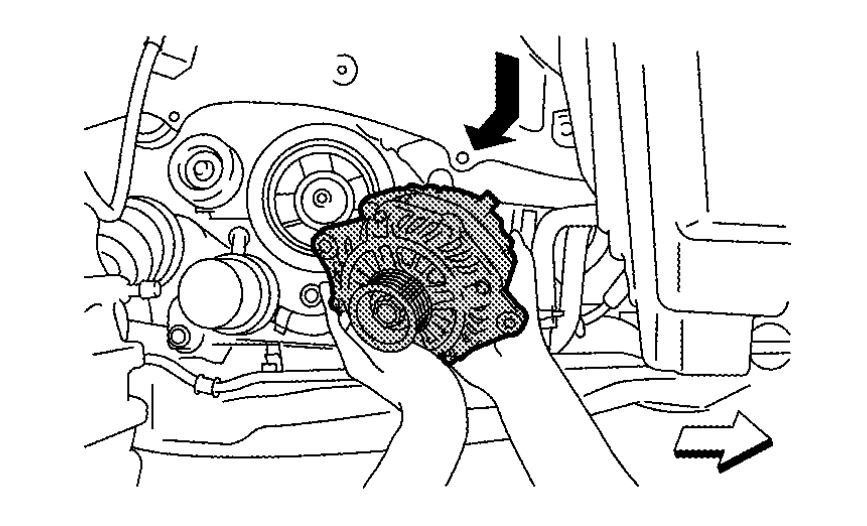

We are trying to replace the alternator in the van listed above. We are having trouble trying not to drop the air compressor. Is it possible to do the replacement and if so how exactly? Thank you
Jun 12, 2020 at 7:35 AM
Good evening,
There is no way to remove it without dropping the compressor. I have tried this many times and had no success.
It must be released to drop the alternator.

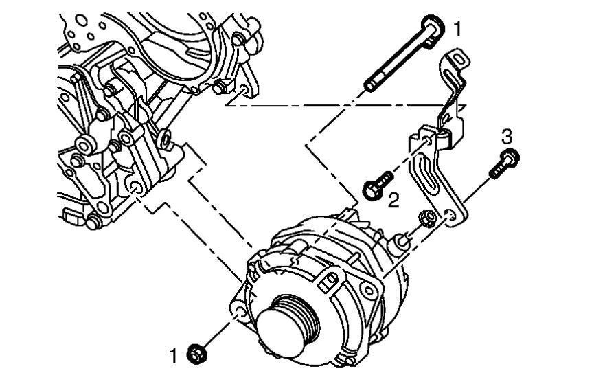

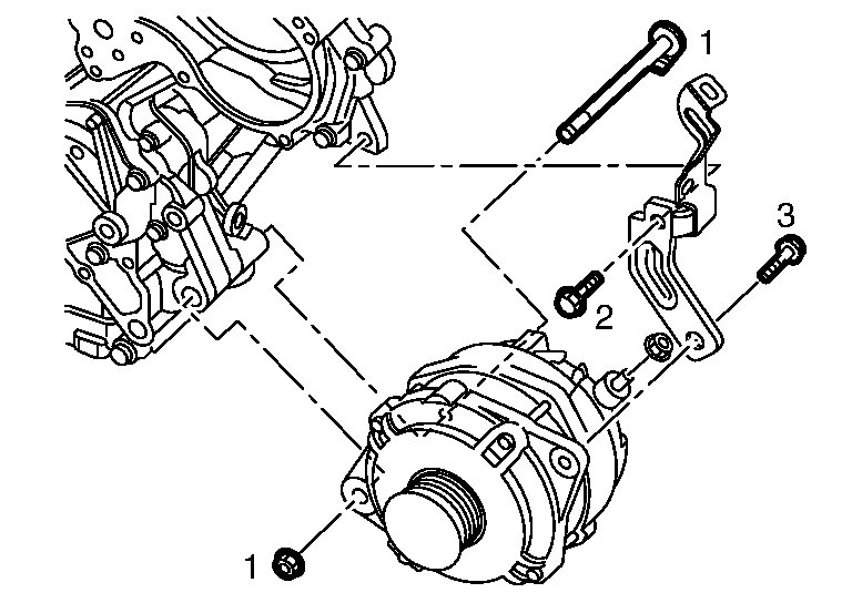

Replacing it isn't too bad. You will need to remove the fresh air duct and the coolant reservoir. Here is a guide to help you step by step with instructions in the diagrams below to show you how on your car. Check out the diagrams (Below).
https://www.2carpros.com/articles/how-to-replace-an-alternator
Here are the directions specific to your vehicle. The attached pics correlate with the directions. Before starting, make sure the battery is disconnected.

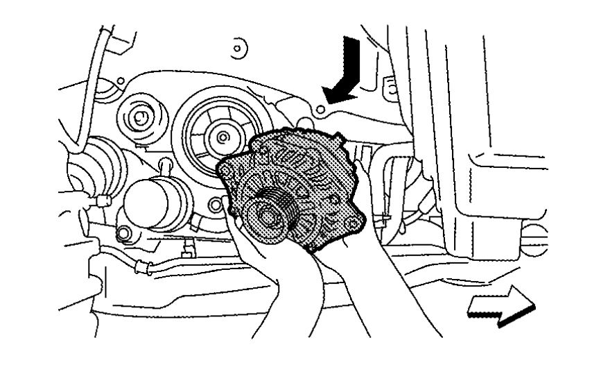

15. Remove alternator mounting bolt (lower) and alternator mounting nut (lower).
White Arrow Indicates Vehicle front

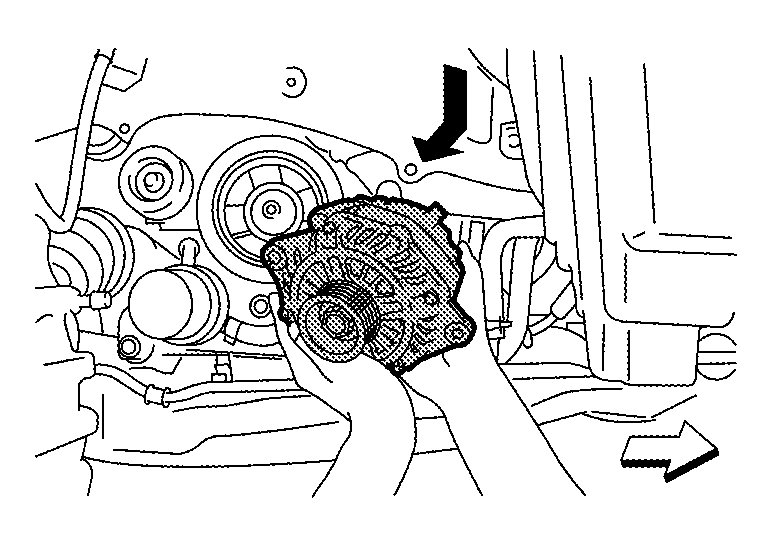

16. Remove alternator from the right side of the vehicle.
CAUTION:
Be careful not to contact with and damage surrounding parts when removing alternator from the vehicle.
INSTALLATION
Note the following items, and then install in the reverse order of removal.
CAUTION:
Temporarily tighten all of alternator bolts and nut. And then tighten them in numerical order shown in the figure.
- Install alternator, and check tension of belt. See: Drive Belt > Procedures > Checking Drive Belt.
- Be careful to tighten "B" terminal nut carefully.
- For this model, the power generation voltage variable control system that controls the power generation voltage of the alternator has been adopted. Therefore, the power generation voltage variable control system operation inspection should be performed after replacing the alternator, and then make sure that the system operates normally. See: Charging System > Initial Inspection and Diagnostic Overview > Inspection Procedure.

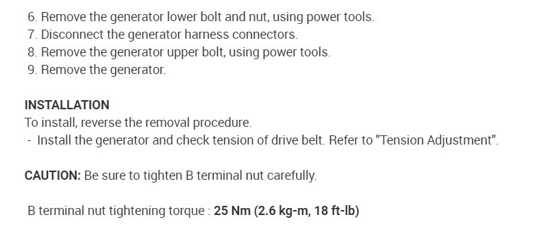

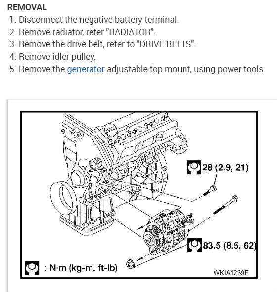

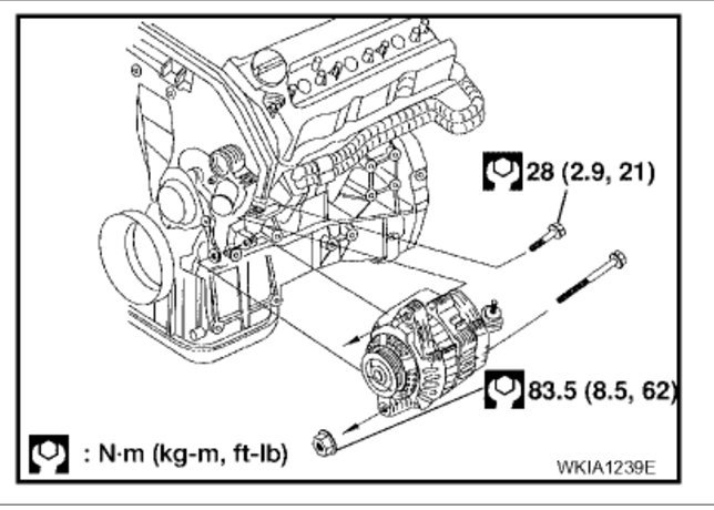

Can anyone tell me how to remove and replace a alternator on a 2005 Nissan quest van. Like What tools are needed and a step by step guide on removing and installing a new one? Also I'm not sure if this matters or not but the alternator on my quest is located on the passenger side.
Thanks
May 13, 2021 at 5:27 AM (Merged)
  • 110,241 POSTS
You have to remove the alternator from the top, meaning you need to take out the radiator and fans as well as the battery tray etc.
Here is a guide and diagrams below to help you see what it will be like for your car.
First, open the hood. Disconnect the battery starting with the negative terminal. Next, lift the front end of the Quest and safely prop the vehicle on jack stands. Once the battery is disconnected and the front end safely lifted and secured, remove the plastic cover under the vehicle that is covering the engine area.
It will require a ratchet and socket. Once that is removed, Locate the alternator, loosen the idler pulley adjusting bolt. Unplug the electrical connections on the alternator. Using a ratchet and socket, loosen the bolts holding the alt in place. Pivot the alternator so the belt can be removed.
Unbolt the alternator the rest of the way from the engine block using a ratchet and socket. Once all bolts are removed, carefully remove the alternator from the vehicle.
Cheers
