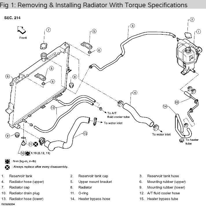

Hi I just recently purchased this vehicle and I am swapping out the radiator with a csf all aluminum one. I want to replace all the rubber hoses in the cooling system since I will be under the hood. I am not sure how many rubber hoses have coolant running through them and I am unfamiliar with there names. So my question is, how many hoses are there in my vehicle that i need to replace along with there names? Any answers are much appreciated. Thanks.

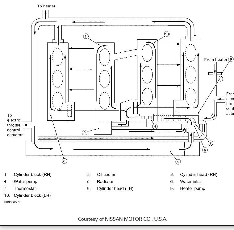

see pictures both have names on them and one is more explicit than other one. This should help you.
