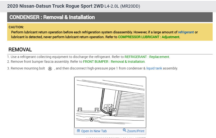

I want to know if a specific A/C condenser will work with my vehicle listed above Sport model. If not, which one I can use?
Jun 1, 2023 at 10:24 AM
  • 110,194 POSTS

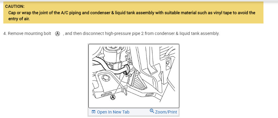

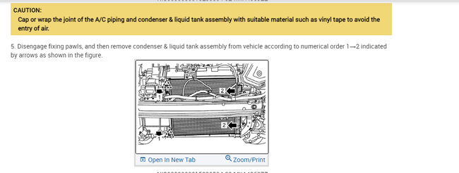

You need to use the one designed for this vehicle. The original equipment part number is 921004BE0B. You should be able to find an aftermarket condenser for much less money. However, it has to be designed to replace the part number I attached above.
I don't know if you need them, but I attached the directions for replacing it.
Let me know if this helps or if you have questions.
