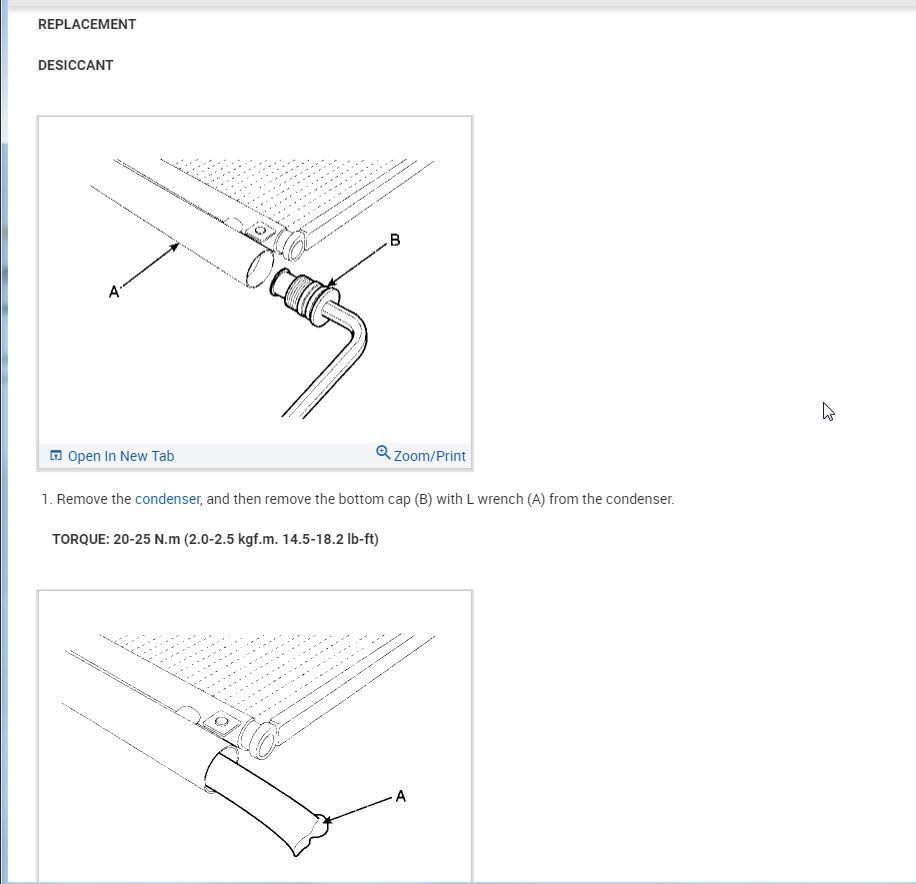

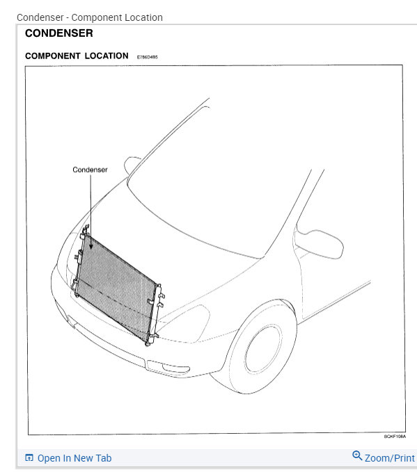

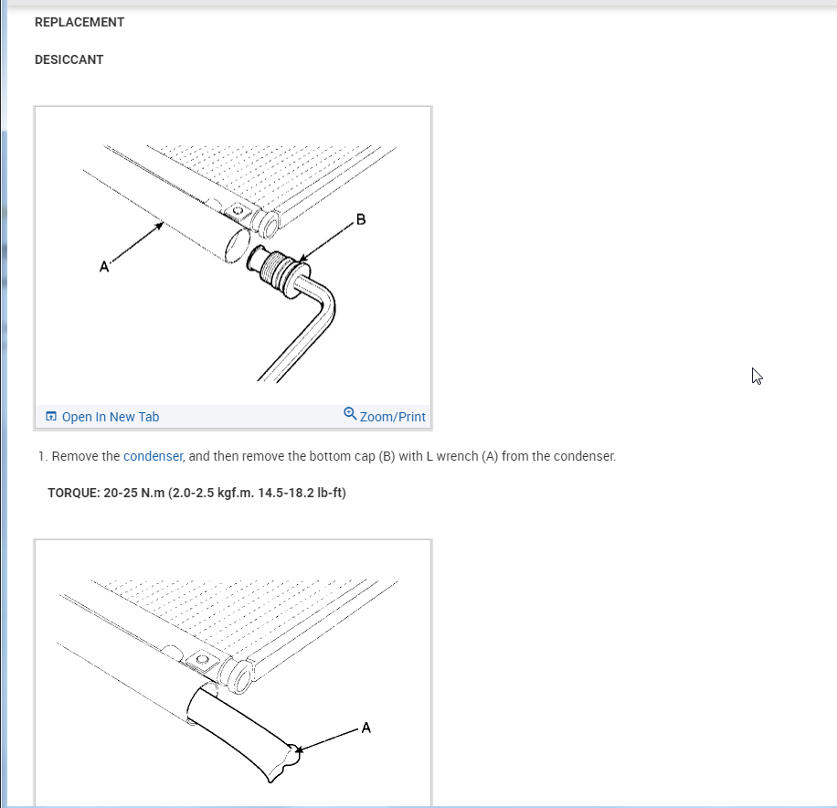

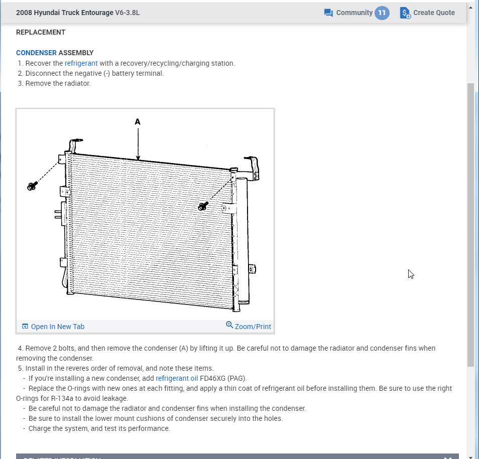

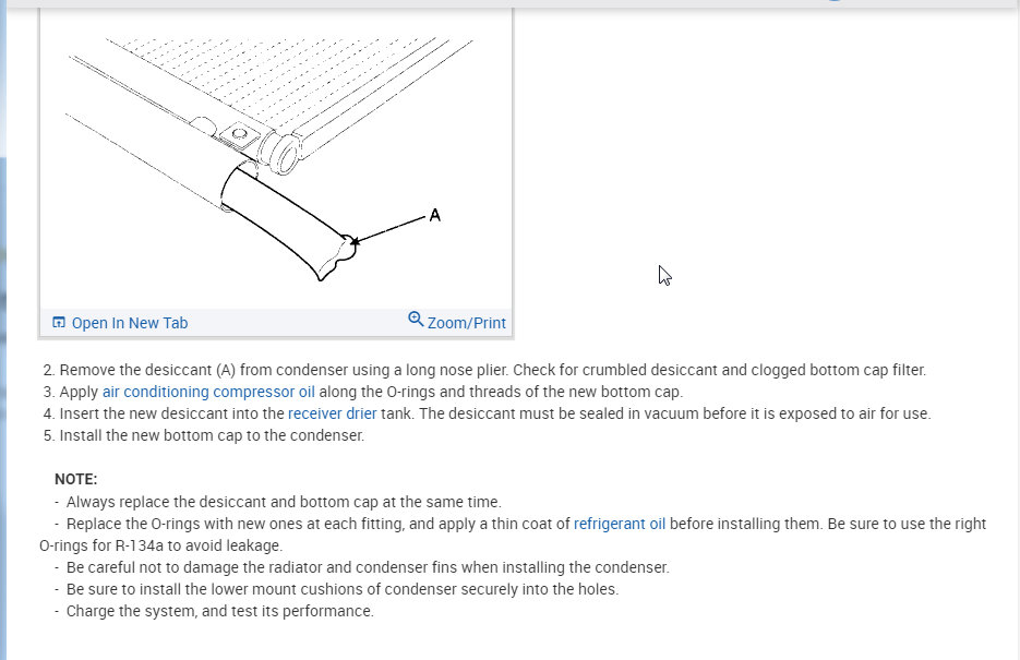

Instructions on replacing a leaky condenser on these cars? 3.8L.
May 25, 2020 at 1:24 PM
Here is the process for the condenser and desiccant. The new condenser should come with this but just check and make sure.
Let me know if you have questions with this. Thanks
