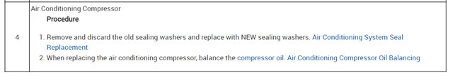

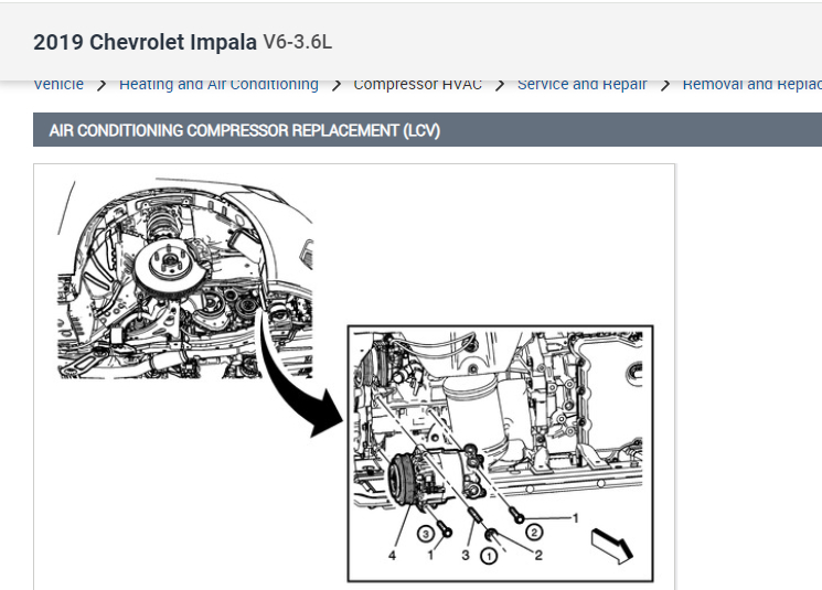

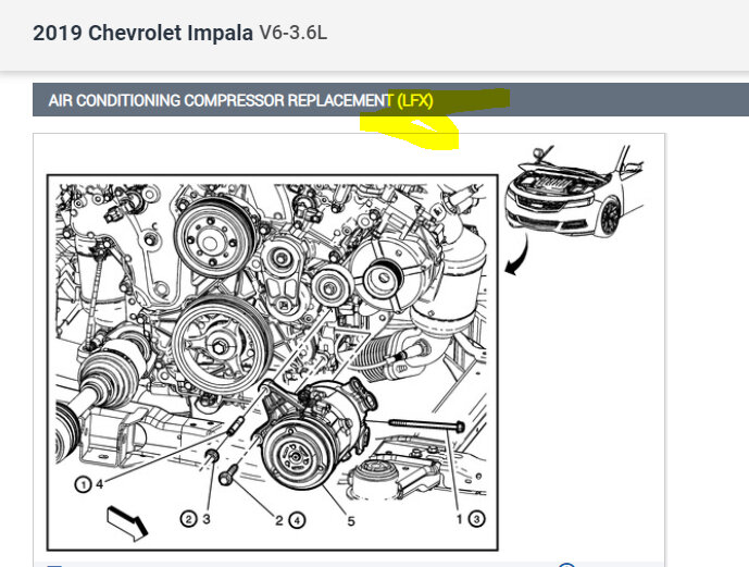

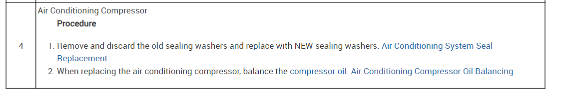

Bad A/C compressor, need to replace part. I'm not too sure on the procedure but I do know I need to drain and move some stuff in the engine bay out the way. I could use some advice, like do’s and don'ts.
Feb 19, 2024 at 2:18 PM
  • 110,193 POSTS

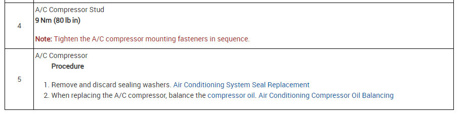

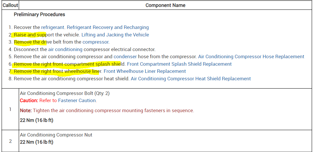

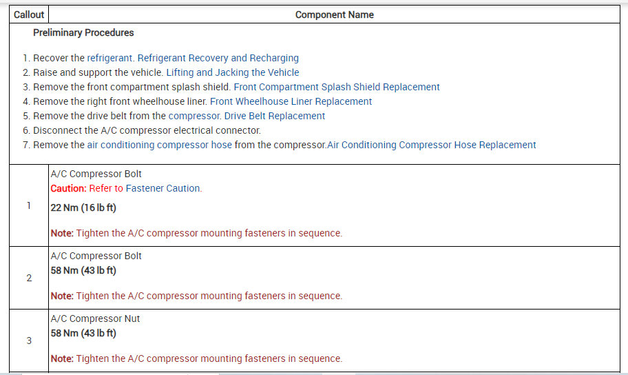

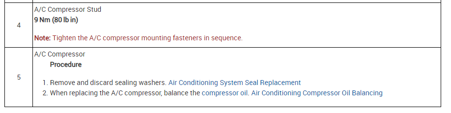

There were two different designs used on this vehicle. I attached the directions from the shop manual for both. However, here is a link that I feel can be more helpful. It helps explain the different things to check.
Also, here is a video that is helpful:
https://www.2carpros.com/articles/replace-air-conditioner-compressor
Let me know if this helps. Note: Regardless of the design used on your vehicle, the right front wheel will need to be removed along with the inner fender.

Thank you, definitely helps. Completed the job today.
