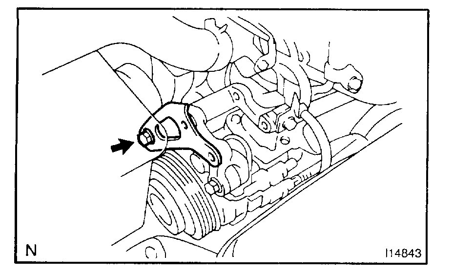

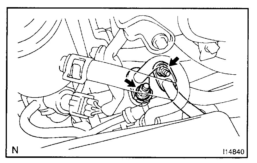

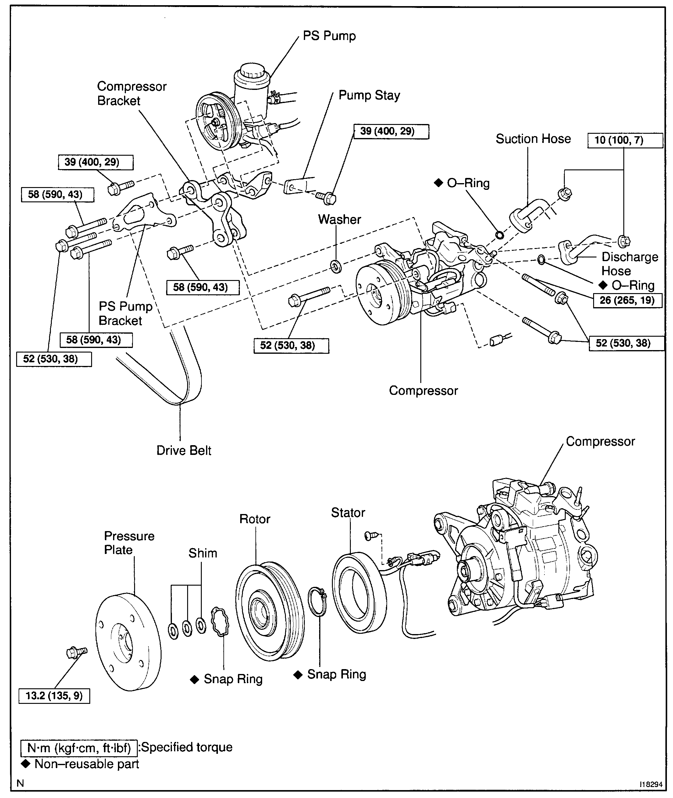

This is a little bit of a job. However, you should be fine doing it. Here are the directions. The attached pics correlate with the directions.

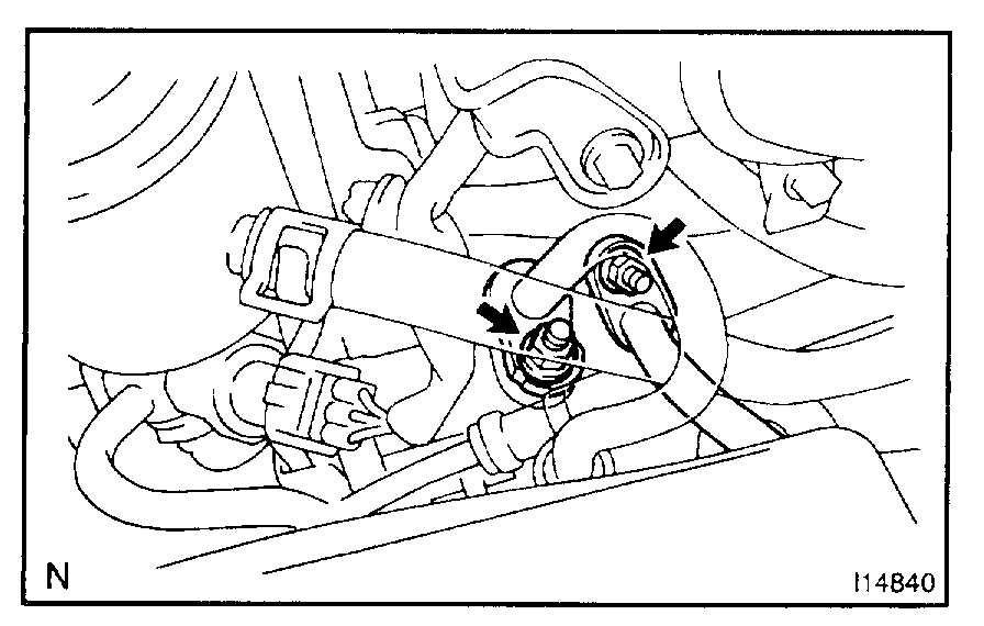

6. DISCONNECT DISCHARGE AND SUCTION HOSES
Remove the 2 nuts and disconnect the both hoses.
NOTE: Cap the open fitting immediately to keep moisture or dirt out of the system.

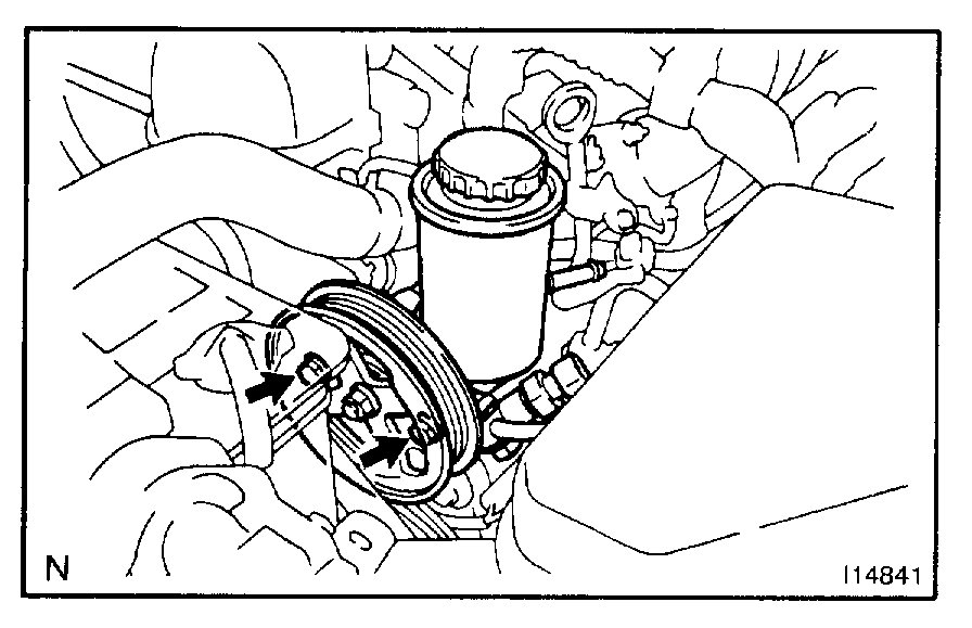

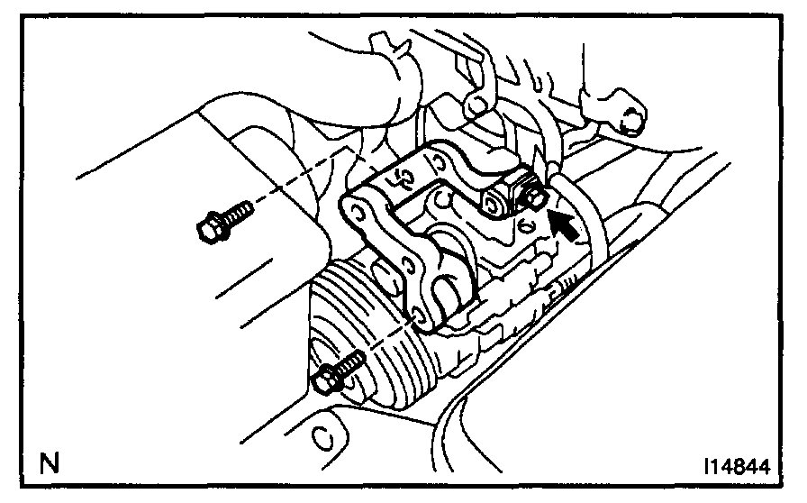

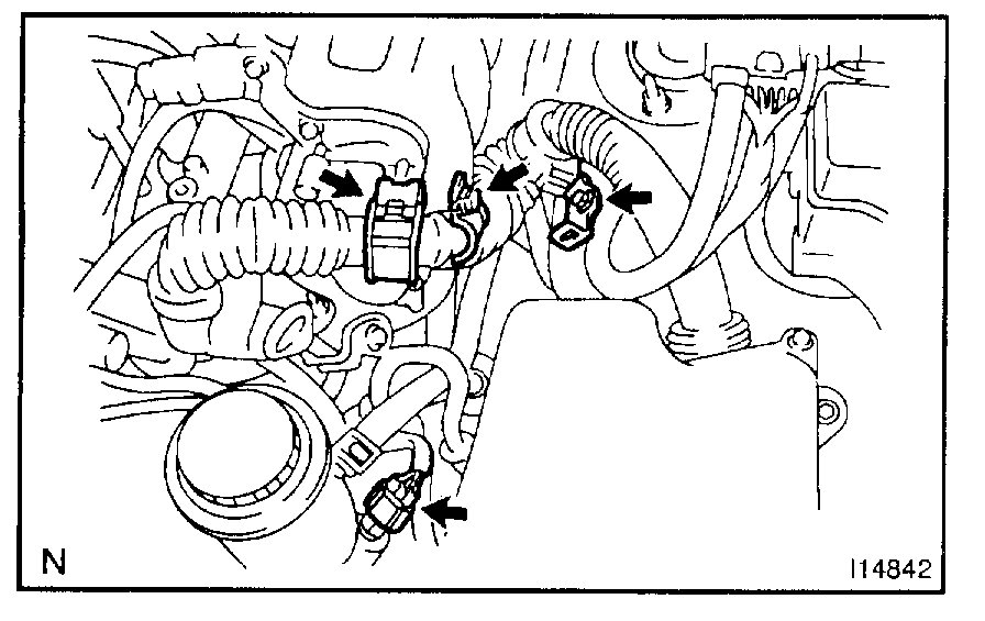

7. REMOVE PS PUMP WITH PRESSURE FEED AND RETURN TUBES STILL CONNECTED
pic 3
a. Disconnect the PS pump connector and PS pump tube clamp.
b. Disconnect the engine wire.
pic 4
c. Remove the 2 PS pump set bolts and slide the PS pump backward.

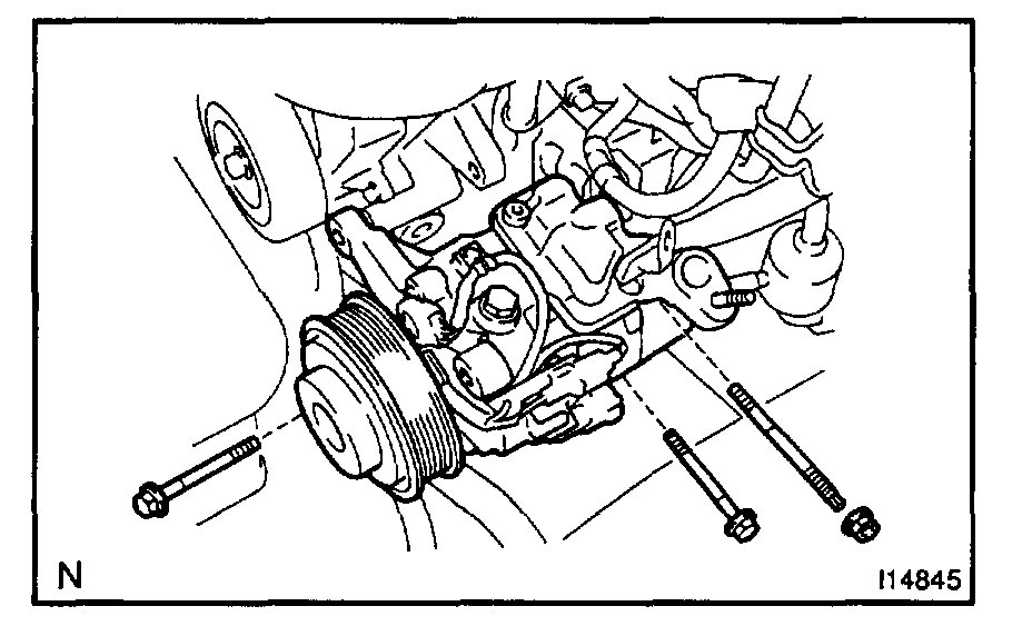

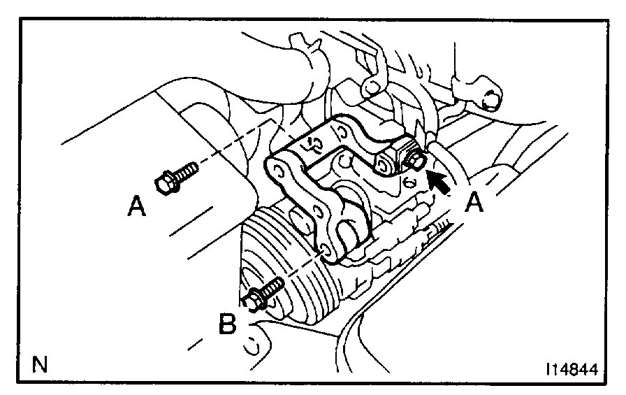

8. REMOVE COMPRESSOR
pic 5
a. Remove the bolt and PS pump bracket.
pic 6
b. Remove the 3 bolts and compressor bracket.
c. Disconnect the connector.
pic 7
d. Remove the nut and 2 bolts.
e. Using a torx socket (E10), remove the stud bolt and compressor.
INSTALLATION
1. INSTALL COMPRESSOR
a. Install the compressor with the stud bolt.
Torque: 26 N.m (265 kgf.cm, 19 ft.lbf)
b. Install the 2 bolts and nut.
Torque:
Bolt: 52 N.m (530 kgf.cm, 38 ft.lbf)
Nut: 52 N.m (530 kgf.cm, 38 ft.lbf)
c. Connect the connector.
pic 8
d. Install the compressor bracket with the 3 bolts.
Torque:
bolt A: 39 N.m (400 kgf.cm, 29 ft.lbf)
bolt B: 52 N.m (530 kgf.cm, 38 ft.lbf)
e. Install the PS pump bracket with the bolt.
Torque: 52 N.m (530 kgf.cm, 38 ft.lbf)
2. INSTALL PS PUMP
a. Install 2 PS pump set bolt.
Torque: 58 N.m (590 kgf.cm, 43 ft.lbf)
b. Connect the engine wire.
c. Connect the PS pump connector and wire harness clamp.
3. CONNECT DISCHARGE AND SUCTION HOSES
Connect the both hoses with 2 nut.
Torque: 10 N.m (100 kgf.cm, 7 ft.lbf)
NOTE: Hose should be connected immediately after the caps have been removed.
HINT: Lubricate 2 new O-rings with compressor oil and install them to the hoses.
