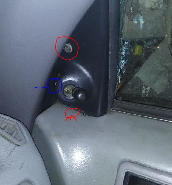

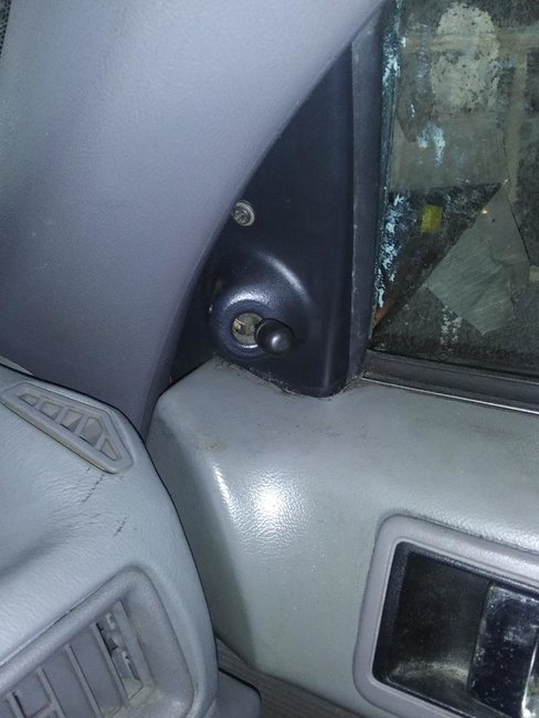

Passengers side mirror broke, it is hanging, and tape will no longer hold it in place. so, I want to take the interior black plate off it. it has one screw holding it but when I take out the screw, I cannot get the plate off, it wiggles a lot but cannot figure what is holding it in place. I hope I do not have to take off the door panel just for that. any suggestions would be appreciated. please see photo. Thanks
PS: also, how to get the tip off the mirror adjustment handle, does it pull off or unscrew?

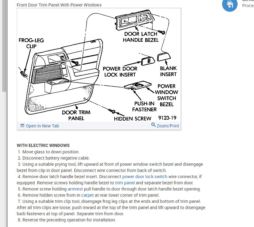

Unfortunately, it does appear that the door panel needs to come off because there is a screw holding that trim piece in place under the panel.
Here is a guide that will help with this:
https://www.2carpros.com/articles/door-panel-removal

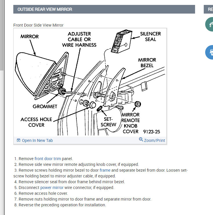

Below you will see the info from the manual that will give the remaining detail.
As for that mirror knob, yes it should just unscrew off the shaft.
Please run through all this and let us know if you are still having issues.
Thanks

As was stated above the trim panel must come off to access the screw, and the studs that hold the mirror on as well. The knob will usually fit through the trim plate on them, but you need to loosen the set screw almost all the way out as the slot in the mirror control that it grabs in for alignment has a step in it to help retain it. Be gentle with the trim as that plastic really likes to break easily.

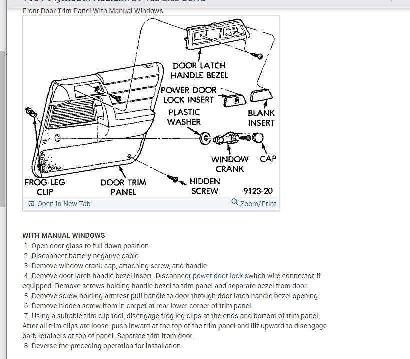

The door panel is not hard to remove, and I would not try to pull it away just enough because it will most likely break some clips or plastic pieces.
Please see the info from the manual below on how to remove the mirror and door panel. It shows all the location bolts.
Also, here is a guide that will help with removing this as well:
Please run through this material and let us know what other questions you have. Thanks

Yes, you do not want to pry on the panel to access the screw, it will crack at the least. You need to remove it because you may get the trim screw out, but you still need to access the other studs that retain the mirror.
Remove all of the screws and trim indicated in the instructions, then starting at the bottom pull out on the trim panel just enough to reach in the gap with a putty knife or similar tool to release the clips from the back of the panel. With those free you now push in and up on the trim panel where it nears the glass, be sure the window is fully down as the trim needs that space to move into to release the upper clips. Once the panel is off you have access to the screws on the smaller trim section. Remove it and the small access cap and you will see the mirror studs under it inside the door.

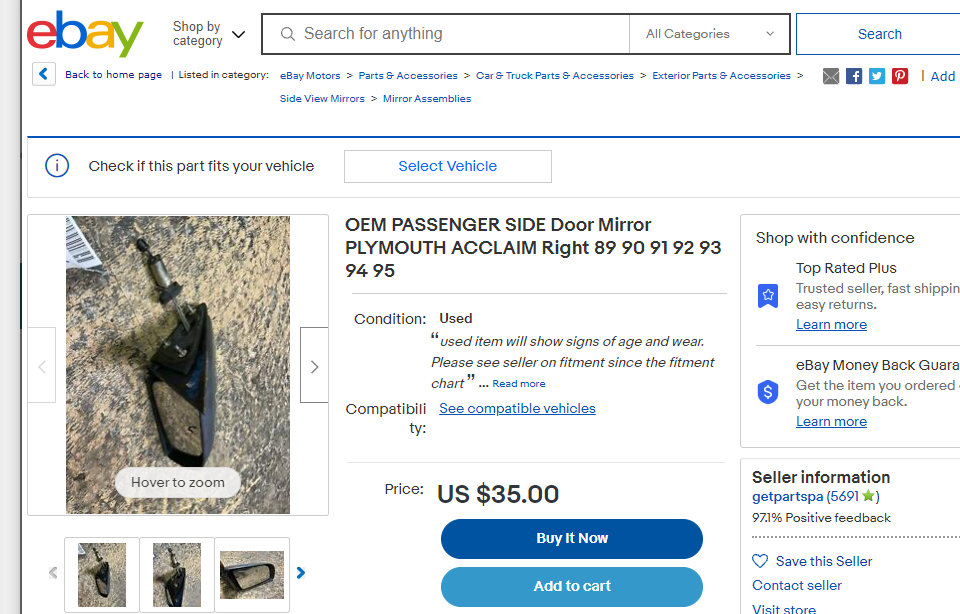

There are a ton of options out there. Just do a Google search and you should pull one up. I found this one on Ebay for a pretty good price.
See the picture below. Thanks for the update.
