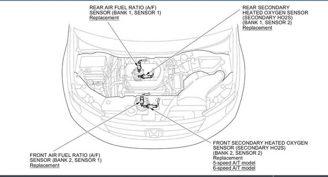

1. I was thinking there were four oxygen sensors, two for each bank plus two Air/Fuel Mixture Sensors. That incorrect, right?

First, you are correct. There are four of them. If you look at pic 1, it shows their locations. However, the code, P0430 deals with a catalytic converter not an o2 sensor.

Regarding the number of sensors, I see the four in the picture. For some reason, I thought there were two more underneath and downstream.

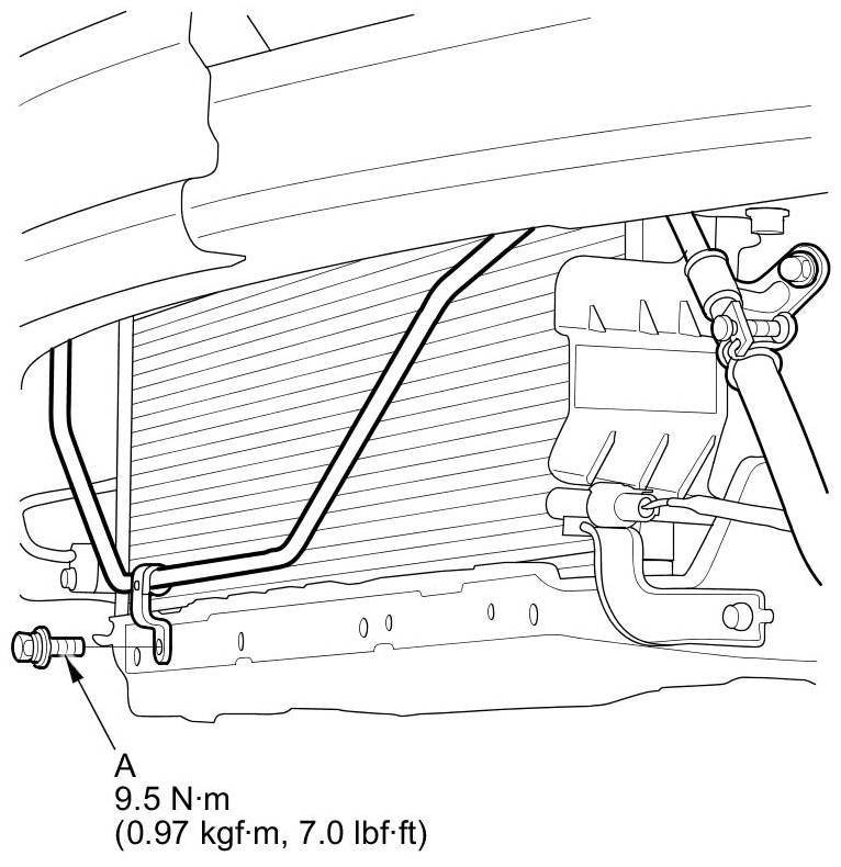

6. Remove the mounting bolt (A) for the P/S cooler line.

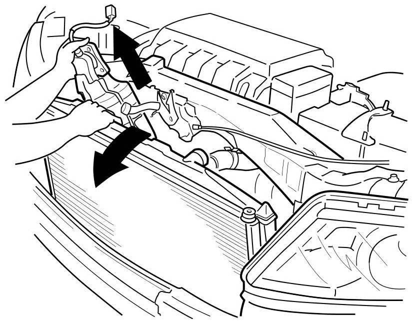

pic
7. Remove the A/C condenser fan shroud assembly.
8. Loosen the radiator drain plug, and drain about 1 liter (1.05 quarts) of coolant from the radiator.

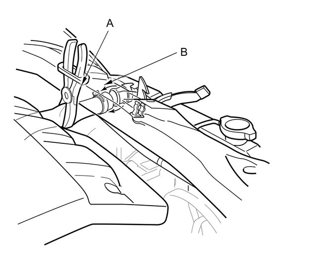

9. Pinch the top radiator hose (A) with hose pinching Pliers. Release the top clamp (B) and remove the top hose from the radiator.
NOTE: Careful not damage the hose.
pic 2
10. Place an appropriate sized piece of cardboard over the A/C condenser fan area of the radiator to protect the radiator.

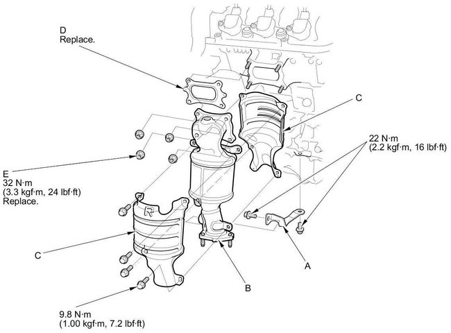

11. Remove the front WU-TWC bracket (A), the front WU-TWC mounting bolts and self-locking nuts (B), then remove the covers (C).
pic 3
12. Gently pull the radiator away from the front bulkhead and carefully remove the front WU-TWC.
pic 4

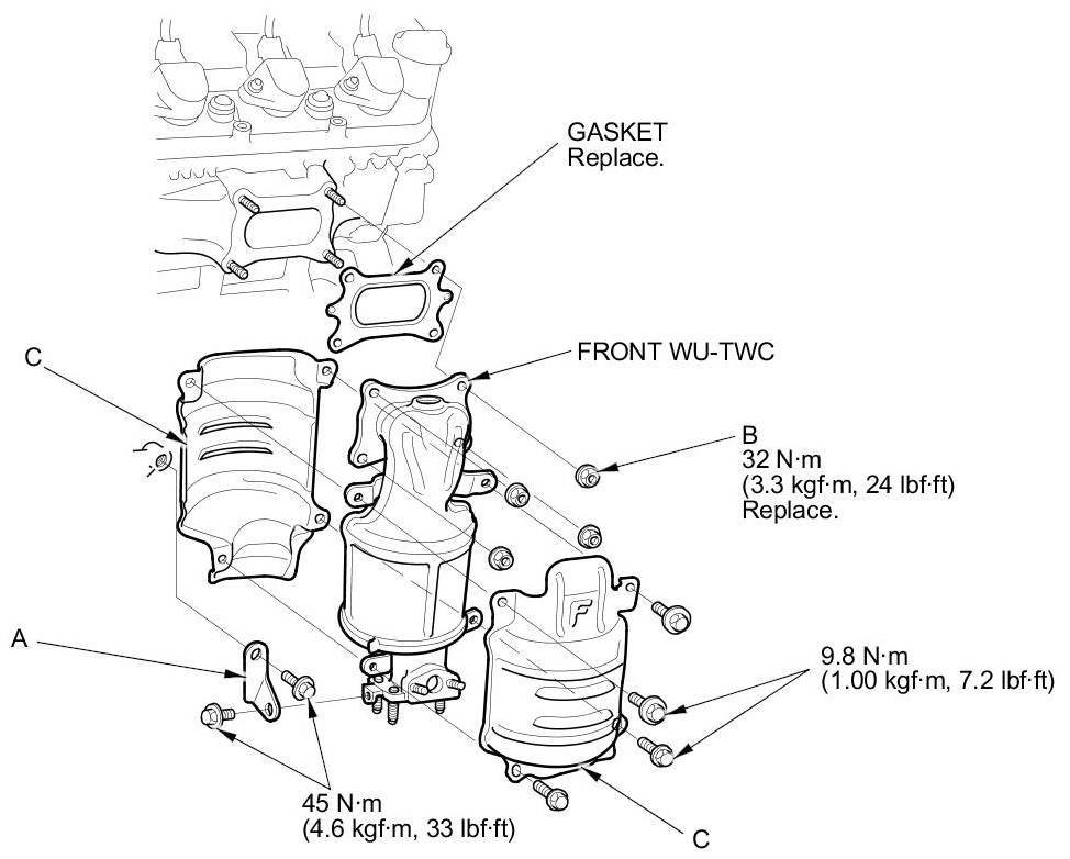

4. Remove the rear WU-TWC bracket (A), carefully remove the rear WU-TWC (B), then remove the covers (C).
pic 5
5. Carefully install the rear WU-TWC with a new gasket (D) and new self-locking nuts (E). Tighten the nuts in a crisscross pattern in two or three steps.
