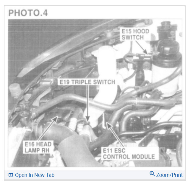

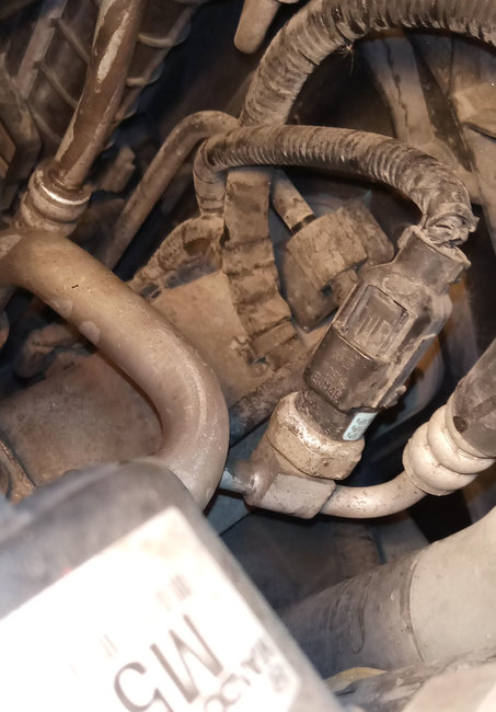

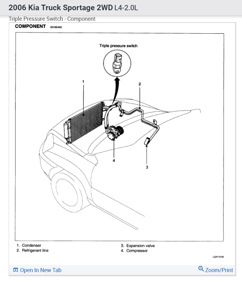

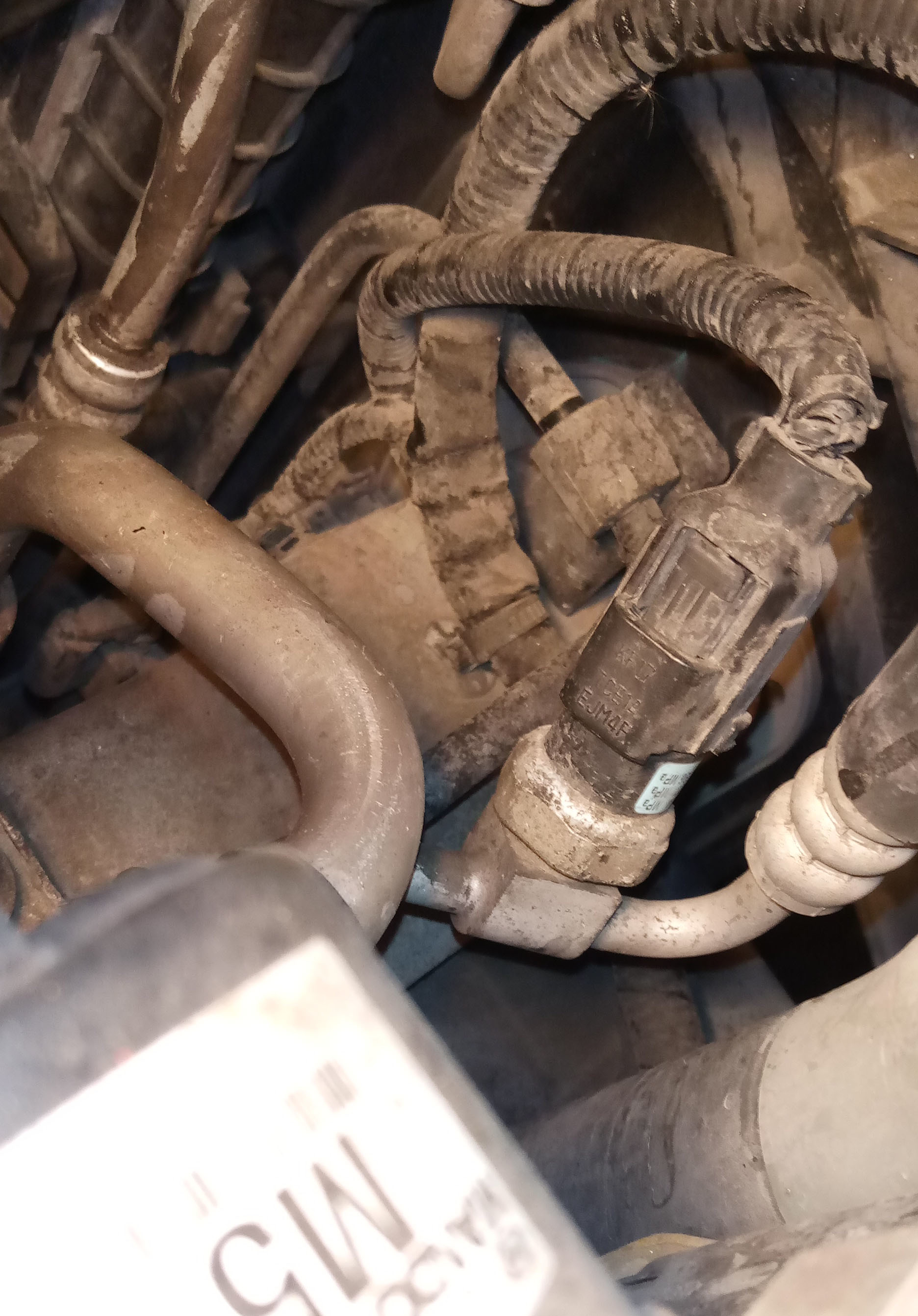

Does my vehicle have a Schrader valve under the pressure switch? I want to replace mine because I think it may be faulty. I read online where draining system was not necessary if you have a Schrader valve and cannot find out if mine has this.
May 9, 2022 at 2:47 AM
  • 55,433 POSTS
This sensor does not have a valve under it. Please vacuum down and recharge the system once the sensor has been replaced. This video will help show you how with directions below to show you how:
https://youtu.be/4EqdrBVb0sY
May 9, 2022 at 1:07 PM
