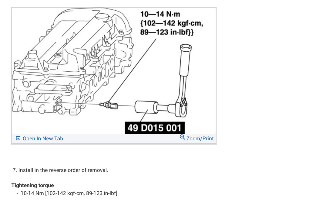

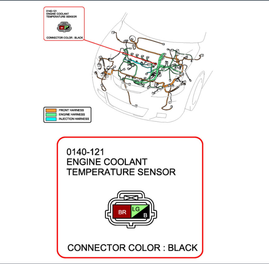

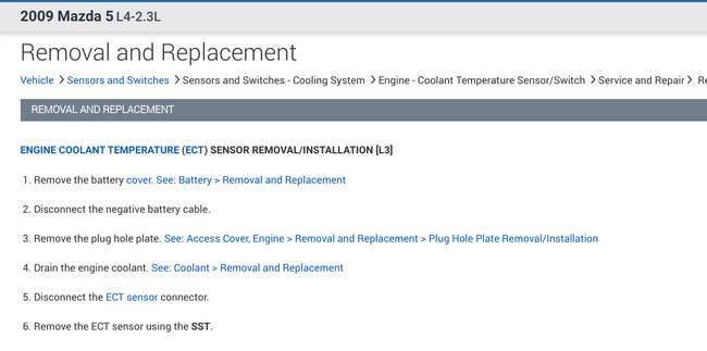

I am trying to replace my coolant temperature sensor that has gone bad in my car, but can't seem to find it's physical location.
Dec 29, 2019 at 3:36 AM
SCGRANTURISMO
  • 4,897 POSTS

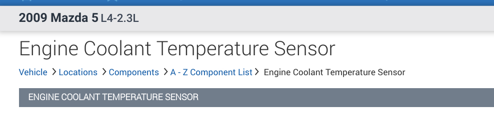

In the diagrams down below I have included the location and the instructions for the removal and installation from the vehicle manufacturer for the Engine Coolant Temperature Sensor/Switch for your vehicle. Please go through this information and get back to us with how everything turns out. Happy Holidays.
