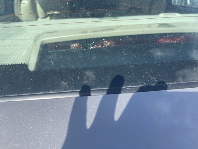

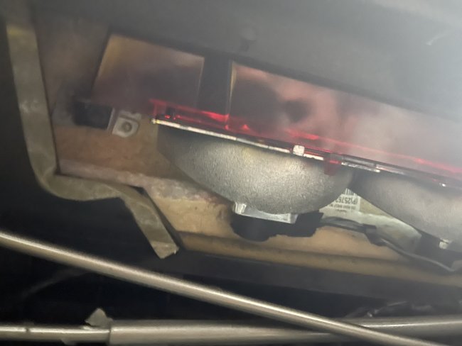

Replacing third brake light assembly?
2004 BUICK LESABRE
198,000 MILES • V6 • 2WD • AUTOMATIC
BHAMDOC1973
  • 2,007 POSTS
It burned so i need to replace the assembly. Any ideas?
Sep 30, 2022 at 12:55 AM
  • 55,433 POSTS
Yep, lift the trunk lid and remove the high mount brake light lens housing mounting screws and the unit will lift out from the inside. Let us know what happens and please upload pictures or videos of the problem.

Done, thanks.
