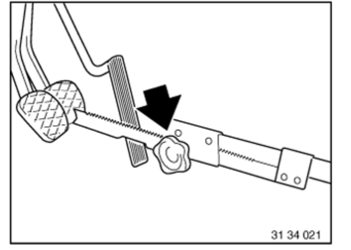

Press brake pedal down to floor and secure with pedal support.
Note:
The pedal support may only be released when the brake lines are reconnected.
This prevents brake fluid from emerging from the expansion tank and air from entering the system when the brake lines are opened.

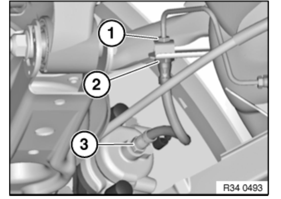

If necessary, pull brake hose out of holder (1).
Important!
Grip brake hose at square head (3) to prevent connecting piece from turning in retaining bracket.
Disconnect brake hose from brake line (2).
Installation note:
Tightening torque:
34 32 1AZ Type Thread Tightening specification Measure
1AZ
Brake line screws /
union screws
E81, E82, E87, E88, E90, E91, E92, E93, M3, E84 M12 x 1 12 Nm
M3
Blue union screw connection in steel e.g. brake hose
17 Nm
Detach brake hose from brake caliper (4).

Important!
Never twist brake hose when installing it and avoid all contact with parts attached rigidly to the body.
Note:
First tighten brake hose on brake caliper.
Move wheels into straight-ahead position.
Insert brake hose in bracket and screw onto brake pipe.

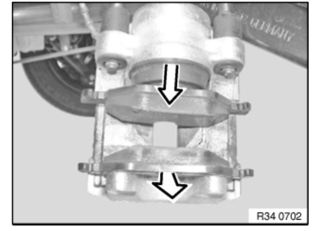

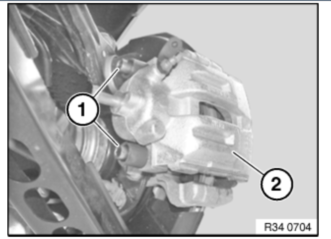

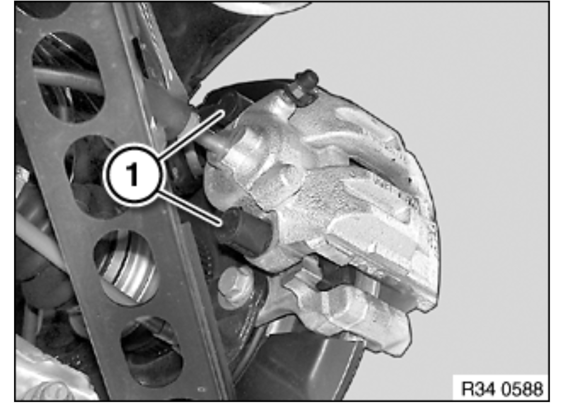

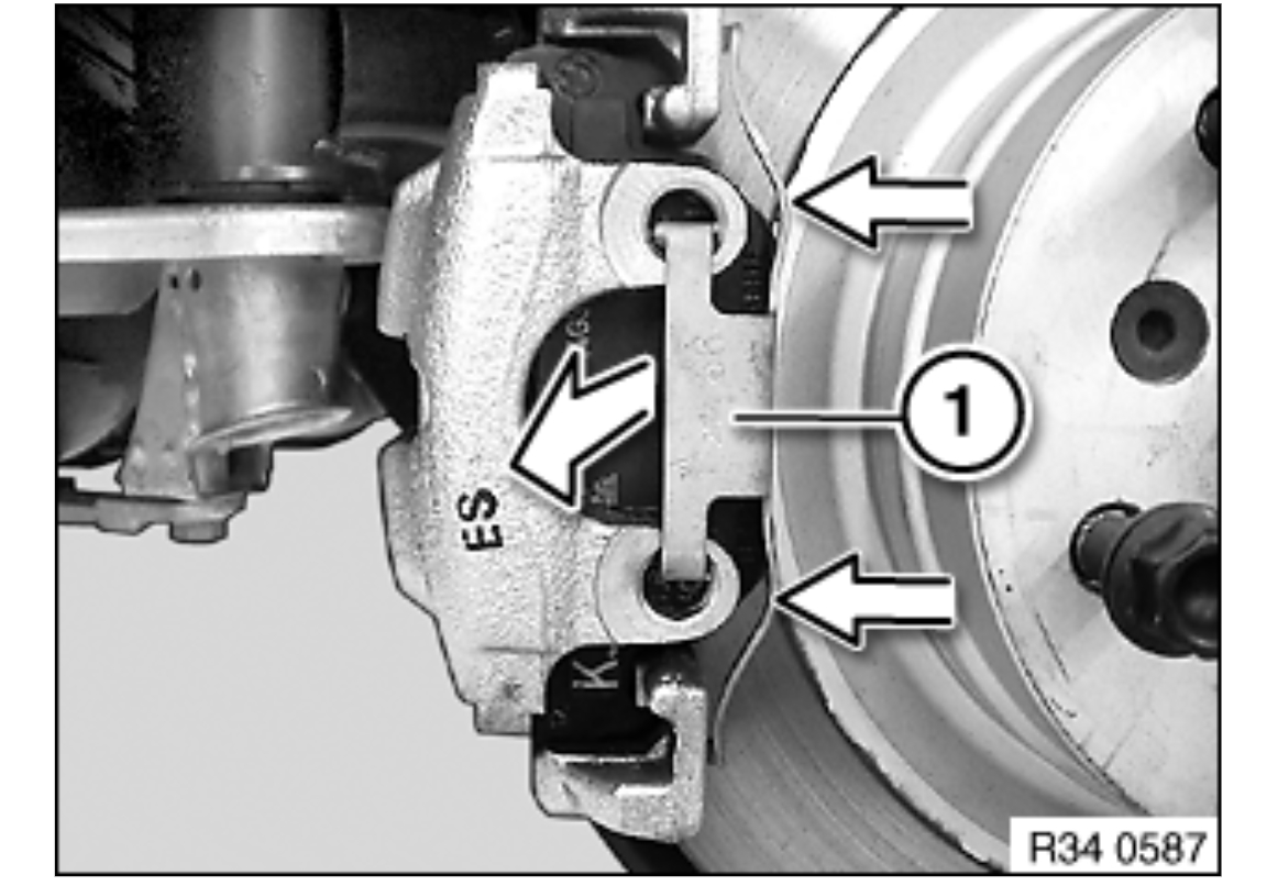

Unscrew guide bolts (1).
Remove brake caliper by pulling upwards.
Installation note:
Clean guide screws only; do not grease.
Check threads.
Replace all guide screws which are not in perfect condition.
Tightening torque:
34 11 4AZ Type Thread Tightening specifications Value
4AZ
Guide screw (socket head cap screw)
E81, E82, E87, E88, E90, E91, E92, E93, E84 WAF 7
Replace self-locking or microencapsulated screws
30 Nm

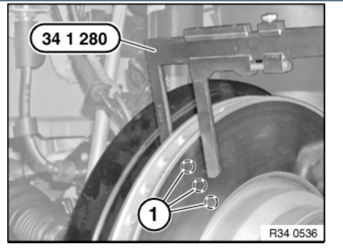

Check minimum brake disc thickness:
Position special tool 34 1 280 at three measuring points in area (1) and measure.
Compare measuring result and lowest value with setpoint value.
If the brake discs are replaced, you must also fit new brake pads.
Brake discs may only be replaced in pairs (on each axle).
Important!
New brake pads may only be fitted if the brake disc thickness is greater than the minimum brake disc thickness (MIN TH).

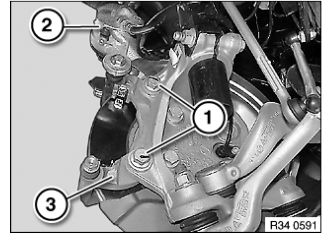

Release screws (1), remove brake caliper (2) with brake anchor plate (3) and tie back.
Installation note:
Tightening torque:
34 11 2AZ Type Thread Tightening specifications Value
2AZ
Brake anchor plate to swivel bearing
E81, E82, E87, E88, E90, E91, E92, E93, E84 M12x1.5
110 Nm

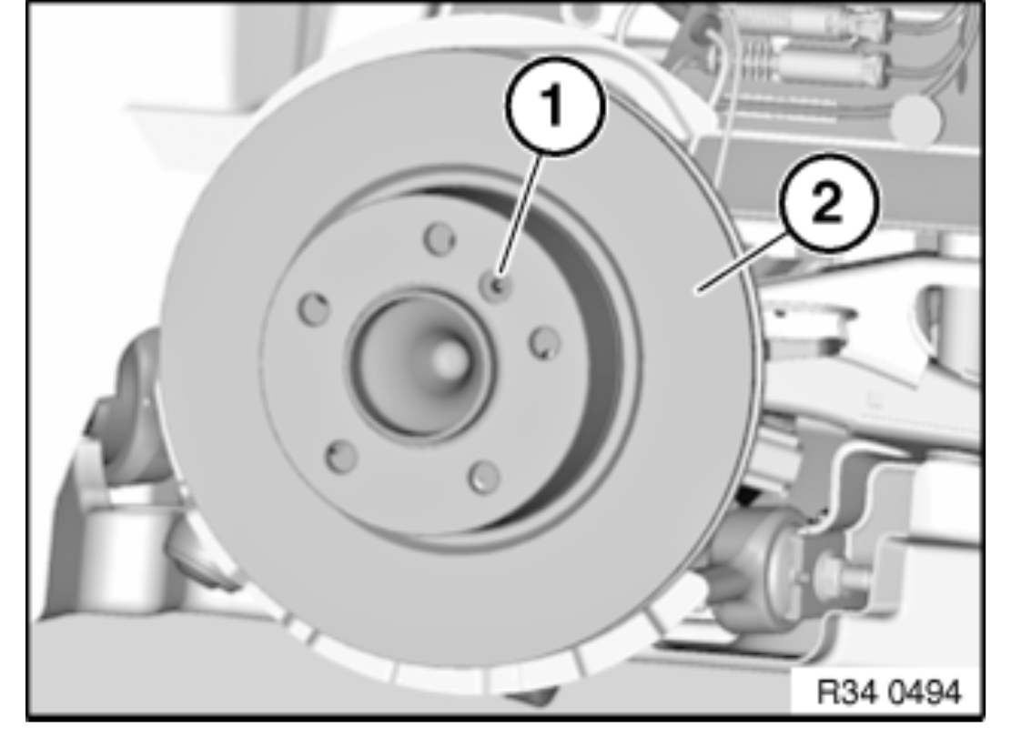

image Important!
To release brake disc: Do not under any circumstances strike friction ring with a hammer or similar!
If necessary, carefully tap on base of brake disc chamber with a rubber mallet.
Clean contact surface of brake disc at wheel hub thoroughly and remove traces of corrosion.
Unevenness on contact surface may result in distortion of brake disc!
Release screw (1) and remove brake disc (2).
Installation note:
Replace screw.
Tightening torque:
34 11 1AZ Type Thread Tightening specifications Value
1AZ
Brake disc to wheel hub
Replace bolts
16 Nm
