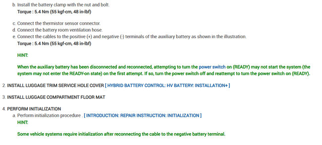

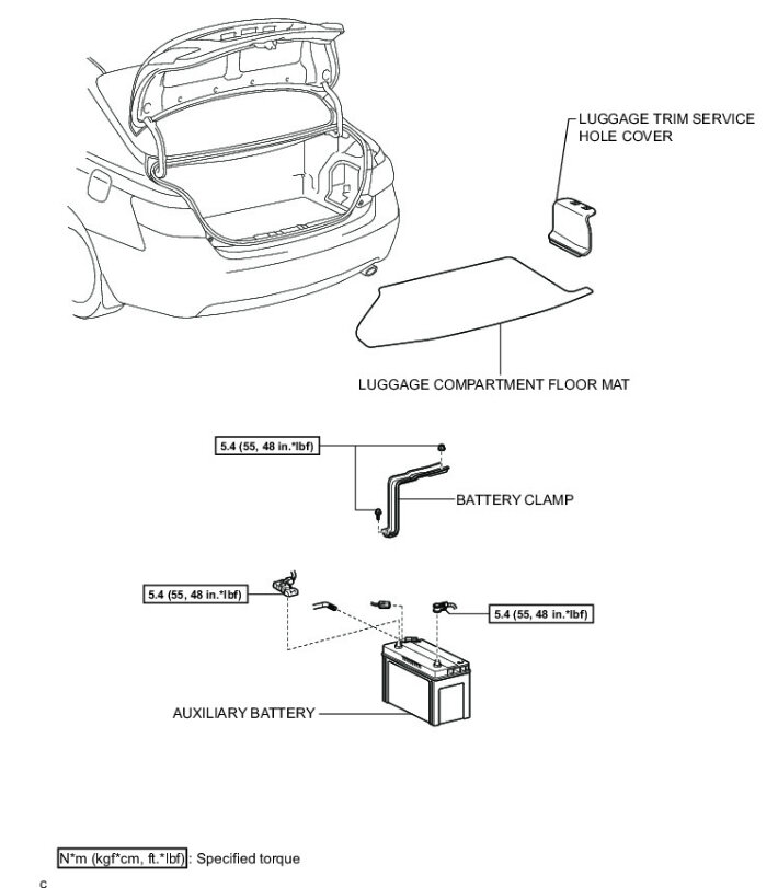

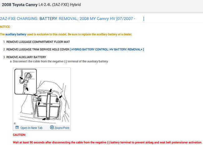

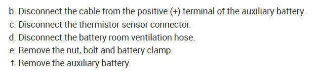

Here is the correct way to change out the battery out. Check out the images (below). Please let us know what happens.
