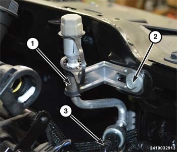

Here are the directions for removal and replacement. I will start with removal. The attached pictures correlate with these directions.
______________________________________________________________
Engine Cooling Radiator - Removal
Vehicle Engine, Cooling and Exhaust Cooling System Radiator Service and Repair Removal and Replacement Engine Cooling Radiator - Removal
ENGINE COOLING RADIATOR - REMOVAL
3.6L
1. Remove the engine cover.
2. Remove the belly pan See: Underbody Cover > Removal and Replacement > Belly Pan - Removal.
3. Drain the cooling system See: Cooling System > Procedures.
4. Remove the multipurpose bracket See: Frame > Removal and Replacement > Multipurpose Bracket - Removal.

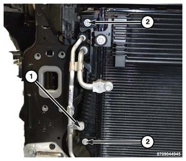

Picture 1
5. Remove the transmission oil cooler bracket bolt (1).
6. Remove the left side condenser mounting bracket bolts (2) from the radiator.

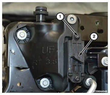

Picture 2
7. Remove the right side condenser mounting bracket bolts (2) from the radiator.
8. Remove the liquid line support bracket fastener (1) from the radiator.

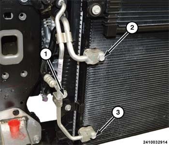

Picture 3
9. Remove the bolt (2) from the A/C service port support bracket (1) and position aside.
10. Disconnect the cooling fan wire harness connector.
11. Disconnect the upper radiator hose from the radiator.
12. Disconnect the lower radiator hose from the radiator.

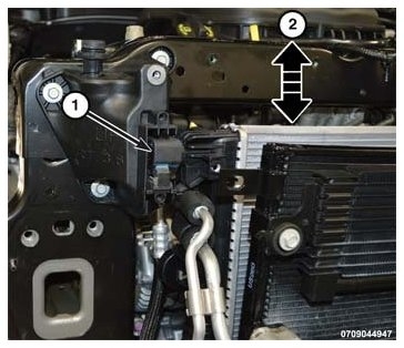

Picture 4
13. Remove the upper radiator mount cover (2) fasteners (1) from both sides of the upper radiator mounts.

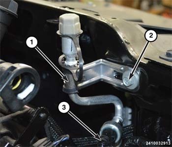

Picture 5
14. Separate the condenser from the radiator and position slightly forward.
15. Tilt the radiator forward (1), removing the radiator from the upper mounts.
16. Lift the radiator and cooling fan assembly upward (2) removing it from the vehicle.
17. Remove the two mounting fasteners from the cooling fan assembly.
18. Slide the cooling fan assembly upward from the mounting brackets and separate it from the radiator.

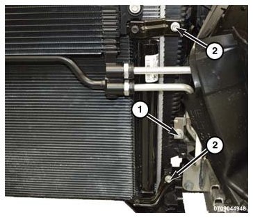

Picture 6
2. Position the radiator (2) into the lower mounting isolators on the radiator lower support.
3. Push the radiator rearward, engaging the radiator (1) into the upper mount.

Next, I attached two pictures of the AC condenser. Tell me if any of the hoses in the pictures was disconnected or damaged.
