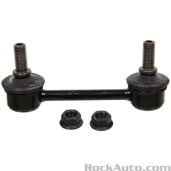

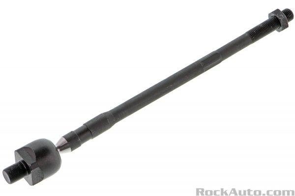

I had inspection at Nissan. I must replace inner tie rods(front) and sway bar bushings and links(rear). I want to purchase the parts myself to cut down some cost considering mechanics are not cheap. What are all the parts I will need to purchase for mechanic to do replacement?

Also be aware that inner tie rod ends are commonly not available through the new-car dealer's parts department. To insure the quality of the repair, manufacturers often only supply complete assemblies. That's because much of their repairs are for cars still in warranty, and whatever is being repaired must end up in "as-new" condition. That's not the concern with your car, but it means the parts department is going to order inner tie rod ends from a local auto parts store.
Anti-sway bar bushings and links most commonly come as complete kits, with enough parts to do both sides. When a link wears out on one side, the other one is just as old and worn, so it doesn't make sense to replace just one, then do the whole job over again later on the other side. Replacing one link by itself is more difficult than replacing both because of how the bar is held in place and won't move out of the way to improve access. One link can usually be replaced in a half hour, and both can be replaced in less time than that.
If a complete kit is not available, the person at the counter will know what it takes to do the repair, and he will find the links and the bushings. The more common designs are basically a long bolt and nut, but your car uses a different style that is much more prone to wearing out. You'll get a link with a swiveling ball and stud on each end. You should get two nuts with each one too. These can be difficult to remove, so most people use a torch to cut them off. That destroys the old nuts, but it saves a lot of time. The first photo shows what you'll need for one side of your car. The second one shows what the inner tie rod end looks like. You'll need two if both of yours are worn. There's one on each side.
