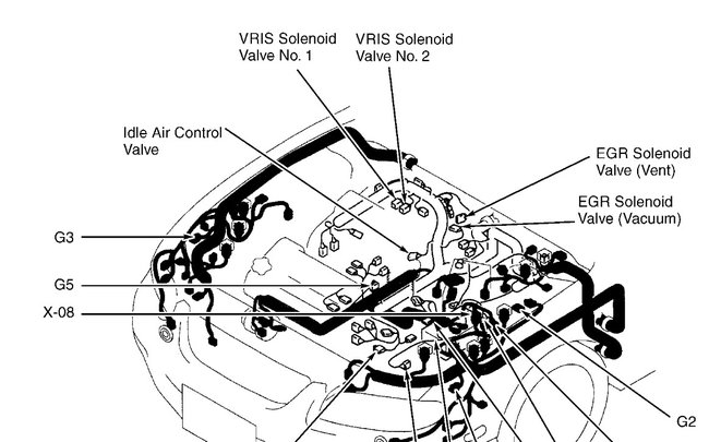

Code P1522 Replacement Part
2001 MAZDA MILLENIA
150,000 MILES • 2.5L • V6 • AUTOMATIC
ATLVIADMV
with Code P1522 I know that the solenoid valve needs to be replaced, but not sure which part I should purchase. The Dealership is no help, 'the code does not make sense' to them.
How would I go about determining the correct part number, so that I can have it replaced/fixed?
Thank You.

we only have a listing on what goes wrong not part numbers. the VRIS solenoid #2 may be the same as 1 just in a different slot check with auto parts. see picture for location as well as cause of problem because replacing solenoid may not fix it. a scanner will have to be used to erase the code after repair.
