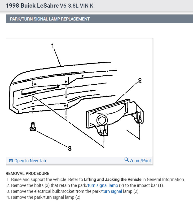

Is there any way to remove a turn signal bulb (1157) without removal of the taillight lens assembly?
1998 BUICK LESABRE
285,000 MILES • 3.8L • 6 CYL • 4WD • AUTOMATIC
ALPHAA10
  • 234 POSTS
The taillight on the car listed above is a unified assembly fastened to the trunk lid, not the car body. Metal nuts fasten the assembly housing to the trunk lid and are secured from the back side/interior of the lid.
On other vehicles, marker and navigation bulb replacement was simpler.

Yep, this is a tough one if you could upload images of what you are working on, I can help walk you through the repair. They show almost nothing in AllData and Mitchell 1 if you can believe that one.
Here is a generic guide to help:
https://www.2carpros.com/articles/turn-signal-bulb-replacement

No problem, yet Ken. However, I wanted to bypass the removal of the entire unified taillight lens assembly, simply to replace a single bulb. (What were the designers thinking?)

Right, sometimes these designs are pretty bad when it comes to servicing them. its only nuts and bolts lol. get started :) please upload pics if you can.
