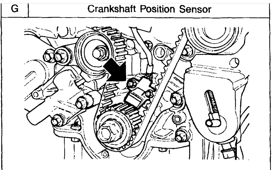

Replacement of ignition distributor engine, where is it located?
2005 HYUNDAI XG350
177,000 MILES
GINGER HOWELL
Need location of ignition distributor engine speed input circuit.
Feb 7, 2024 at 6:35 AM
  • 110,240 POSTS
This vehicle doesn't have a distributor for the ignition system. When you say engine speed, that leads me to think you are referring to the crankshaft position sensor. If that is correct, I attached the directions below for replacing it. If that isn't correct, let me know.
Note: to access the sensor, the timing belt cover will need to be removed.
See pic below.
