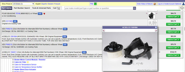

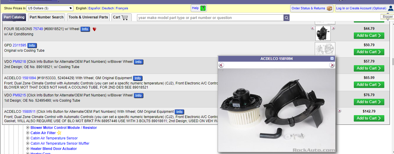

I've removed the original blower motor assembly in my car which is one assembly and the replacement blower assembly consists of a mounting plate and blower motor (two pieces). I'm unable to get the mounting plate into the HVAC box because of the proximity and angle of the floor. Can the HVAC box be loosened so as to allow slight movement (in turn allow the mounting plate to be installed into the HVAC box) without removing the dash first?

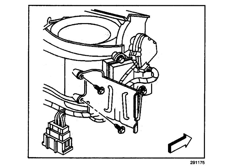

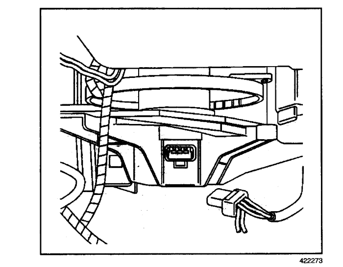

Good morning,
I posted the procedure below for you to view. Nothing that requires removal of the dash or the heater box.
Did you rotate it it before trying to remove? Did you peel back the carpet as well?
REMOVAL PROCEDURE
1. Remove the right side sound insulator.
2. Pull back the carpet near the blower motor.
3. Remove the IP compartment.
4. Remove the Dash Integration Module (DIM) from the bracket.
5. Remove the two rear DIM bracket screws.
6. Reposition the DIM bracket to allow for removal of the blower motor.

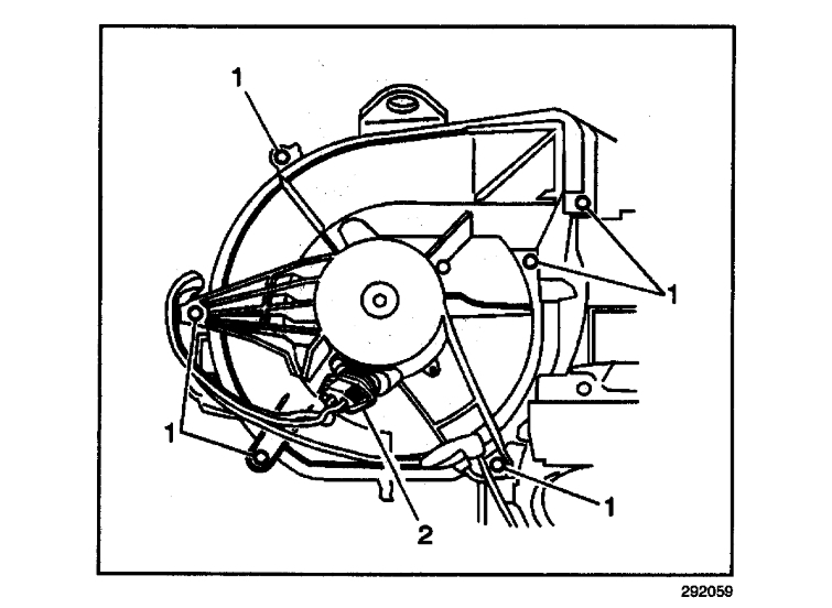

7. Disconnect the electrical connector (2) from the blower motor.
8. Remove the blower motor retaining screws (1).
9. Lower the blower motor and rotate counterclockwise to remove from the vehicle.

1. Install the blower motor. Blower motor will need to be rotated to install into the housing.
NOTE: Refer to Fastener Notice in Service Precautions.
2. Install the blower motor retaining screws (1).
Tighten
Tighten the screw to 1.4 N.m (12 lb in).
3. Connect the electrical connector (2) to the blower motor.
