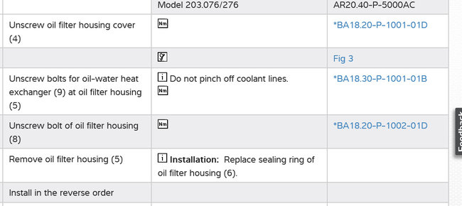

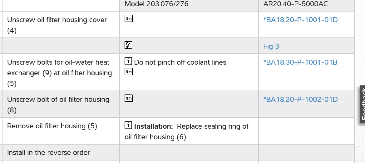

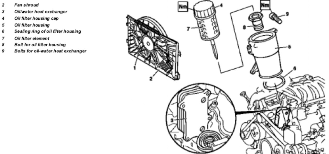

I need a replacement for the oil filter housing. I cannot find any videos or pictures. Can you please help? Thanks, John V.
Wednesday, April 13th, 2016 AT 6:54 AM
HMAC300
MECHANIC
48,601 POSTS
See pictures this is generic as there are several different models this covers. Oil filter nut 25 Nm bolt holding housing 70Nm.
