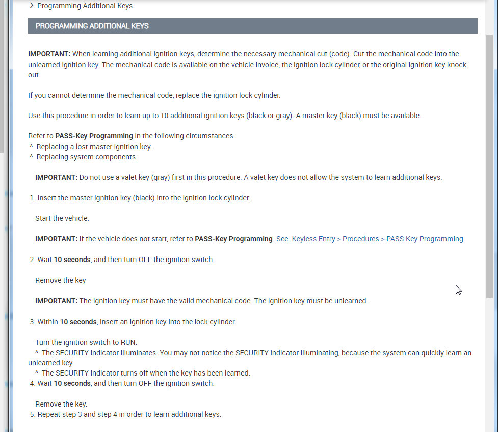

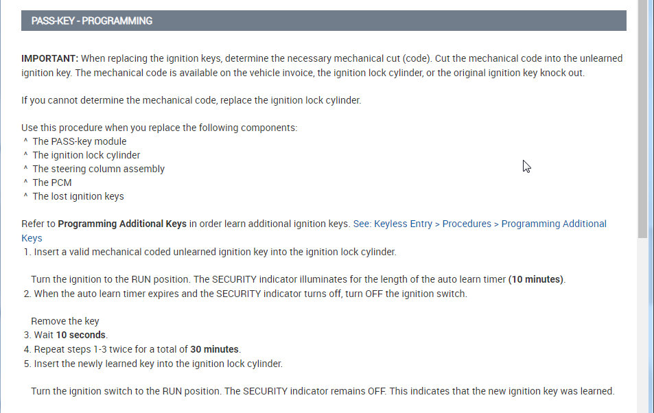

How to program a replacement master key?
Wednesday, November 25th, 2020 AT 1:52 PM
MECHANIC
18,907 POSTS
I am attaching the process for the PASS key and the process for an additional key.
Let us know if you need other info. Check out the diagrams (Below). Please let us know if you need anything else to get the problem fixed. Thanks
