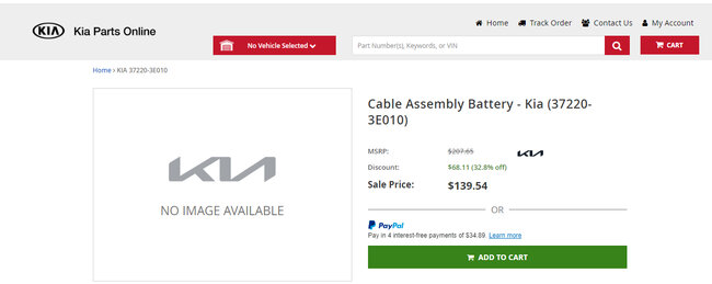

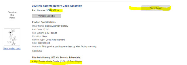

I found one at Kia parts online. See pic 1 below. I know these have been discontinued, but they still have them. Here is the URL that I used. Click on this and it will take you to the site.
https://www.kiapartsonline.com/oem-parts/kia-cable-assembly-battery-372203e010
Let me know if this helps.
See pic below.

I’ve contacted them and was told none are available. They order from Kia and have been discontinued.

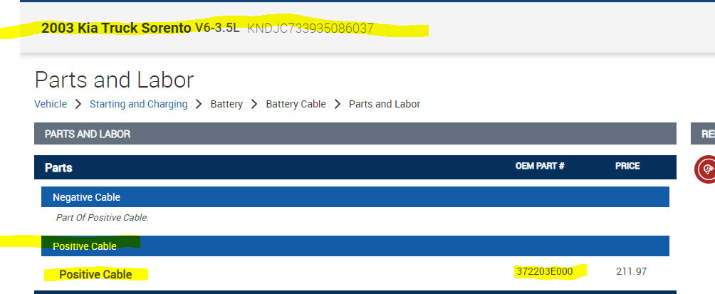

Also, if possible, send me the VIN number of the vehicle. I am trying to compare the two different part numbers you included, and they are both indicating the same type vehicle and engine size. Also, if you could let me know what was damaged on the original cable. If it was a fusible link, that should be able to be replaced/repaired.

Technically it’s a 2002 but it’s listed in the US as an 03
No. KNDJC733935086037

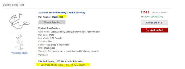

Based on the VIN number, you need the cable that is available, 372203E000. I attached the information below for you. Take a look at it and let me know if you have questions.
Note: The part number is tied directly to the VIN number. In this case, the part is still available.
See pic below.
