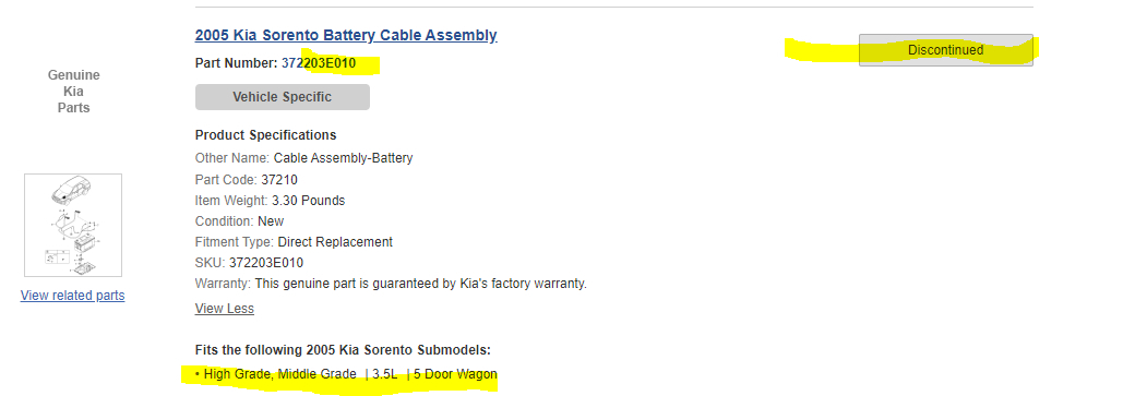

I have the vehicle listed above Lx. A local repair shop damaged my battery cable assembly at the starter connection by incorrectly probing the wires. Because of the age of the car, I am unable to find a replacement. I’ve even tried wrecking yards. The part I need is 372203E010(the cable that goes to the starter). There is another one that is identical under 372203E000 but carries a different battery voltage than mine, so it won’t work. I can’t afford another car as I am on Social Security. Also, I love my Kia and don’t want to give it up. It’s been an absolute trooper from day one. Any suggestions would be appreciated.
Sep 8, 2024 at 3:56 AM
  • 110,244 POSTS

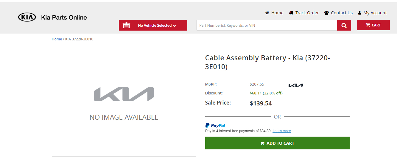

I found one at Kia parts online. See pic 1 below. I know these have been discontinued, but they still have them. Here is the URL that I used. Click on this and it will take you to the site.
https://www.kiapartsonline.com/oem-parts/kia-cable-assembly-battery-372203e010
Let me know if this helps.
See pic below.
Sep 8, 2024 at 10:20 AM
CYNLYNSMI
  • 6 POSTS
I’ve contacted them and was told none are available. They order from Kia and have been discontinued.

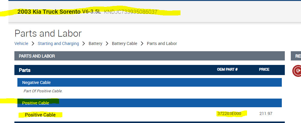

Also, if possible, send me the VIN number of the vehicle. I am trying to compare the two different part numbers you included, and they are both indicating the same type vehicle and engine size. Also, if you could let me know what was damaged on the original cable. If it was a fusible link, that should be able to be replaced/repaired.
Sep 11, 2024 at 11:14 AM
CYNLYNSMI
  • 6 POSTS
Technically it’s a 2002 but it’s listed in the US as an 03
No. KNDJC733935086037
The cable hasn’t been removed yet so I’m not sure of total damages. That probably won’t happen until Monday when I have some help.
Sep 11, 2024 at 11:29 AM
  • 110,244 POSTS

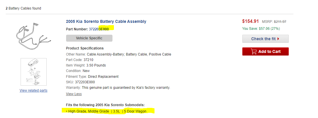

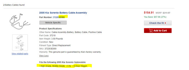

Based on the VIN number, you need the cable that is available, 372203E000. I attached the information below for you. Take a look at it and let me know if you have questions.
Note: The part number is tied directly to the VIN number. In this case, the part is still available.
See pic below.
